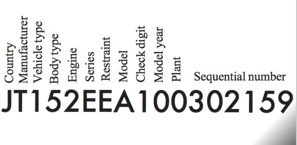

this is not VIN number
My understanding that a VIN and Frame Number are one and the same.
Frame # is as close to a VIN as you'll get for a vehicle that didn't have a VIN assigned. Using ToyoDIY to decode you'll get the same info as if you'd punched in a VIN.
