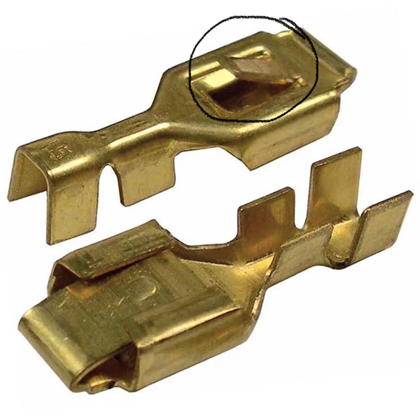

Push the terminal into the plug, use a fine tip pin (if you don’t have good tools, a Bobby pin with the tip cut off is perfect) to push in and slightly down to move downward under the terminal housing. Pull on housing.

By the way, the thin tool would go in from the front of the plug opposed to where the wire enters. Looking at the pic, the pin goes into the bottom?

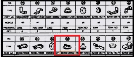

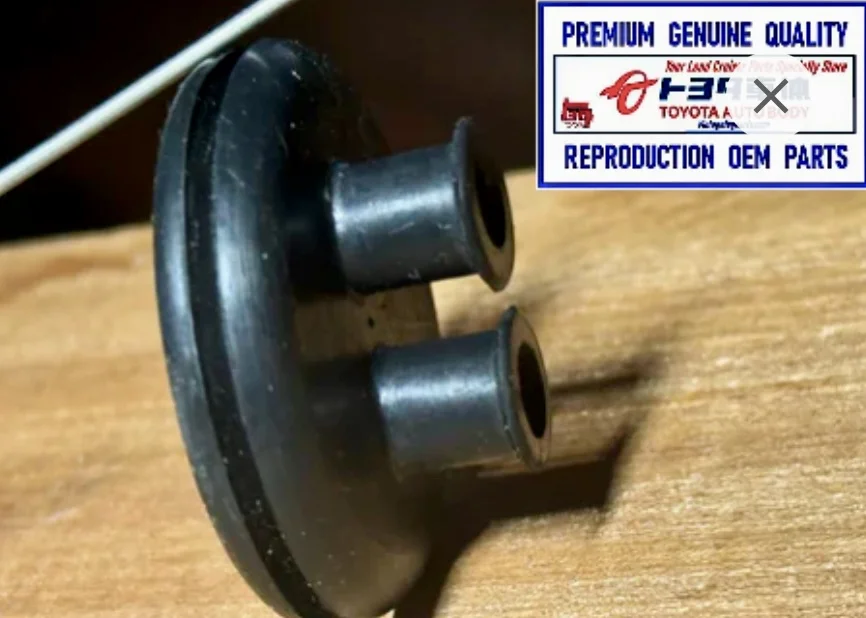

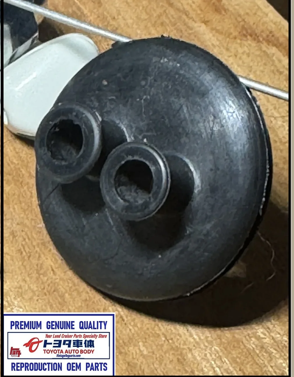

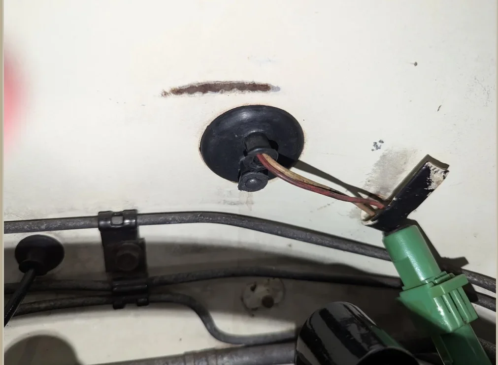

For those who are struggling with an old crusty petrified double-ports Choke Cable / Sub-Harness Grommet behind the Cylinder Head ..
My 90480-30003 Molded out very very nice and is up to the Period Correct Reproduction Part’s goodness good level ….
The ICS , both gauge sender and thermo sender wires now can exit through one of the spouts. and your CHOKE cable the other just as Mr T intended …
