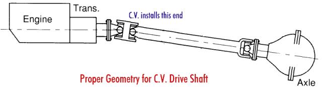

Howdy! DC shafts are designed to be run with the DC at the end of the driveshaft with the most angle. Normally that is at the transfer case. This is why a lot of rigs do a cut n turn on the diff. It allows the singe ujoint at the diff to be within 1 0r 2 degrees of straight, and then the majority of the angle is run at the DC. It MAY be possible, but I don't know of anyone having any luck trying to do it the other way around. John

NO. no cv on bottom. The only time that is done is on HUGE lifted jamboree trucks that will never see woods/trail duty but need to avoid the "no front shaft" jokes. Thats the only reason to install a CV on the bottom.
A cv is used at the top in proper form.
A cv is only used if the lower joint has NO or close to no angle on it.
Is your front axle cut and turned and pointed STRAIGHT at the tcase?
or
Does it have some angle to it?
If the top joints angle and the bottom joints angle are the same or very simular then use a NON CV shaft.
95 percent of toyota owners improperly use a CV front shaft when a nonCV shaft would benifit them more.
Hope this helps. here.

Its cut and turned to 11 deg at the pinion flange and I had set the motor @ 2 deg with the back down, so it will be out of phase. I think a CV is appropriate.
