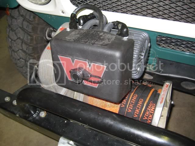

My 8274 that I rebuilt a year ago, including the new motor quoted above, started to only work intermittently and then finally wouldn't work at all. I replaced the entire solenoid pack, since the motor was new. The power cables are also new and of sufficient gauge (2 IIRC?). The new solenoid pack did not fix it! So, by process of elimination, it had to be the motor. I finally took the motor apart and found this:
The copper had either burned or worn off of the armature! The motor was out of warranty, and I didn't really want another one anyway that might strand me some time, so I bought a new 6hp Warn motor for the 9.5XP winch and a splined drive gear for a late 8274, using the part numbers gleaned from here on Mud.
The 9.5XP motor is longer and heavier than the stock Prestolite or the replacement DB Electrical motor, a good sign I guess. It bolted right up though, the shaft went through my existing year-old bearing, and the new splined gear went right on no problem. This motor also has a dedicated large ground lug in the middle of the motor housing (unlike either of the previous motors) so you don't have to pull the through-bolts out of the motor to attach grounds on the end of the motor.
Even though the motor is longer, there are cooling fins on the end opposite the gear case, which leaves less room than before to mount the solenoid pack. In fact, I had to trim the solenoid box metal mount on that end, so that the solenoid box would fit between the upper gear housing on the 8274 and the cooling fins on the new motor. Other than that, it went on without any more mods necessary. Plugged in my controller, and everything works great, in and out. I believe I will be happy with this motor and winch now.

The first time it stopped working was in the middle of a recovery situation way in the back country (Dark Canyon area) of southern Utah. Fortunately, the other trucks with me all had winches too. Then it would work again, then not, intermittently until while using it at a wheeling event to pull someone's dented door out it just stopped and wouldn't reel in or out no matter what. Now I believe what was happening was, as the copper wore off the motor armature, the brushes could not transfer current to it. If the motor just happened to stop rotating on a place where there was no copper, then it wouldn't start again. If I rotated the drum with the clutch engaged (thus rotating the gears and motor too) then I could get the motor armature turned to where there still some copper left and it would run again - until so much copper wore off that it couldn't make contact with the brushes no matter what.
The 6hp 9.5XP motor was $300 from warnserviceparts.com (Redding Four-wheel Drive). Worth it for my peace of mind.
