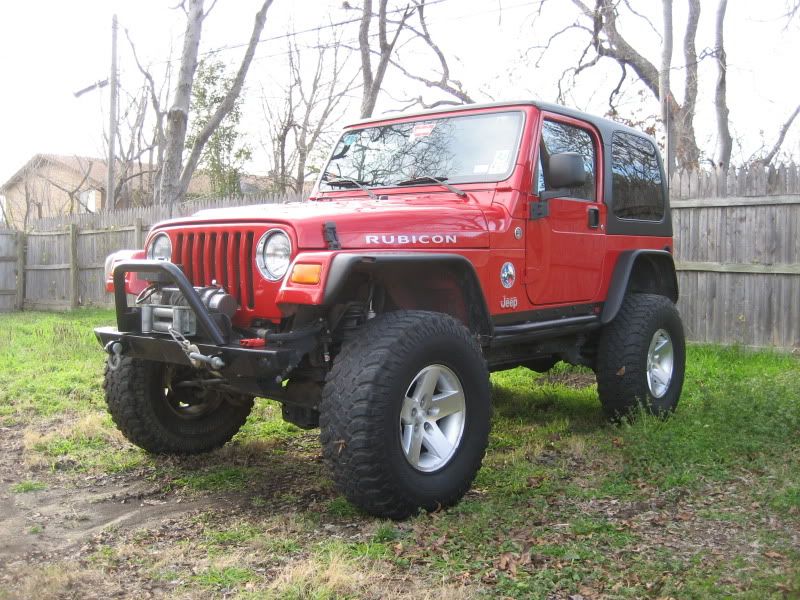

This build is probably going to be slow going but thought I'd (re) introduce myself. I'm not new to the ih8mud forums, I documented my M-416 build a few years ago on this site.
M-416:
http://i64.photobucket.com/albums/h195/dawsonc61/jim parker 2010/IMG_7785.jpg

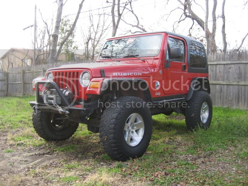

Jeep:
http://i64.photobucket.com/albums/h195/dawsonc61/IMG_4678.jpg

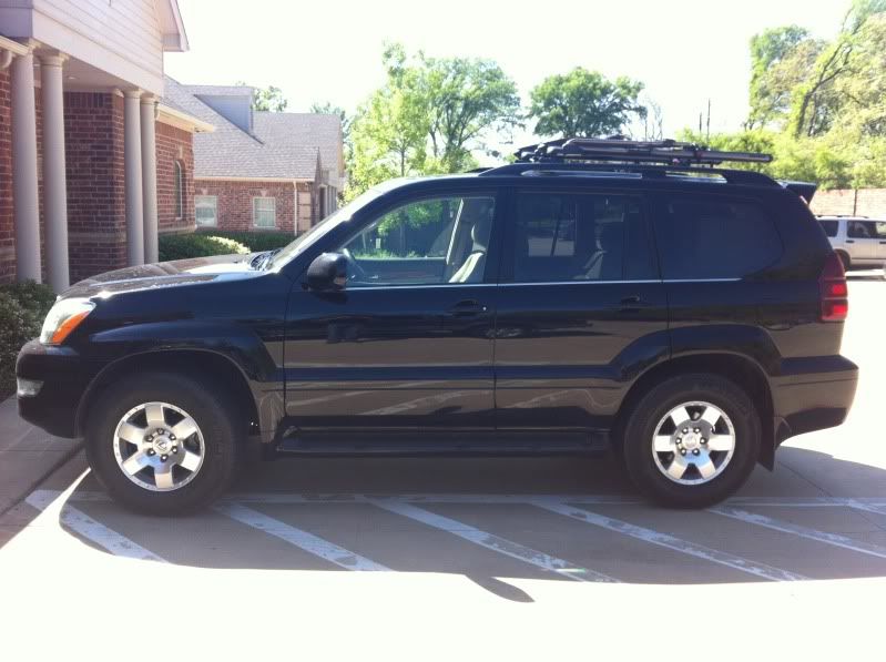

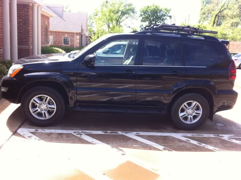

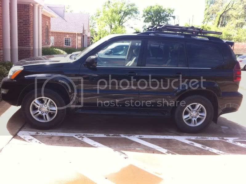

Since then I've sold my jeep along with the 416 and bought a 2006 GX470 (non-kdss). So far the mods have been minor: Ipod integrated into the audio system, Yakima bike racks, and FJ Cruiser wheels...
Before:
http://i64.photobucket.com/albums/h195/dawsonc61/IMG_0480.jpg
After:
http://i64.photobucket.com/albums/h195/dawsonc61/IMG_0481.jpg

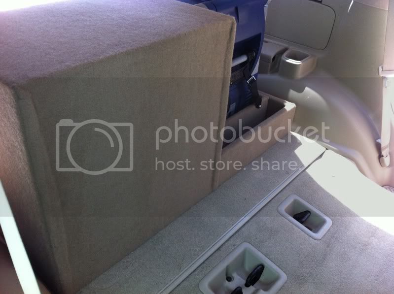

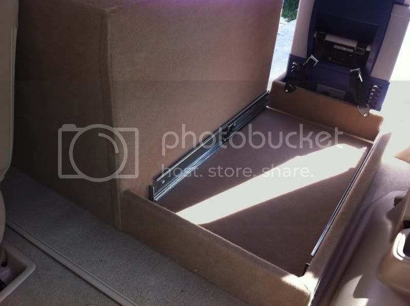

I started this project about 3 weeks ago and it's finally finished!

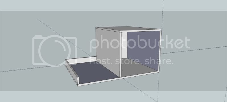

I began with a google sketch-up model to see exactly what my dimensions would be. The base ended up being 41"x32" and it fit perfectly in the back. For the fridge I went way overboard and got a set of locking 500# 28" cargo slides.

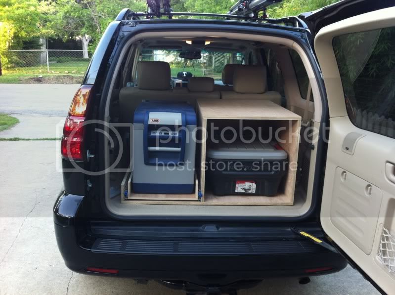

I designed it to hold either two small rubbermaid containers or one large one.
In the back of the GX with two rubbermaid containers and the ARB
I really didn't want to keep it as raw plywood so I took it over to a local upholstery shop and had them cover it with tan fabric that nearly matches the carpet. I also bought ARB fridge tie downs.

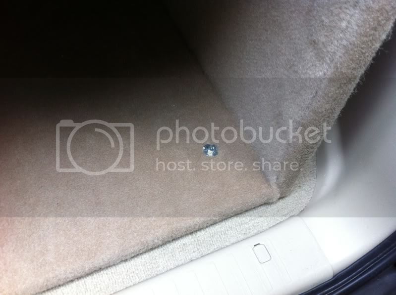

To mount it I removed the four factory tie downs and then bought some 6mmx~3" hex head bolts. The 6mm bolts fit perfectly in the factory holes so I measured and drilled accordingly, installed some tee-nuts and bolted it down.
I liked utilizing the factory tie downs because I can remove the module in about 2 minutes and put the 3rd row seats back in for those occasions where i need extra seating.
Here are a bunch of different shots of the finished module:
Do you have measurements and materials lists I could use? This is exactly what I would like to do.
Oh, check out my tricky hi-lift mount in my build thread...used the latch system on the back of the second row and it works great.
I may build the same thing...i think i would enclose the fridge though. I tend to get stuff too close to my vents on mine. I may also build mine as a metal frame to keep weight and space for the structure lower...plus i find welding to be much more fun than plywood :)
