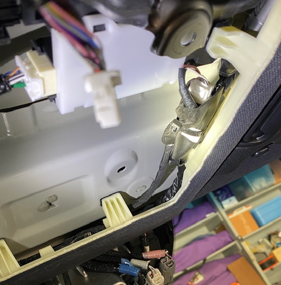

The dash cam connector was spliced in the harness shown on this pic which is behind the overhead panel. Other Toyota models use a Y connector to avoid splicing. Apparently the Y connector is not available for the LC250 yet or SE port is too cheap to use it. It uses three wires, battery, acc, and ground. I did not try to trace the hardness to see what it connected to. There are a number of connectors on the backplate secured to the windshield so there are multiple power sources there. The FE mirror is multifunction including rearview camera so there are a multitude of wires to it.
Here's the circuit for that harness:
Red: Constant 12V
Black: Switched Ignition
White w/Blk: Ground

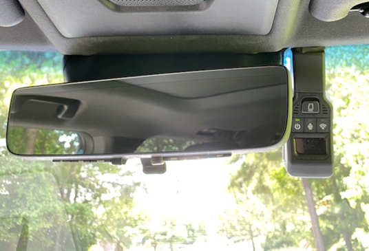

I completely removed the OEM dash cam without re-installing it on the passenger side. Here's a pic of the dash cam mounted on the driver's side. It wasn't just annoying, but an actual safety hazard. (Several times I nearly completely missed stop signs that would've resulted in disastrous outcomes.)

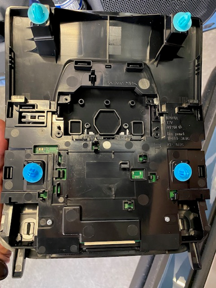

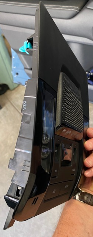

Appreciate all the info provided here. I had some decent success. Ideally it would be up about 1/4" more to hide the wires but it's tricky to push that area up and make good contact reattaching it. The trick for removing that map light panel is pulling from the front and with a spirited yank of confidence but with care not to whack the other stuff below it.
Follow along with the PDF above from Toyota. You need to give it a good yank but you also need to make sure you pull from a good spot in the front of it near the windshield and where the plastic is well supported. The images here and in that PDF give you a rough idea where the best spots to pull from are. It takes a leap of faith. I was very nervous myself since others have snapped those back clips.

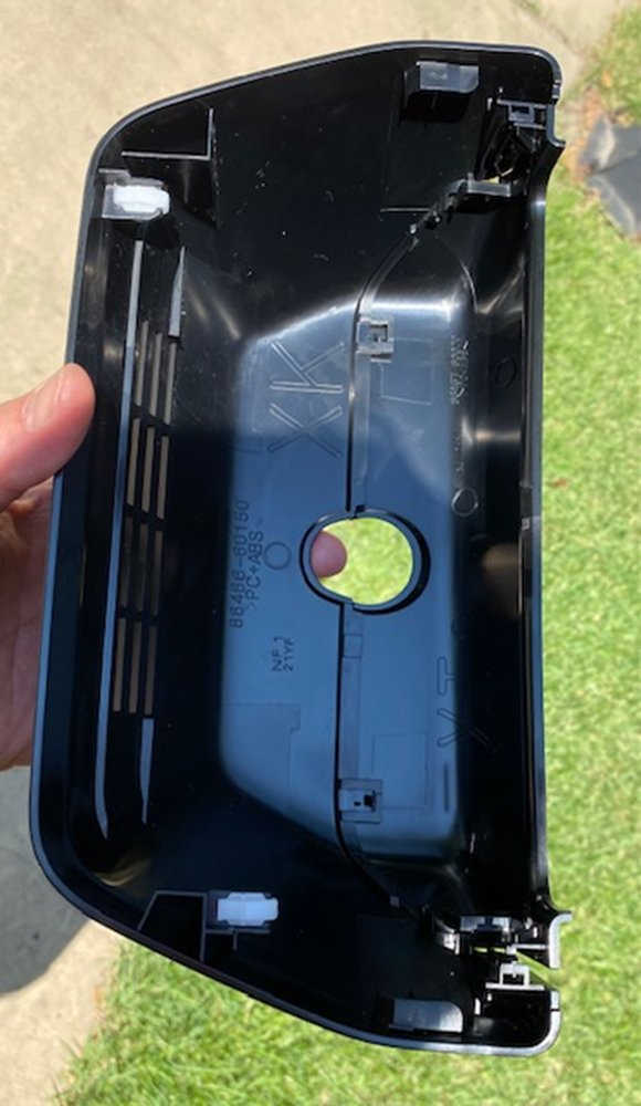

I finally got around to I stalling mine today. All went pretty smooth except the clamshell thing around the rear view mirror. Two tiny little tabs exist to help connect the two piece together. I broke one. So I guess I’ll see how much this trim piece costs. I fear the wait will be more painful than the price.
I didn’t hear it break so no idea when it happened or how to warn anyone else thinking about this install. Overall this is not a hard job. Dealing with all these interior clips just sucks. Dropping down the sunroof switch panel takes a commitment to a hard pull to get it to release. I’m sure my colder temps today didn’t help the plastic parts.
That said it seems to be 100% secure output what ever that tiny tab does.
