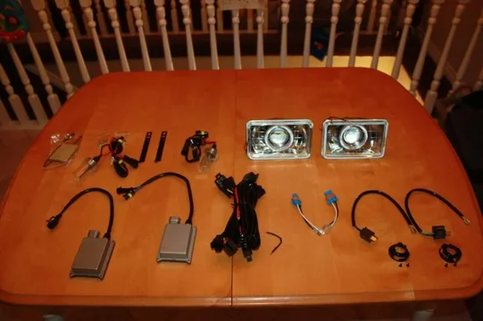

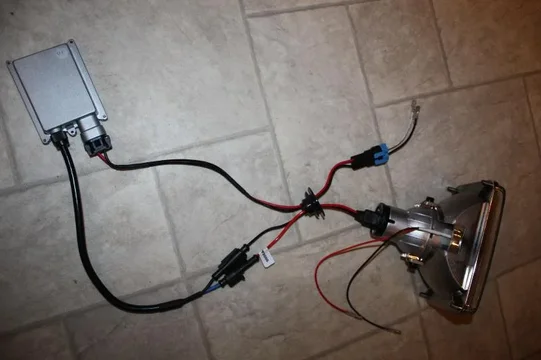

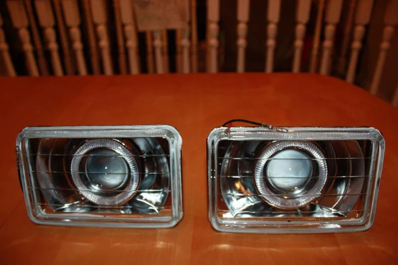

as promised here are a few pictures. the kit comes with projector housings, HID inserts and ballasts. New wiring harness included (may not need it as i already have upgraded harness as mentioned earlier) and a bunch of hardware. Instructions included too.

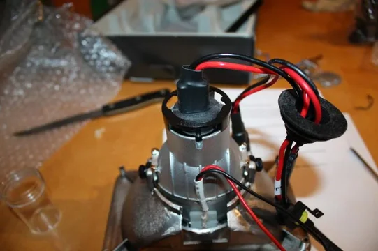

the housings are designed for H3 bulbs so there is a H4 adapter to go on.

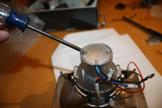

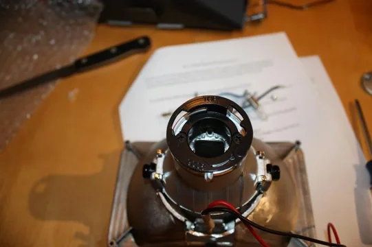

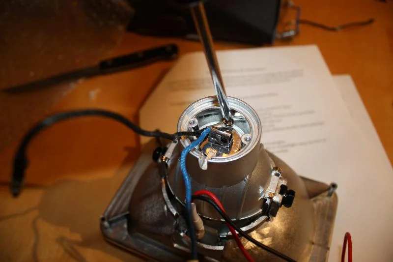

first you take the backing plate off and remove the H3 wiring harness.

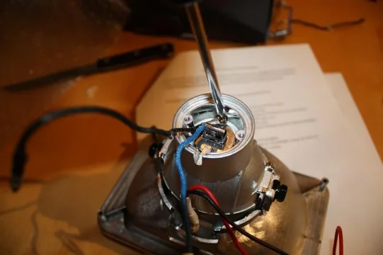

then you insert the H4 adapter and fasten it with three screws.
Install the HID H4 light and twist to lock it into place.

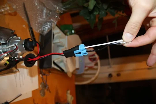

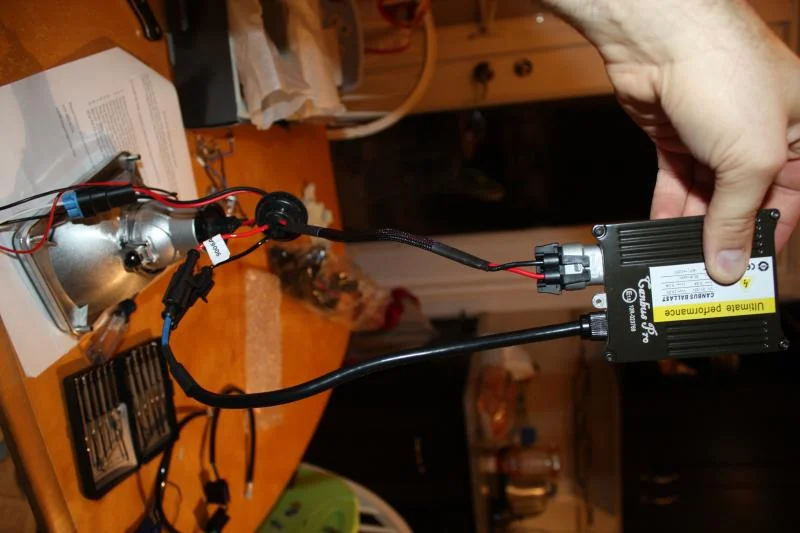

hook up the wiring as outlined by the instructions. its really self explanatory as the male and female ends only have one option each to mate to so there isnt really a way to hook them up wrong.
first the H4 wiring

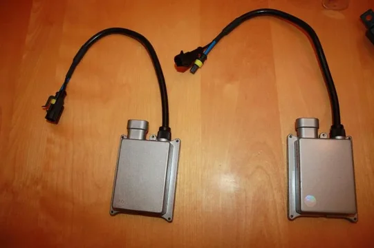

then the ballast
when all hooked up it should look like this. there are two wires coming off for the halo light that can be hooked up as day time runners.
next comes installing them into the truck. there are mounting brackets that hold the ballasts and they comes with a wiring harness and relays. you can choose between two lights or 4 lights on with high beams. i already have an upgrade IPF harness that all 4 lights come on with. i'm just having a little trouble with it right now and will hopefully sort it out tonight. if it goes well i'll get these lights installed. if not then they'll have to wait as I don't want to install them and have problems to sort out after yet another variable goes into the mix. so far i've been impressed with the quality of the parts though and am anxious to see how they perform.
