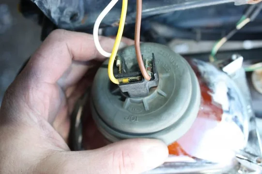

hoping to get some help here. i have an IPF wiring harness set up for my FJ62 and still have crappy low beams. i am also having a little difficulty with the high beam indicator. as i want to make sure that the harness is working right before installing the new HID system i went to test my harness at the headlight to see what kind of voltage i have. the trouble im having is knowing which wire is doing what and which ones do i test the voltage across. here is the harness that came with my hellas. can someone tell me which wire is what? thanks. IMG_4936.webp incidentally the voltage from the yellow to the white is 11.5V

btw, 11.5v suuuuuccckkkkssss....
measuring yellow to white is the wrong thing to measure I assume. I should be measuring from low to ground should I not?

so still sorting this lighting issue out and haven't gotten any further. mace if you read this would you clarify something for me? the diagram you posted about the hella wiring (brown-ground, yellow-low, white-high) I read to understand has two power wires and one ground. I assume that when highs are on white is power and when lows are on yellows are power. in toyota with switched grounds both the white and yellow should have full power but it's the ground that changes at the switch, no? by jumping the headlights I can get good power on low and high but can't seem to get the harness to supply this power at the proper time. my next question is does the ipf harness still keep the whole system working as of switched ground system or does the relay system change the lights to switched power? does this make sense?
so I finally got the bloody system working. the harness was ok after all. there were some mixed up wires through the hella harness. I had to figure out on my bulb by jumping it straight from the battery, which was power, which was low ground and which was high ground. in the above diagram from mace the brown wire is actually power not ground and the other two are then grounds (this is for a switched ground system I guess). then I had to sort out which of the wires coming from my harness matched them and wa la they worked and so does my bright indicator. I was making it way more difficult than it really needed to be. I guess it's a good lesson in electrical systems.
