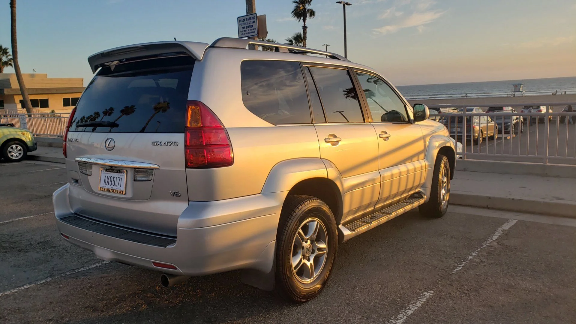

  • 2006 GX 470, Sport with Entertainment system (aka KDSS, nav) at 138k miles, one owner, full dealer service history

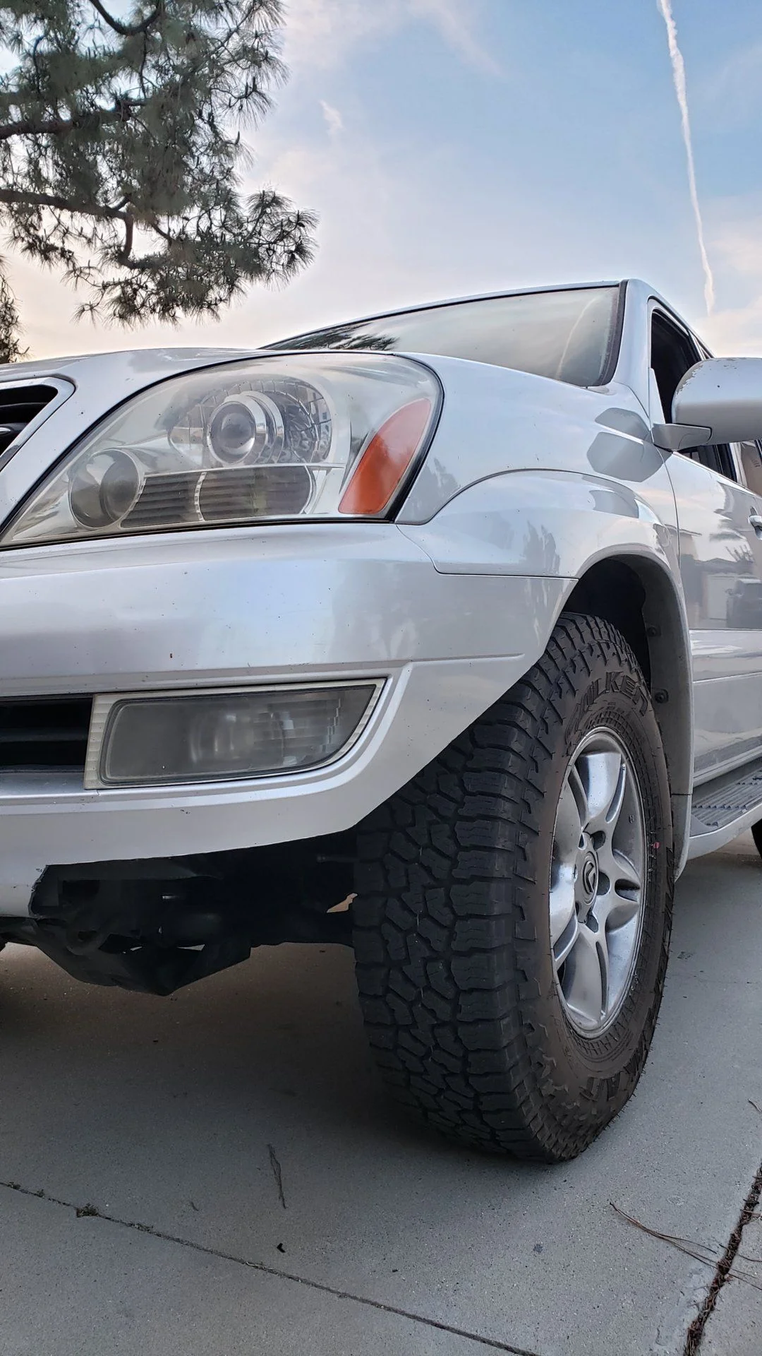

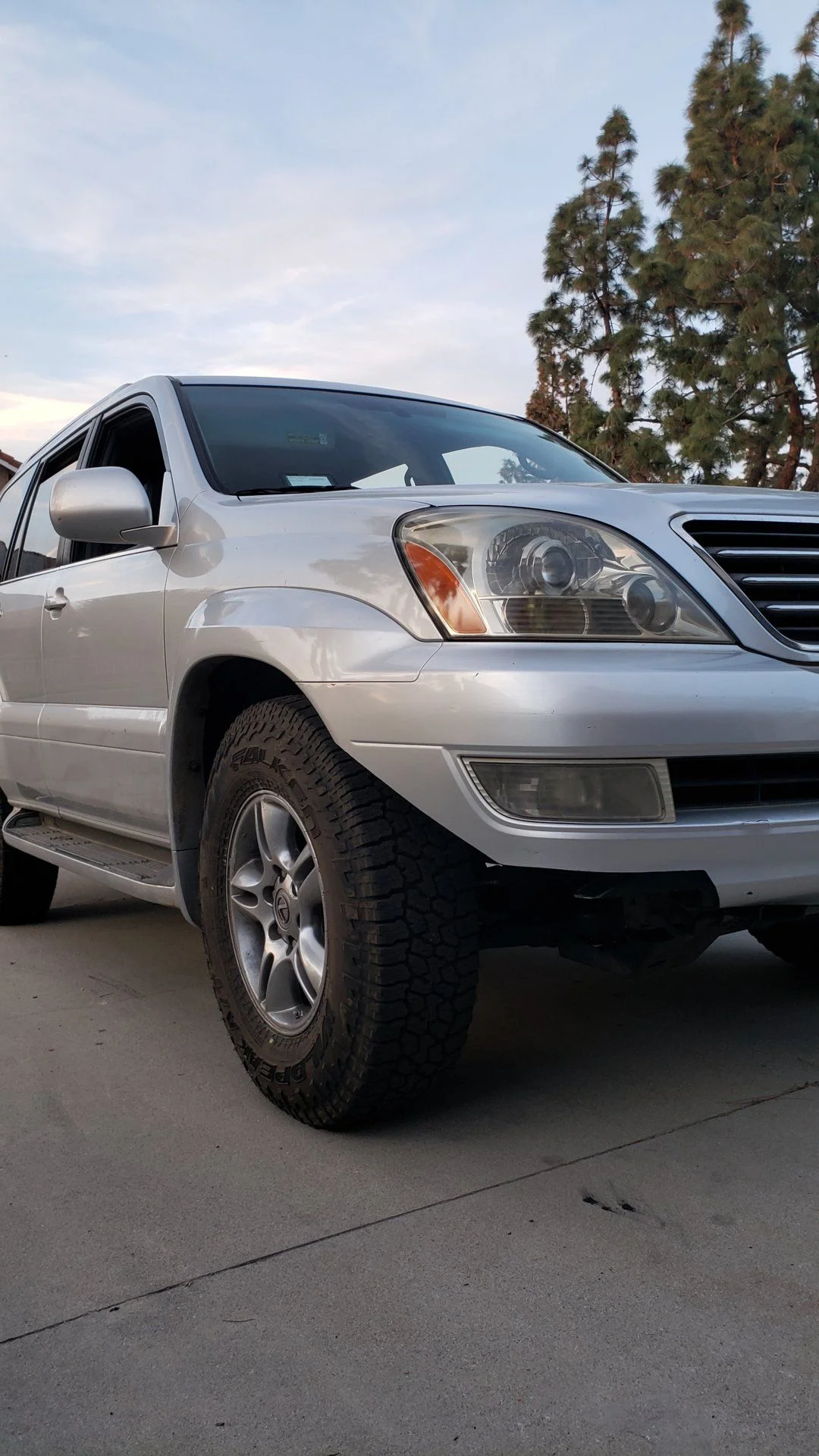

  • Falcon Wildpeaks AT3w 255/80r17 5x tires with BMC (love skinny 33" giving me 1" clearance for my rear diff)

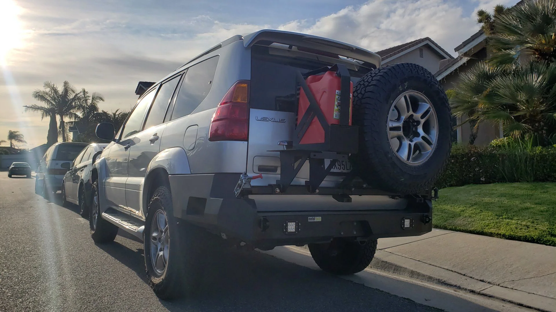

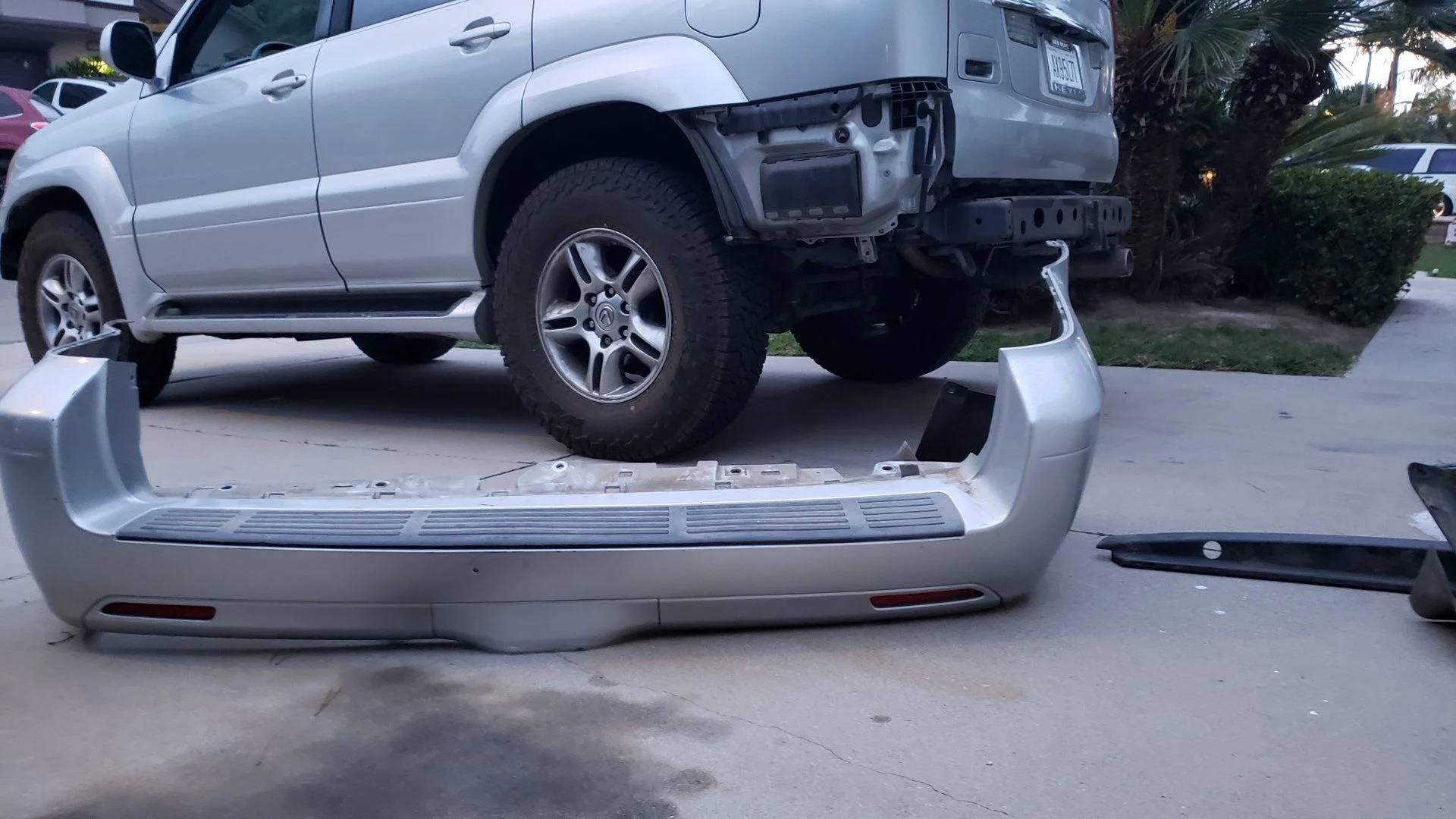

  • Used MetalTech Pegasus bumper with tire carrier (tks to another GXOR member at meetup)
  • Added MetalTech gas/water carrier mount, gas holder, license plate mount.
  • Timbren Active Off-road rear bump stops (glad i bought it before discover crack rear oem bumpstop).
  • LED pods for backup light within bumper.

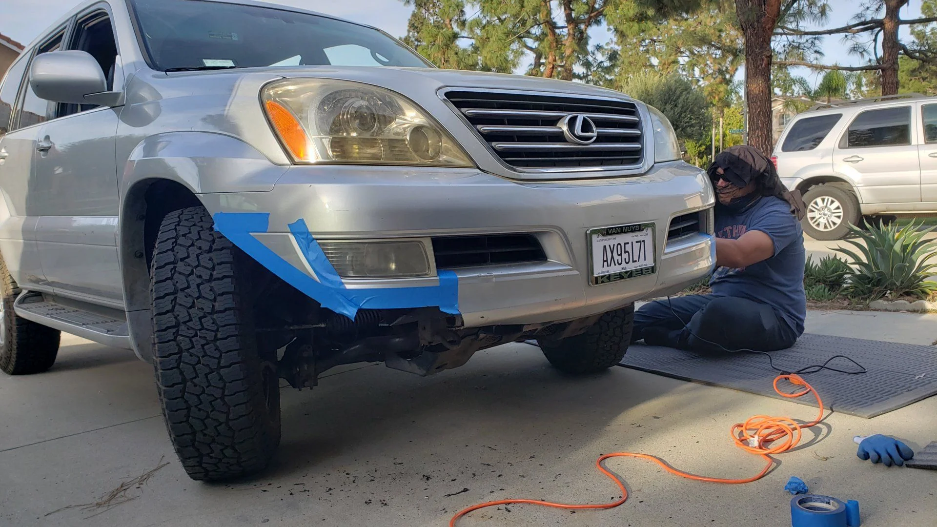

  • OEM front bumper cut (lasted only 1.5 month. :))
  • 3/4" front-spacer lift and 1/4" washer-bumpstop. (check out dranged for more information. Tks)

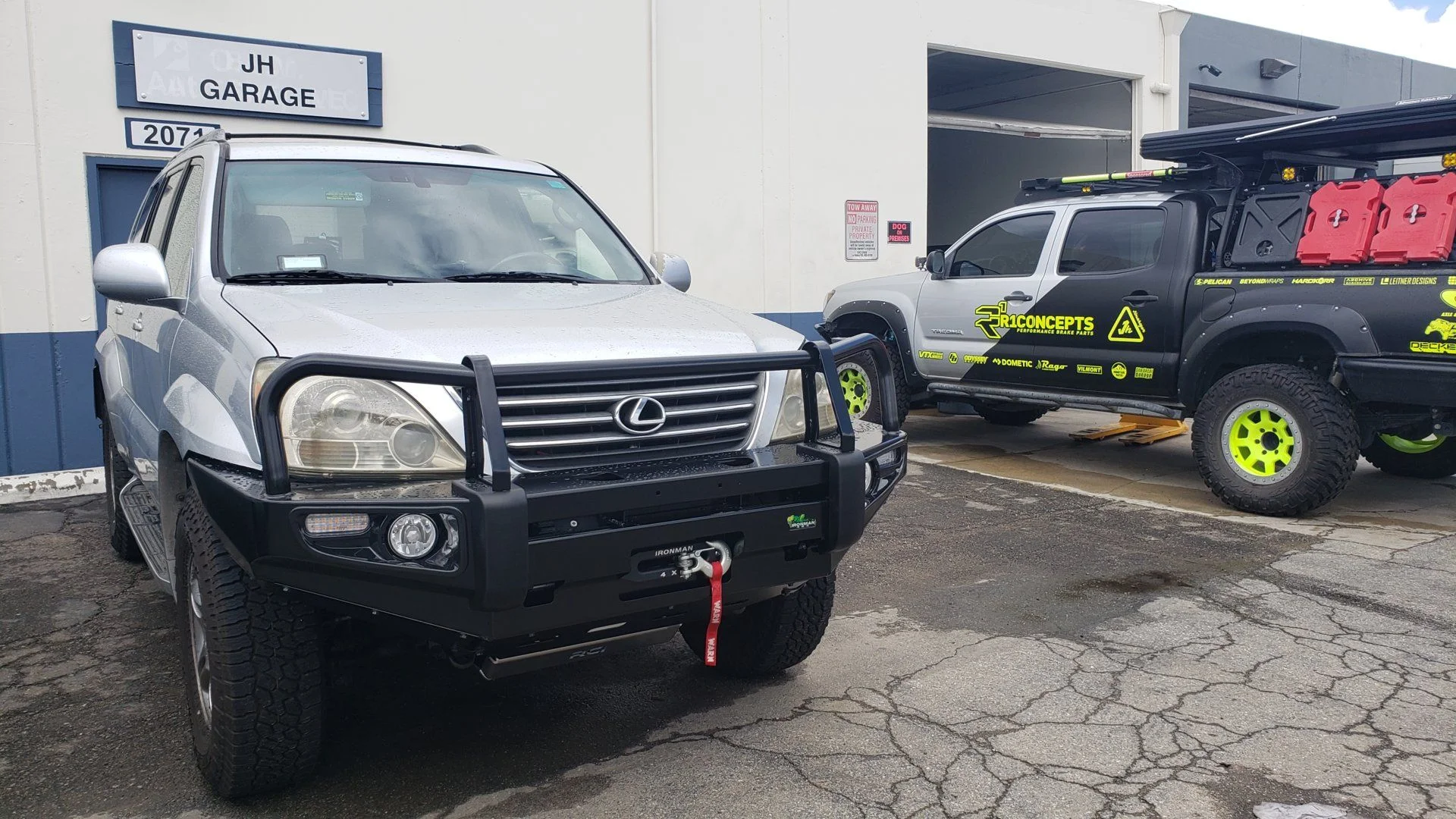

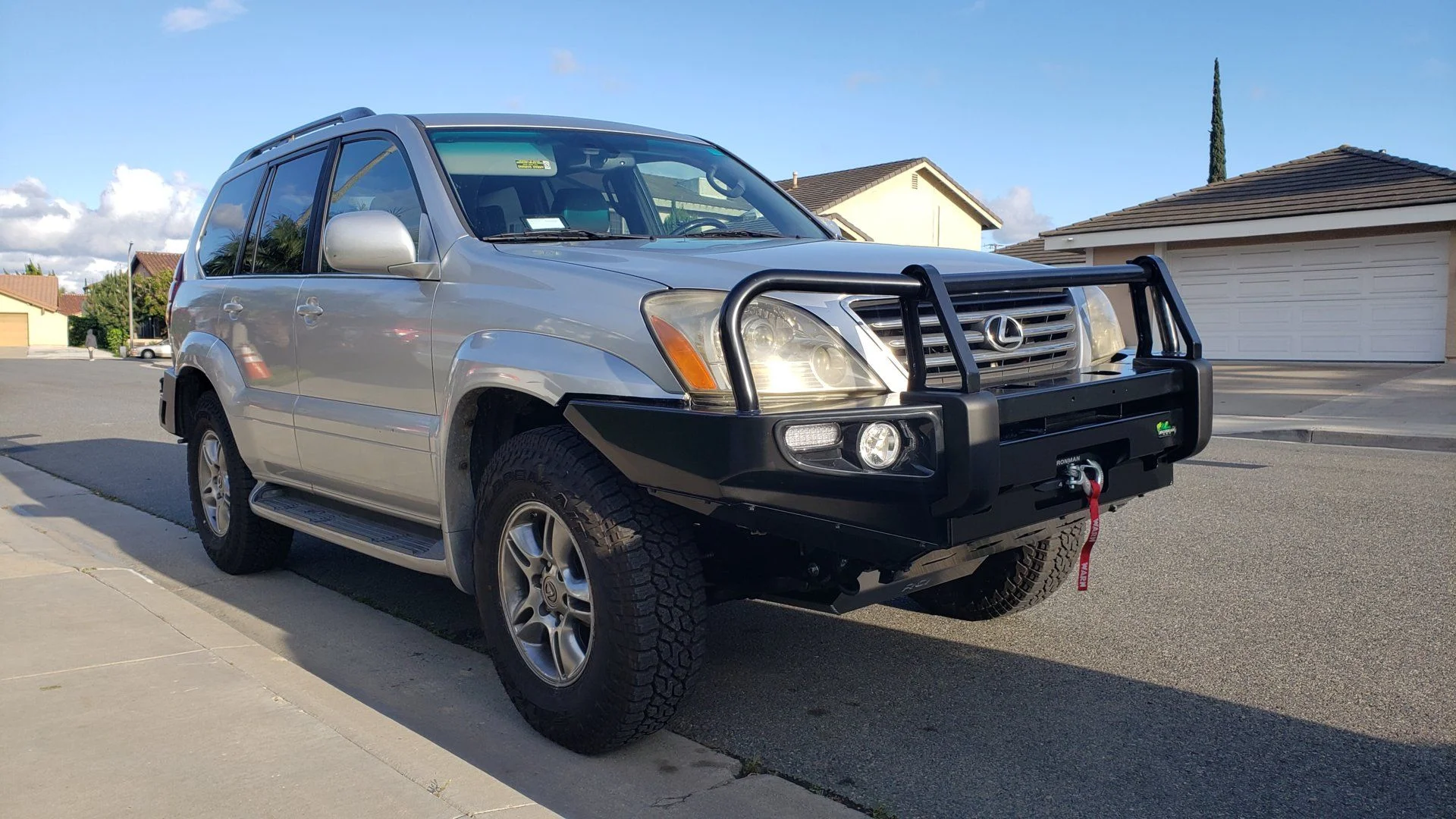

  • Ironman 4x4 front classic bumper (installed by Chris at JHGarage. Tks.)
  • Ironman 4x4 12k lbs Monster winch (Ironman deals tks to another GXOR member).

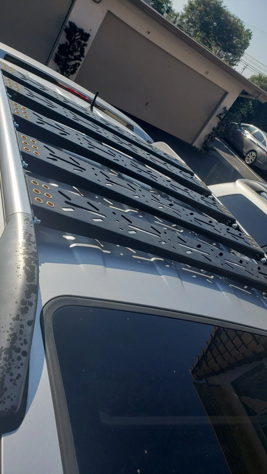

  • RagoFabrication cross-bar to mount to OEM rails.
