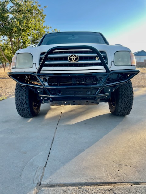

Summer of 2023 I had custom bumpers and slider by Kreyzfab in Pueblo, CO. Parts are slowing coming in for a whole suspension refresh. I got a used set of 2.5 DSC fox coil overs from @oldmantan . In the rear Ill be running OME 2".

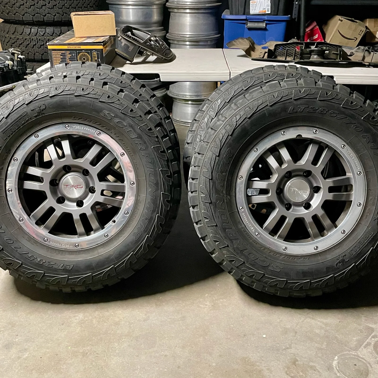

For wheel and tires I got lucky and found a set of TRD Rock warrior 6 lug with a decent set of 285/70/r17 C load tires in El Paso, TX. I drove 6 hours round trip. I had to have them.

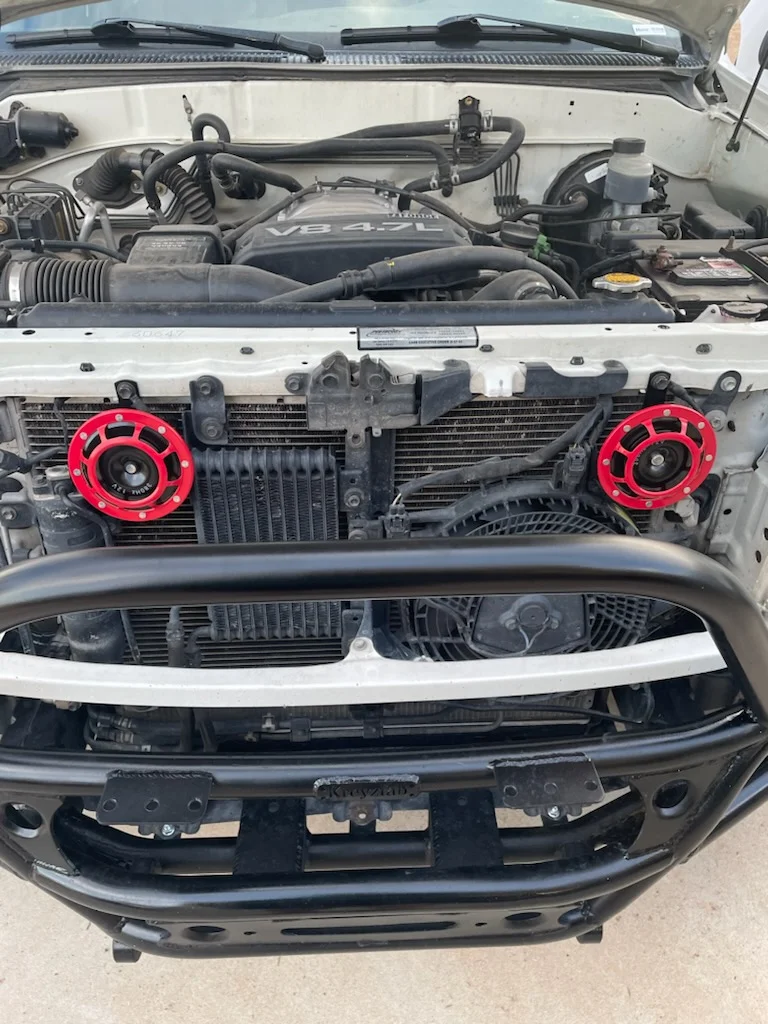

I installed harbor freight 12v disc horn. Easy install. I got sick of my sissy horns. They sound much better.

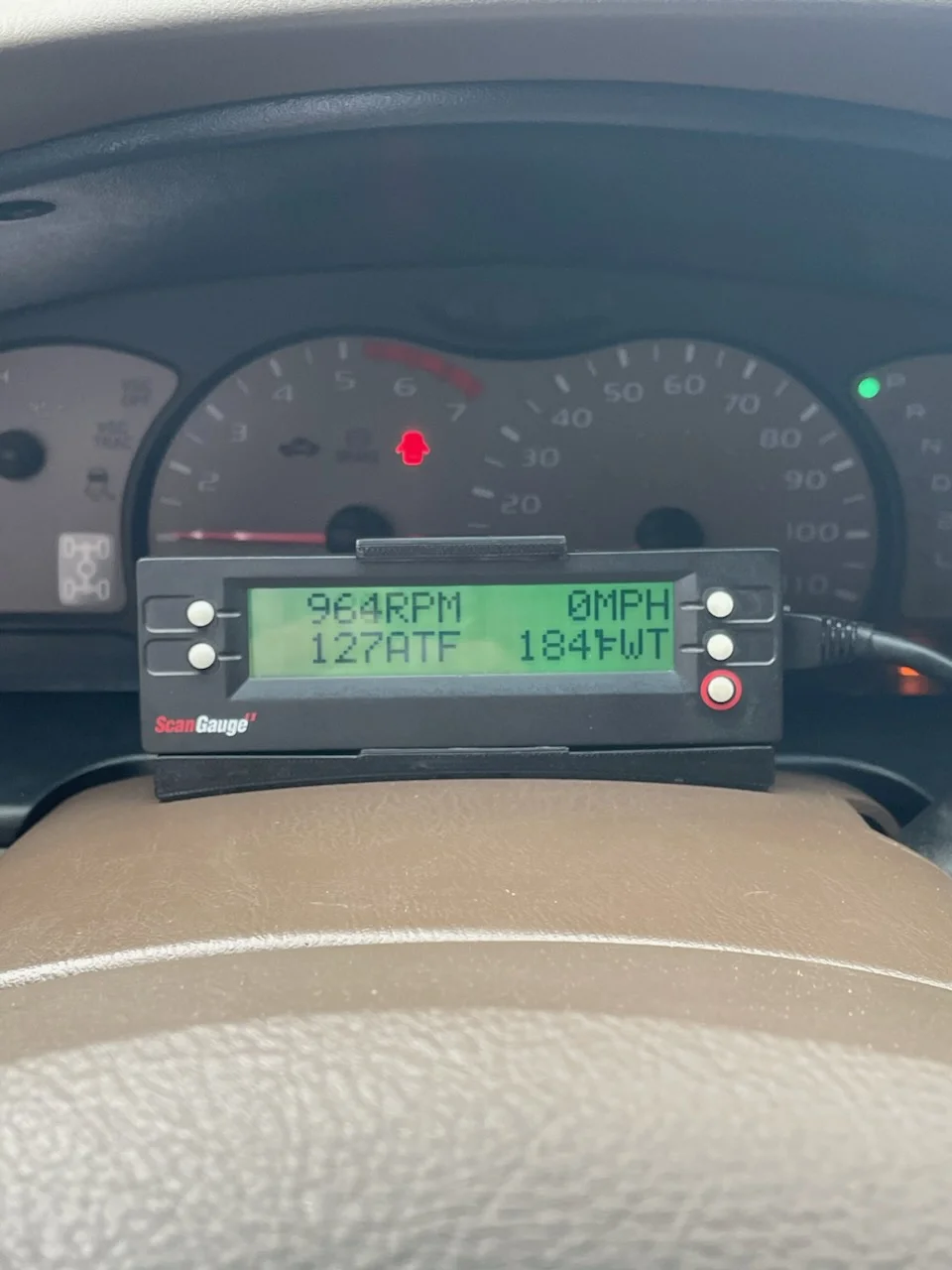

I installed a scangauge 2. I found a mount on etsy. Fitment is great. It doesn’t get in the way of the column shifter, fished the cable behind the column cover.

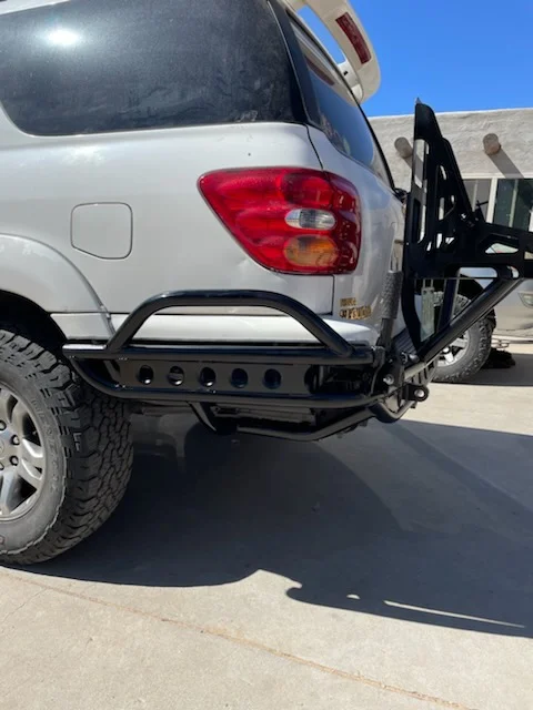

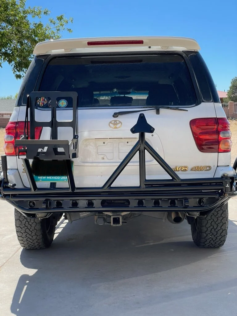

I really like that rear bumper with the top part of the OEM cover left in. It makes the wings look a lot less bulky and IMO, is the cleanest design I've seen for these trucks yet. Any shots with the swing out open, and/or any from a lower angle showing the bumper's position in relation to the body and frame?
Back from the dead!
Thanks I am really happy with the swing out. I’m looking to add a strut to help control the weight. I can get more pictures soon.

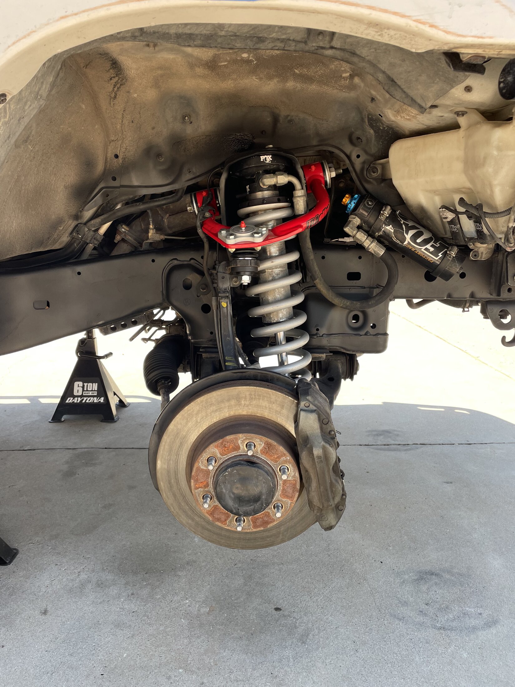

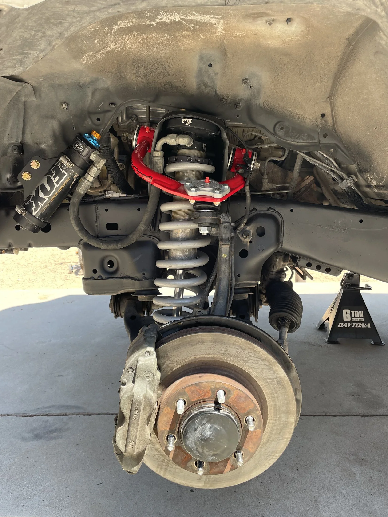

Finally got the time to install the FOX 2.5 DSC coilovers. Installed JBA uca. Install was pretty straight forward. I installed the reservoir.s inside the wheel well. I hope there no contact where I positioned them. I’ll double check once wheels are mounted.
Now I’m just waiting for the oem lca to arrive. I used electric heat shrink on the hose clamps to give it a cleaner look and protect the reservoirs. A little trick I learn when I had a F250 with Carli kings.
