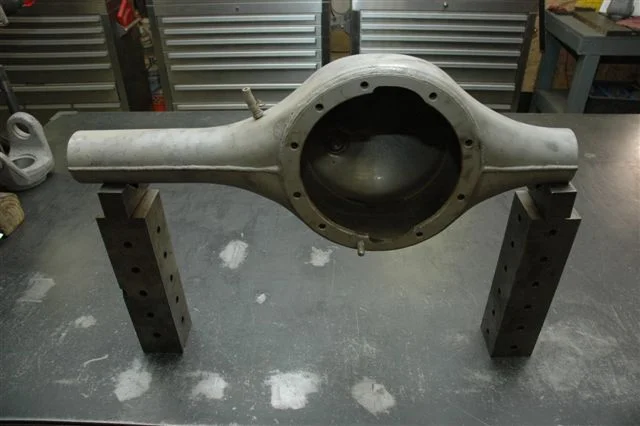

Guy,
We wanted to make a clean D60 hybrid axle and basically we are thinking of offering this as a kit. I have seen other hybrid conversions and frankly I was not that impressed by the level of the work. This is a Isuzu axle but I will be doing some for Yota and possibly Nissan.
We are splining the D60 inner shafts so the will slide into the third member. We are also looking at broaching the side gears as an option. What are your thoughts?
thanks,
Larry

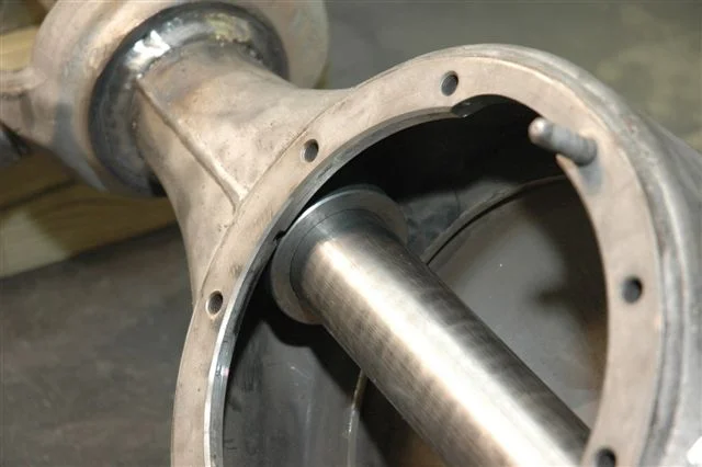

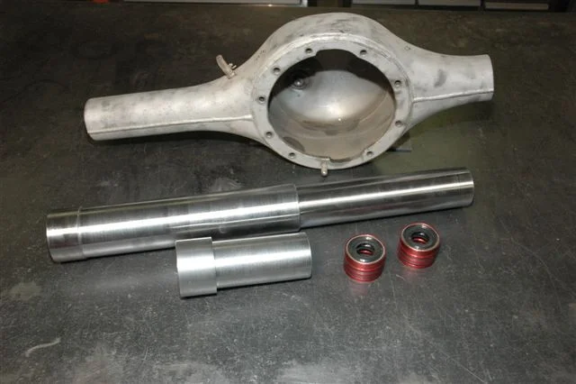

Dual lip seals which will be where they need to be.... near the bearings on the third member.

The tube is turned to match the inner 'c' bore and the OD of the original housing so it looks clean, and then turned down more to slip the full length inside the orinal housing tube. This provides a wall thickness of .475" if i remember correctly. It was machined with .001" clearance, the housing tubes were heated to 400deg and it dropped in. It locked up tight when it cooled. We will be also drilling a few rosette weld holes and buffing them down just to be sure it stays put.

We also have some inner 1/4" plates the tubes will be going thru where the seals are located. Basically this boxes in the whole housing. Thoughts and feedback encouraged :D.

That is awesome, but not many folks woudl do it right with the line-up bar and without it, the axle would be a warped POS as you know.
I can't see that working as a do-it-yourself kit. 3rd member axle housings are so prone to warping.
I was thinking that to. Its really only on the short side you have to watch. I can have a customer cut the ends off their rear axle and ship it via UPS to us and have us weld it for a few bucks. We could turn it in a day and ship it back.
Lar
don't mill the splines.. Broach the cruiser third..
i'd definetly have the customers ship you the donor housings. it'll keep problems to a minimum. tom's right, better offer/include a truss with the "kit".
i think it's a cool idea and the work is outstanding as usual, but how much of a market is there for a housing like that? 5-10 a year, maybe? is that worth the time and effort you're putting into this? not like you're sitting around the shop doing nothing.......
just my $.02 worth.
