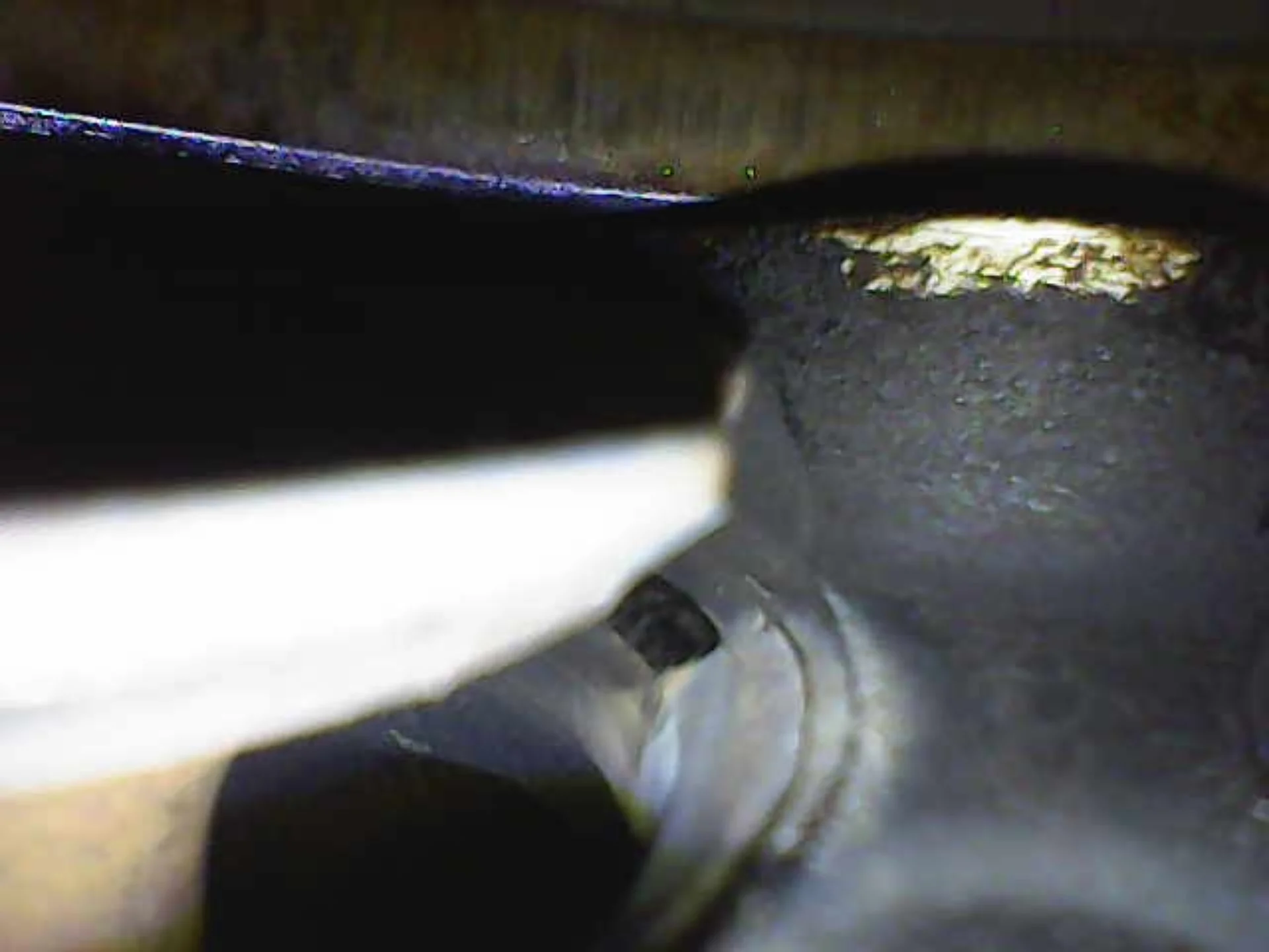

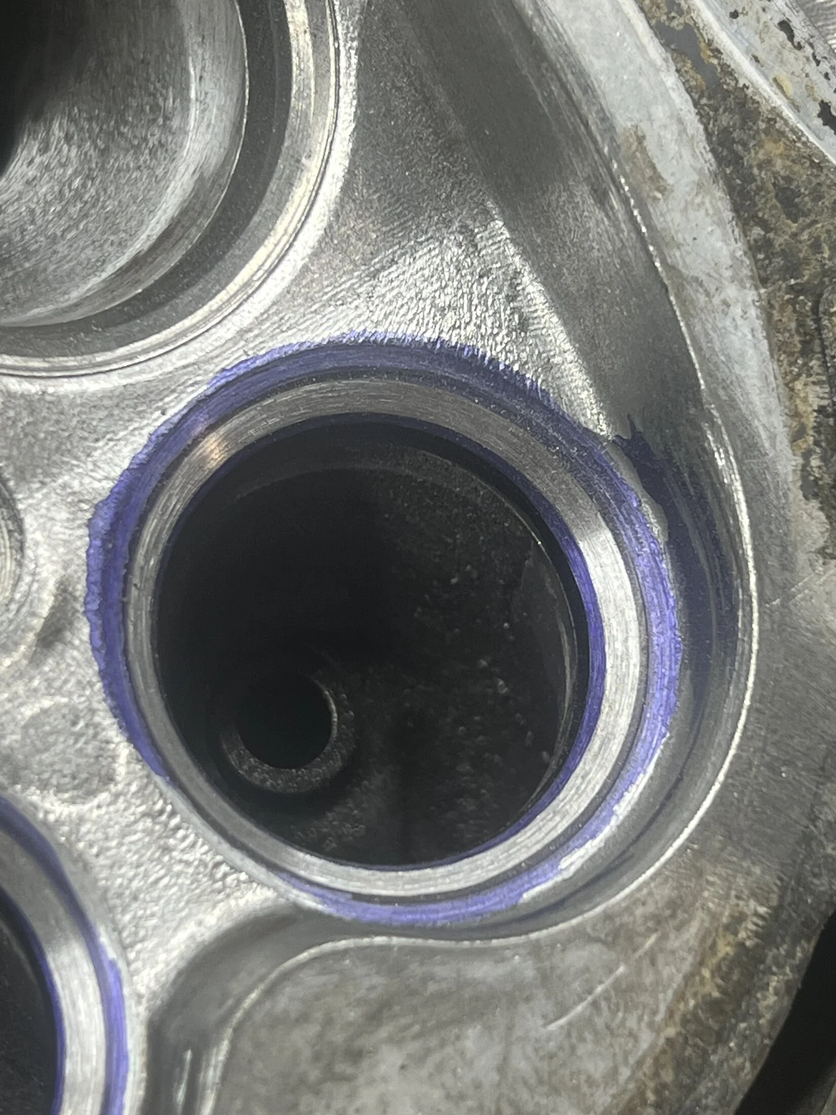

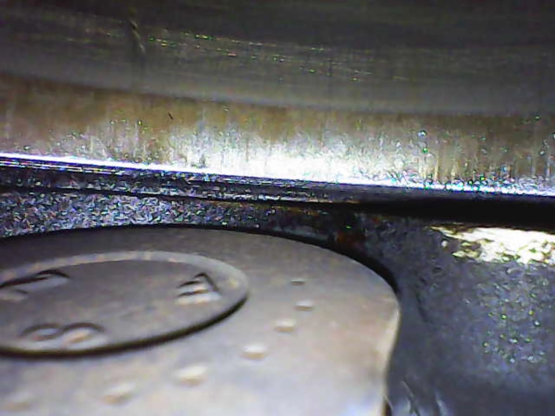

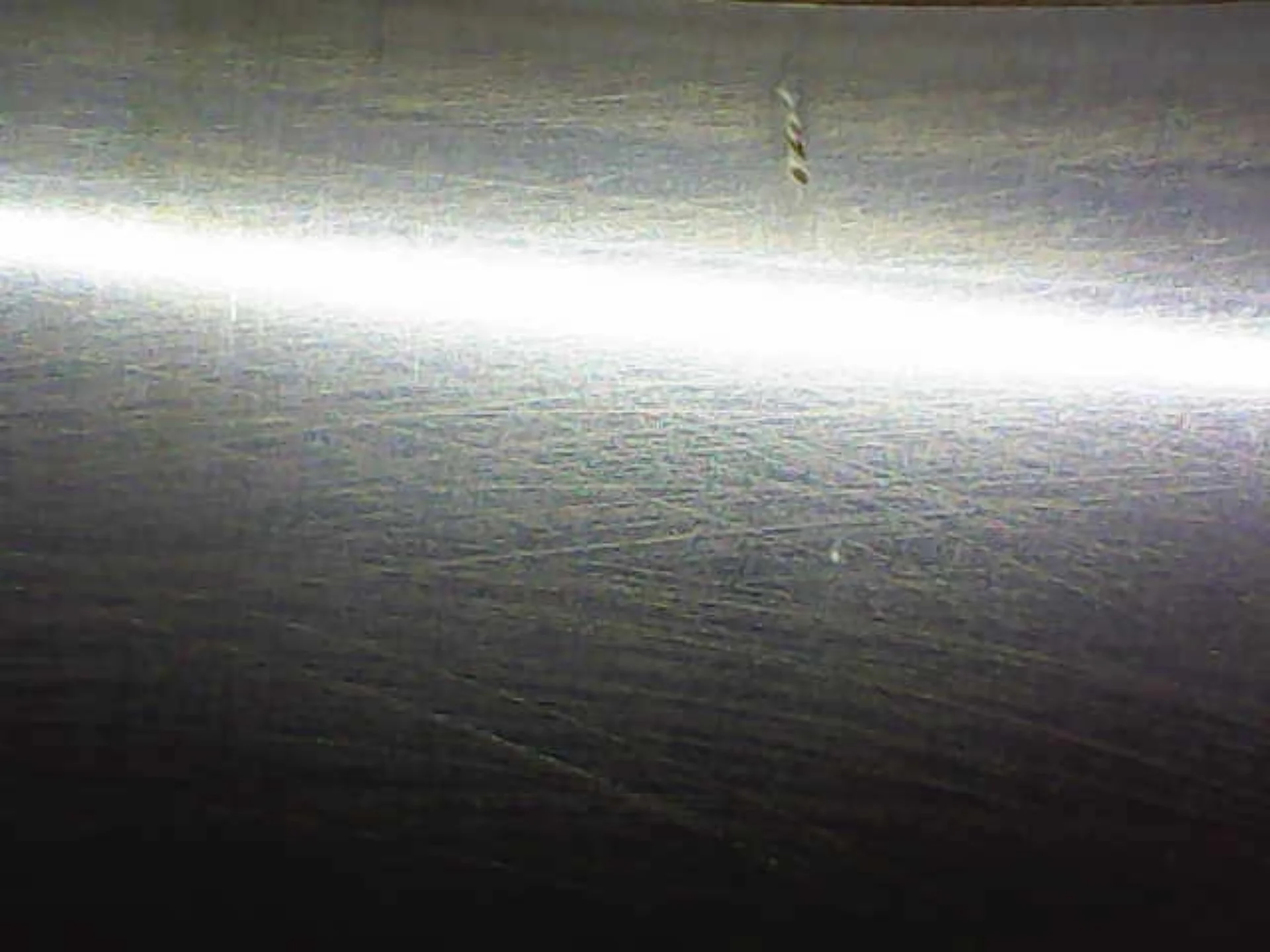

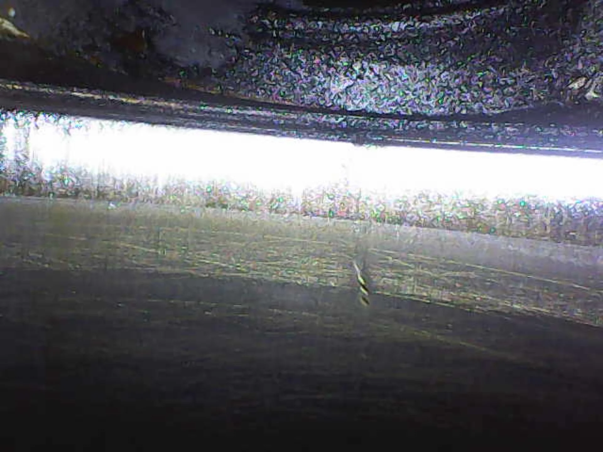

I posted earlier about my dyno results and ultimately finding low compression on cylinder #1 (30) & #4 (60). I have not been able to do a leak down test but took some not so happy pics with a borescope tool. It seems there is a nick on the cylinder wall....any experts want to weigh in if it needs to be honed or bored? It also seems I'm missing a piece of the intake valve.
Was something sucked into the engine to chip the valve, broken spark plug, or??
Negative….valves burn and chip for different reasons/conditions. Anyone care to comment on if this block will need work or potentially just the head?

I would be surprised if you could get away with just a hone on that. Ouch.
I'm also curious what caused the valve to chip. Maybe there's many different causes but sounds like a very serious issue.
Might have other damage you don't know about yet.

I would also note there’s potential that valve lashing went out of spec and contributed. I’ll confirm this soon enough.

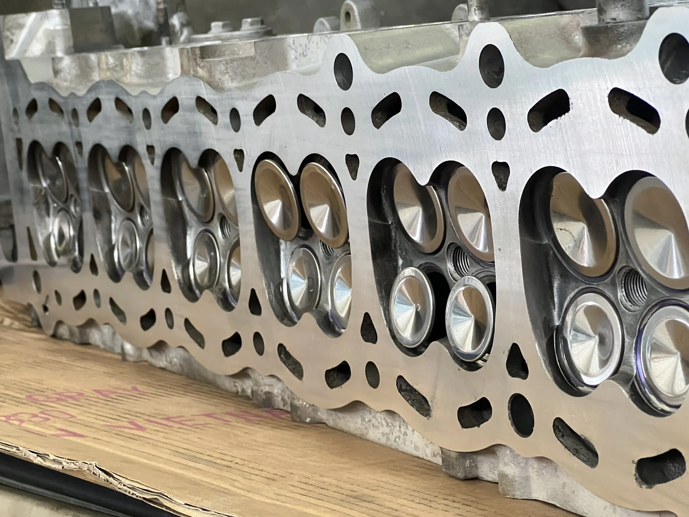

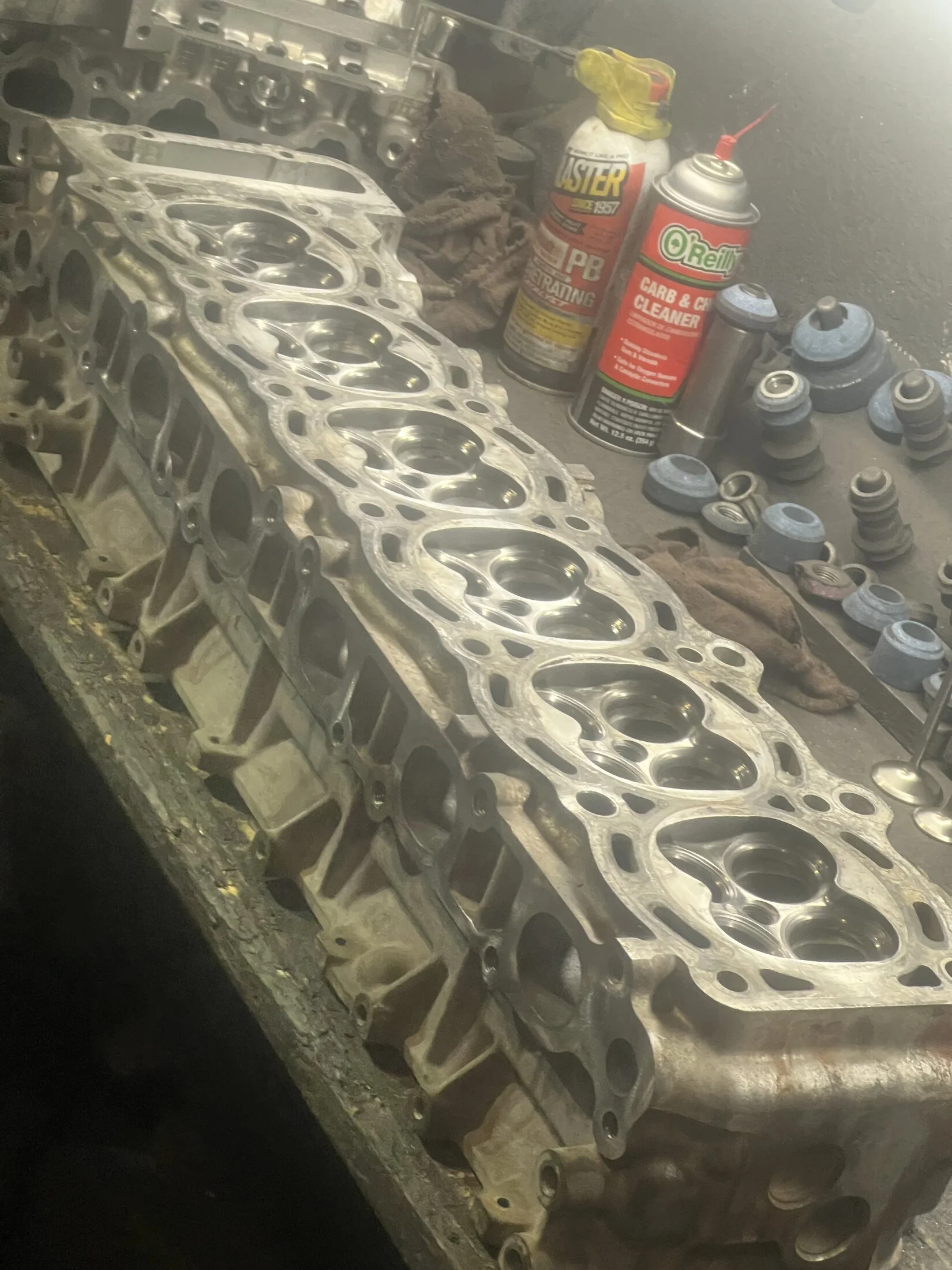

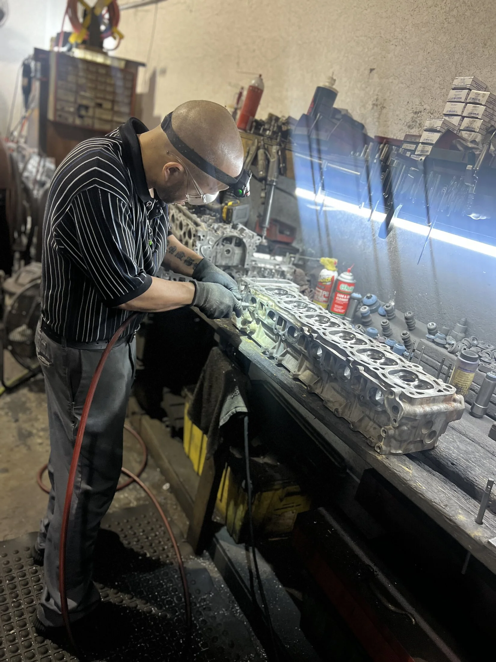

Finally was back in town to address the burnt valves. Went with Ferrea competition valves +1mm over intake and exhaust, 3 angle valve job and slight port on exhaust and intake with knifed runners…..Oscar at Orange Park Cylinder head did an amazing job. Anyone in the NE Fl area or close need work….he’s the one.
