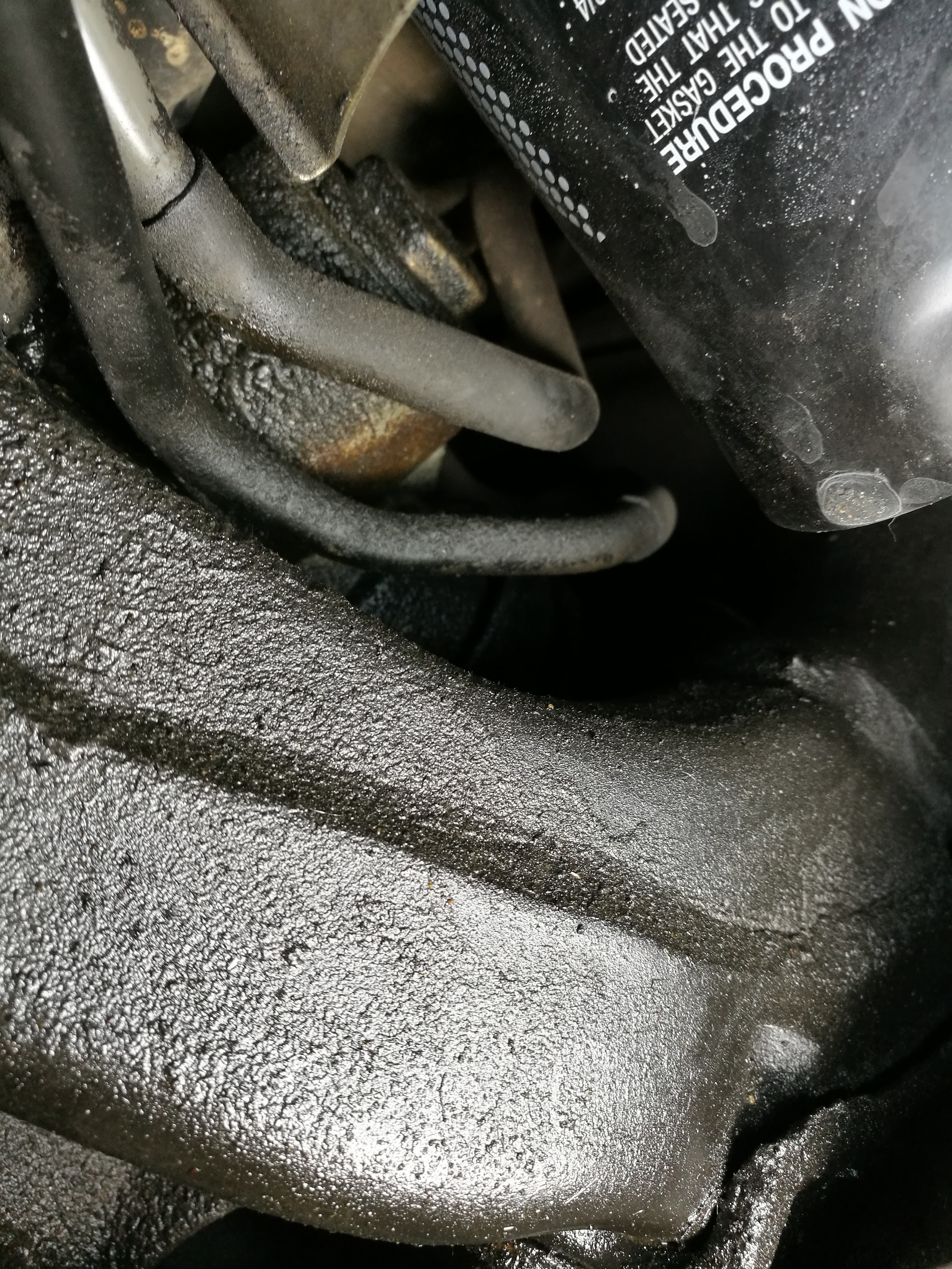

A little bit background here: recently bought a 1999 LX470 with 120K miles :), it only had been driven occasionally for the past 10 years according to the previous owner. Not too much maintenance records, only oil change and alignment.
The steering feels loose at highway speed so I decided to get under the vehicle to check, just to found out these :(:
I can see yellow fluid (not sure if it is front diff fluid) under the front diff as shown in the second picture. The CV boots also look like leaking grease badly.
My questions are
1. Am I correct about the CV boots leak and diff leak?
2. If so how can I fix them? Replacing the whole CV axle?
3. Re-seal the font diff? Or upgrade the front axle since it's a 99, I heard people said 98 and 99 has a weak front axle.
4. Is there anything else I didn't see here?:frown:
I am totally new to this, any thoughts will be appreciated.

It's hard to say what else is leaking because it's a mess under there. The gear oil in your diff stinks, does the oil on the bottom of your diff have a strong smell? If yes, it may be the output shaft seal on the diff tube. May want to check the fluid level in the diff too.

First thing I do is take pictures and study. Once I'm sure I've got all leaky areas captured digitally top to bottom, I clean. I keep cleaning until no more oil, greasy or wet spots.
The picture help detriment where to watch for leaks to reappear. In this way you can pinpoint the leaks. The pictures will also help along with watching reappearance to determine how much is leaking.
Your front drive shaft CV boot looks to be leaking at outer clamp of inboard boot, very common. It may need re-clamping or boot may be torn. You'll know once you clean.
Other leaks could be coming from above. Oils travel down and back, with some climbing up from capillary action and air flow. Again cleaning then watching will help pin point.
A lucky possibilities; oily PS steering rack boot may be leaky hose fitting at power steering reservoir above $2 fix, they leak and travel down. If unlucky your rack is leaking.
Front differential need new drain & fill washer (gasket) anytime removed, you may just need some $2 washer.
DS oil differential tube may be oil spilled from above and or oil dip stick tube O-ring $2. It may also be outer differential tube oil seal ~$20.
Clean, clean and clean then inspect. Then get a game plan of action.

Did you ever figure out what was leaking on the front diff? Im having a similar problem, I think. My CV joints are dry and the leak look like its coming from above the diff and alongside the engine but definitely not engine oil.
It was the steering rack. I ended up replacing it, I bought one from a Toyota dealer online ($750) and had it installed, also replaced all the bushings. Now it drives perfect.
