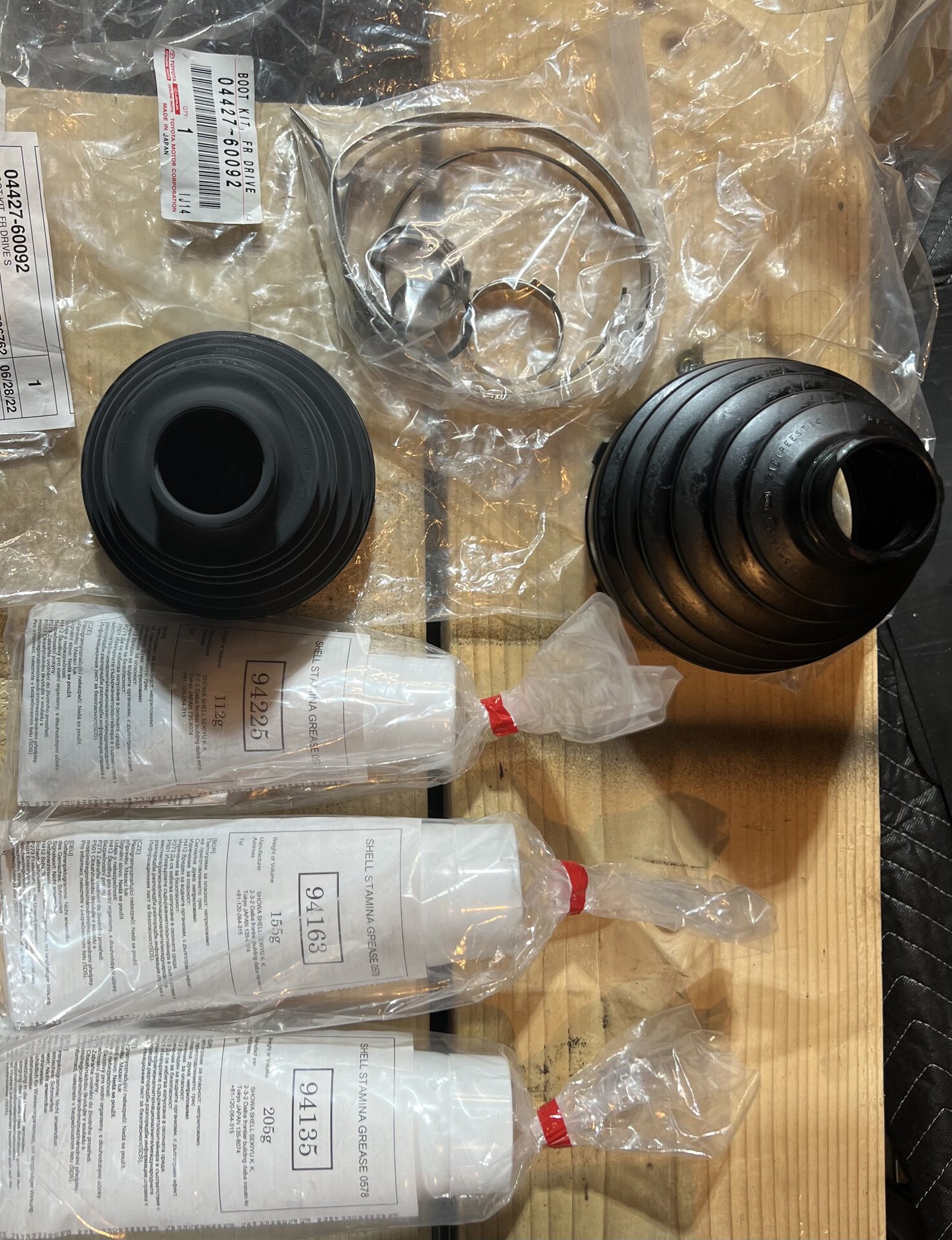

I got the kit that covers inner and outer boots.
There are two types of grease, which grease goes to which joint?
Thanks

Thanks all for the input, the two white tubes are the same grease which is almost black in colour.
The capacities are similar to what @Sandroad is saying, and would make sense to have more grease in the inner joint.
Here are the items that I got in the kit I bought from Toyota:
Looks like they are all shell stamina grease 0578 in different quantities...

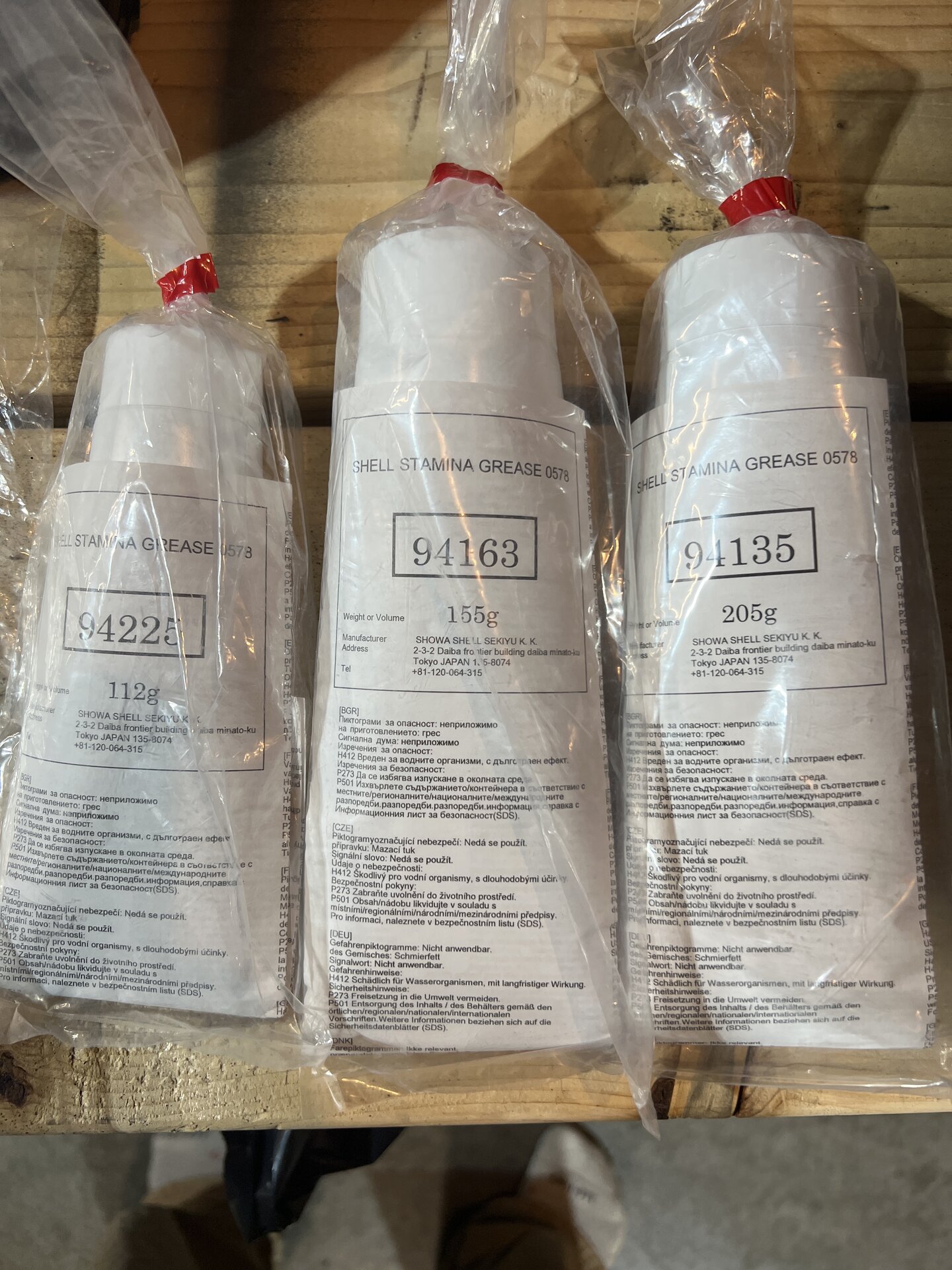

All 3 tubes contain Shell Stamina Grease 0578 (new name aka) Shell Gadus S3 T100 2 as it is printed on top of each label. The other main and center # looks like the kit part #'s.
The 3 tubes of Raremax grease in the op's kit is also a Urea base grease.
Is that a good thing or bad?
Having the same base and thickener is a good. Mixing them can can be bad and cause one or both of the old or new grease to separate and not protect the parts in the bearing from friction, corrosion in the applied application. The rule is not to mix grease unless you know they are compatible as per mfg specs. So in this case of CV grease kits with different part numbers it would be good to find know the the base and thickener, Polyurea. Not clay or lithium soap. I do not know why some kits are using a different color/m# if viscosity was the same but in this case mixing or installing the dark grease in the outer CV instead of the inner...or was it the other way around is not going to cause a problem with separation.
So urea/clay/lithium soap all could include things like moly and/or perform to Toyota’s standards adequately? No real advantage of one over the other as long as they aren’t mixed?
In this application of a Toyota CV grease in a kit from what looks like a label from Toyota has the mfg name model and part # for the grease. Both kits use a urea grease as per their model and part # and the other ingredients added are an unknown.
Looks like your part may be the new superceeded version 93 (vs 92).

Both my front CV outer boots have pinhole leaks. Put some RV sealant on as a bandaid and now it's time to replace the boots. I have the Toyota boot kits, purchased earlier this year.
Figuring out which grease goes where has been very confusing.
Like the OP, my parts numbers are also the same.
Back side on grease packages:
I'm leaning on putting the two white tubes (assuming black grease inside) on the inner joint and the tan colored pouch on the outer. Seems to be what Car Care Nut goes with.
