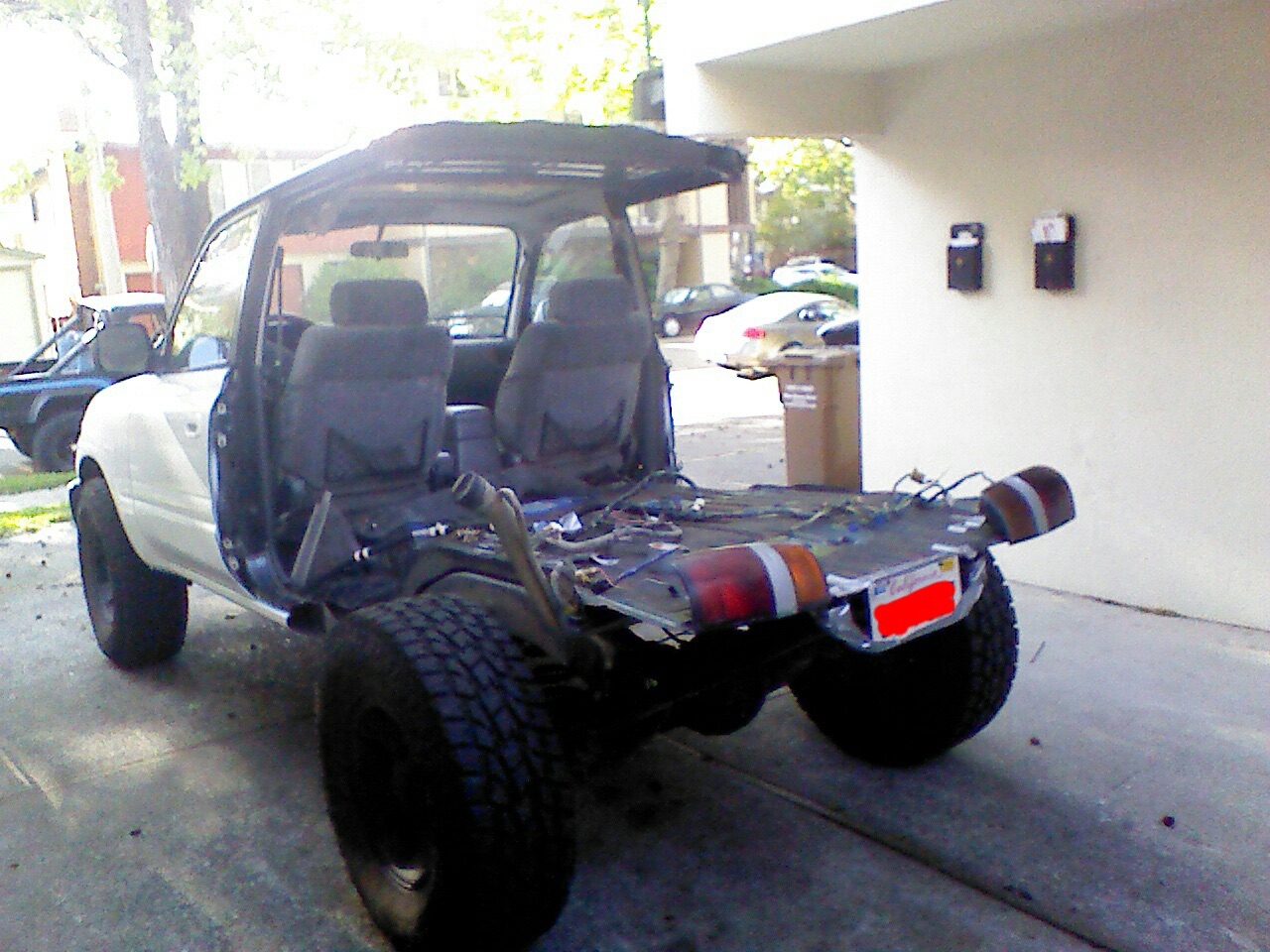

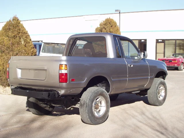

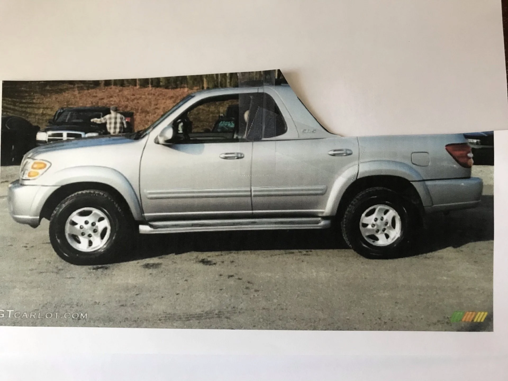

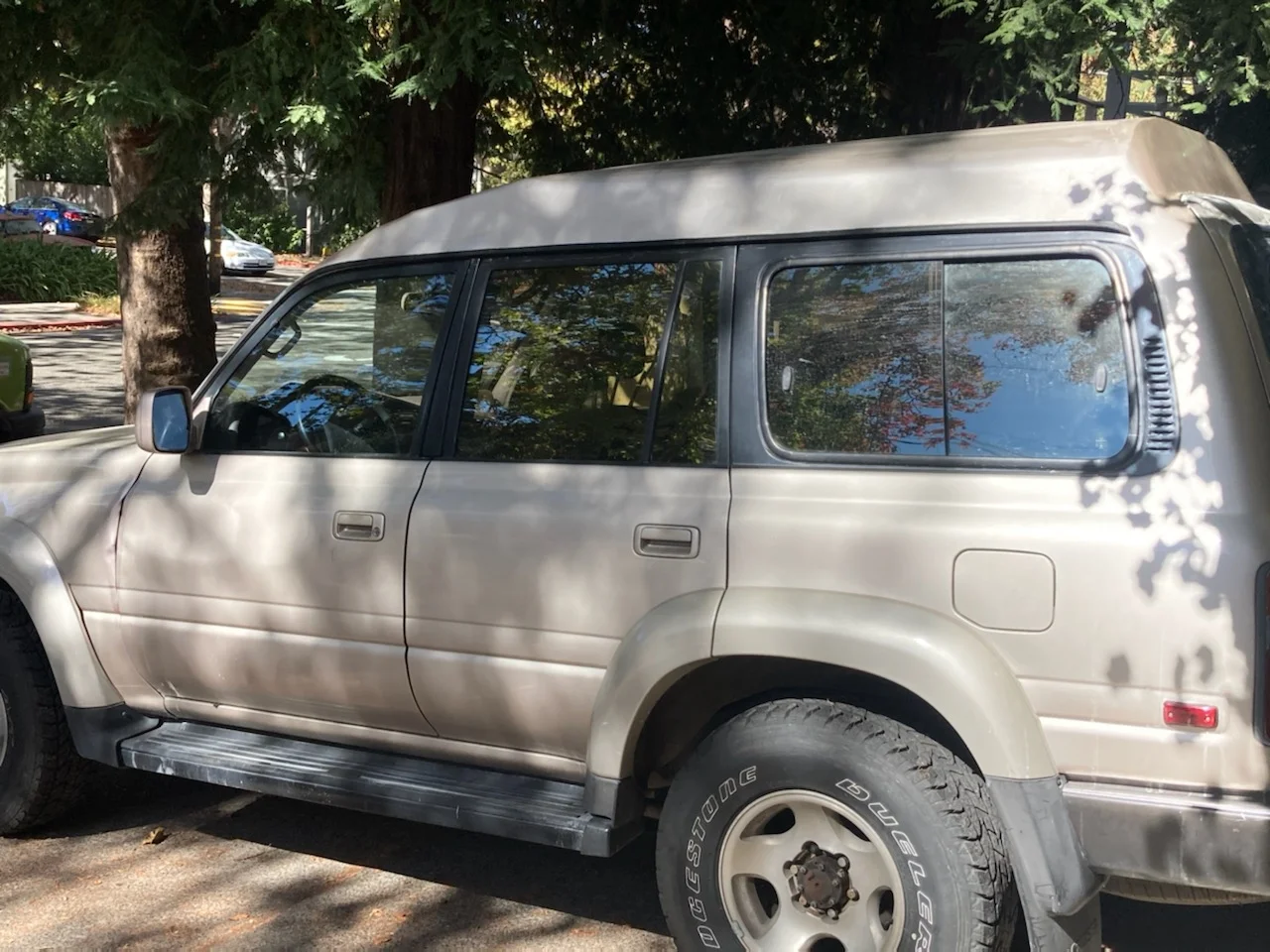

Its easy enough to cut out the rear top aft of the sail panels. Wouldn’t want to close it in with steel cause the box is too small. Sooooo. Chop it to the front doors and weld in the back doors?

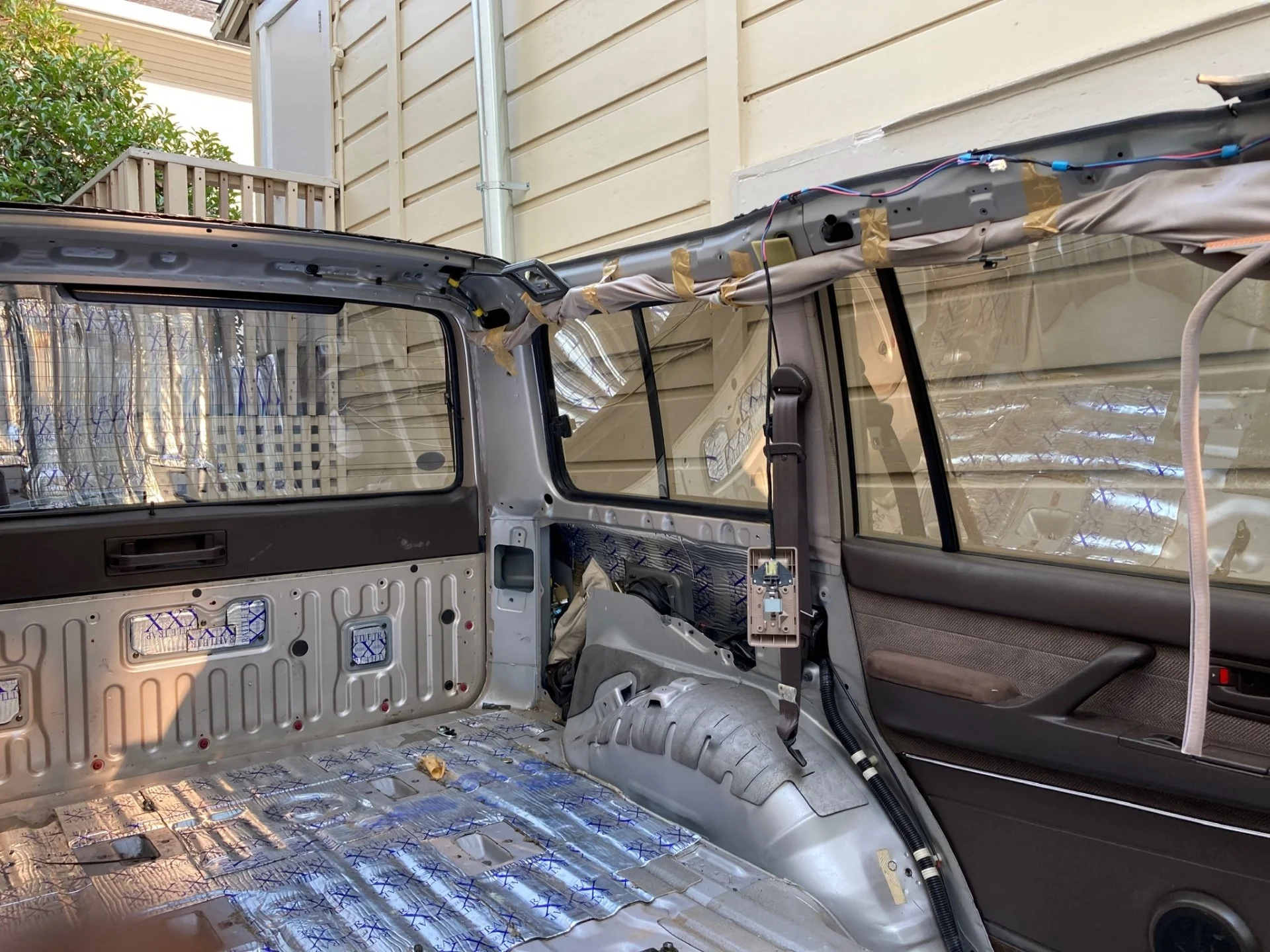

Slee has a build they did of an FJ80 they made into pickup that looks good. Basically like an Australian Ute. They called it Vard Vark or something. A little easier on an 80 though cause the body line are straight.
Wouldn’t turning a Sequoia into a pickup make it a ...Tundra??

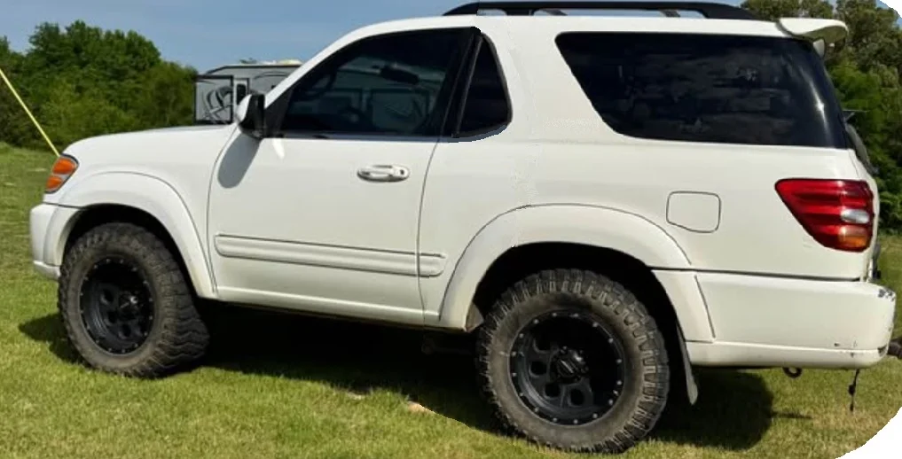

And that second picture...no. Nope. No way. Looks like a Honda Ridgeline 🤮
I kinda think that's called a Tundra ,but I've also never really understood the fascination with cutting SUVs as many people do with LCs overseas.
Arent any Tundra's that are as short as the suck oia would be. I've considered putting a regular cab on the short frame of the Sucky but they arent that easy to come by. The regular cab that is.

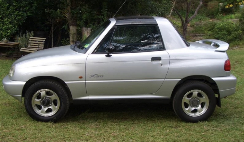

The Suzi is cute but its short about 4 cylinders and there is zero bed a bility. I can put a 4x8 sheet of plywood in the Sucky, if it wasnt for the SUV tailgate. Best tailgate they made was on the FJ80, split with a drop down tailgate. You can sit on the tailgate with some cover by the upper half up. Or stick some lumber in the bed with the tailgate up and the hatch open.

Kinda like the idea of cutting the top off aft of the sail panels (lose the rear quarter windows) and make a tailgate. End up putting a boat canvas cover with a window so you can pop it off when you want.

You know, you could cut the top off the Suzi and make a pretty cool convertible.......................just saying

I did it to my 80- fairly easy process and of note/ surprise was how relatively weak the crossmembers were. I ended up reusing them and added a touch more support. My biggest fear was fire...... and biggest lesson learned was tensioning the new roof to have a natural bow to it outwardly so it wouldnt pop in later. (this happened on another 80 where i welded up and sealed the sunfoof delete and didnt add enough outward arch/ tension.
Throwing this onto the interweb so maybe someone will be inspired and do it.
