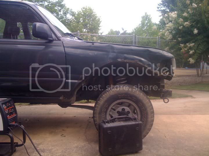

My horrible attempt to cut the inner liner out and weld the outer back on...
so I'm jsut going to buy some flat stock and cut and tack to cover it up...
I need the space of the "front dove"

Wood buck cut to shape based on what I'd cut off. Angle iron w/ slits cut to allow bending. ( I tried it once without slits, and it twisted too much). Then slit to bend the opposite direction to match the curve of the panel. Holes drilled in fender to spot weld to vertical part of fender. Then welded on the seam. I'll have to clean it up a bit, my welding sucks w/ this new cheap arse flux welder, but really needed a 110v, and majorly broke. So anyway, here's what I ended up with, We'll see how the other side goes. At least I'll probably get another shot at this when I cut the fenders another 1.5" for 44's :)
