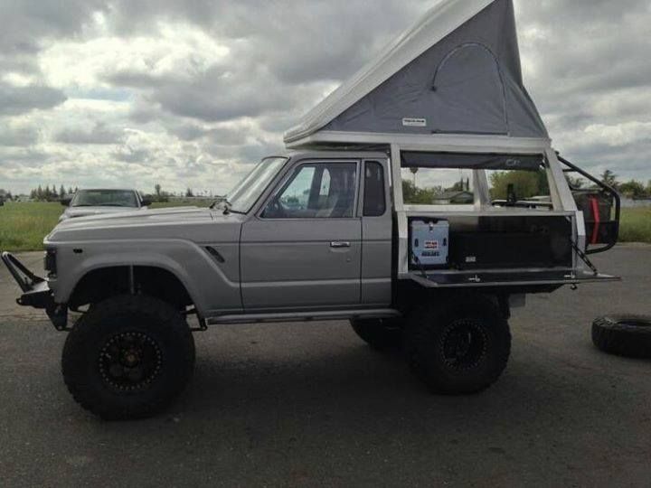

You mean like this I have pondered on doing this to one of my rusty 62s
Bobbed and crew cab ... like a 24in bed
@Mace is that your bob?
I want to make a P/u like this someday
Yeah, that's my bobbed 60..
