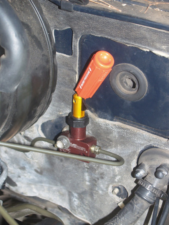

Mine weighs close to 7100 lol my girl is chubby! Anyone have pics on how they ridded their abs system?
may be able to round up some pics but basically just yanked it, made up
new lines to the first connections downstream of the abs and then added
a manual proportioning valve...
