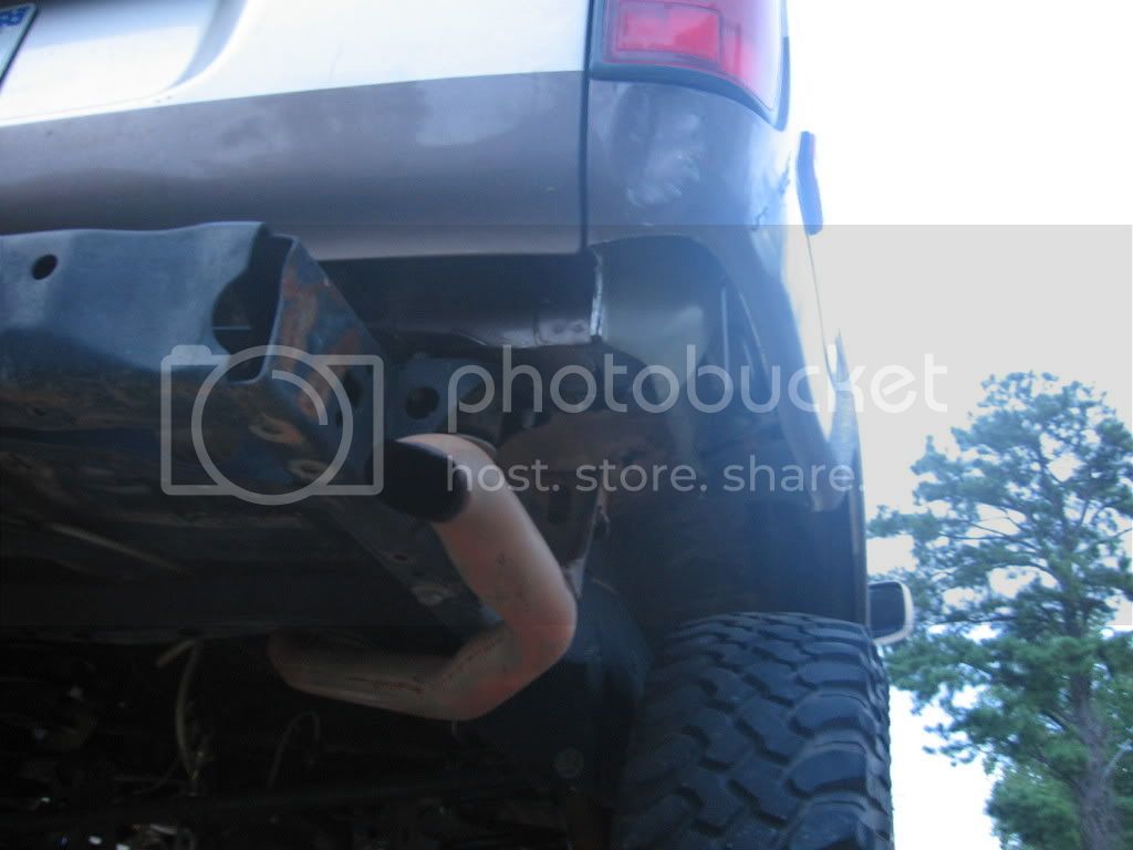

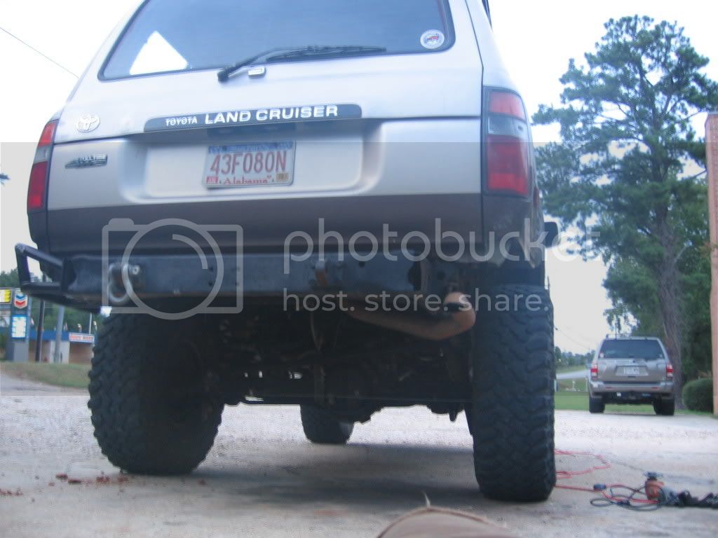

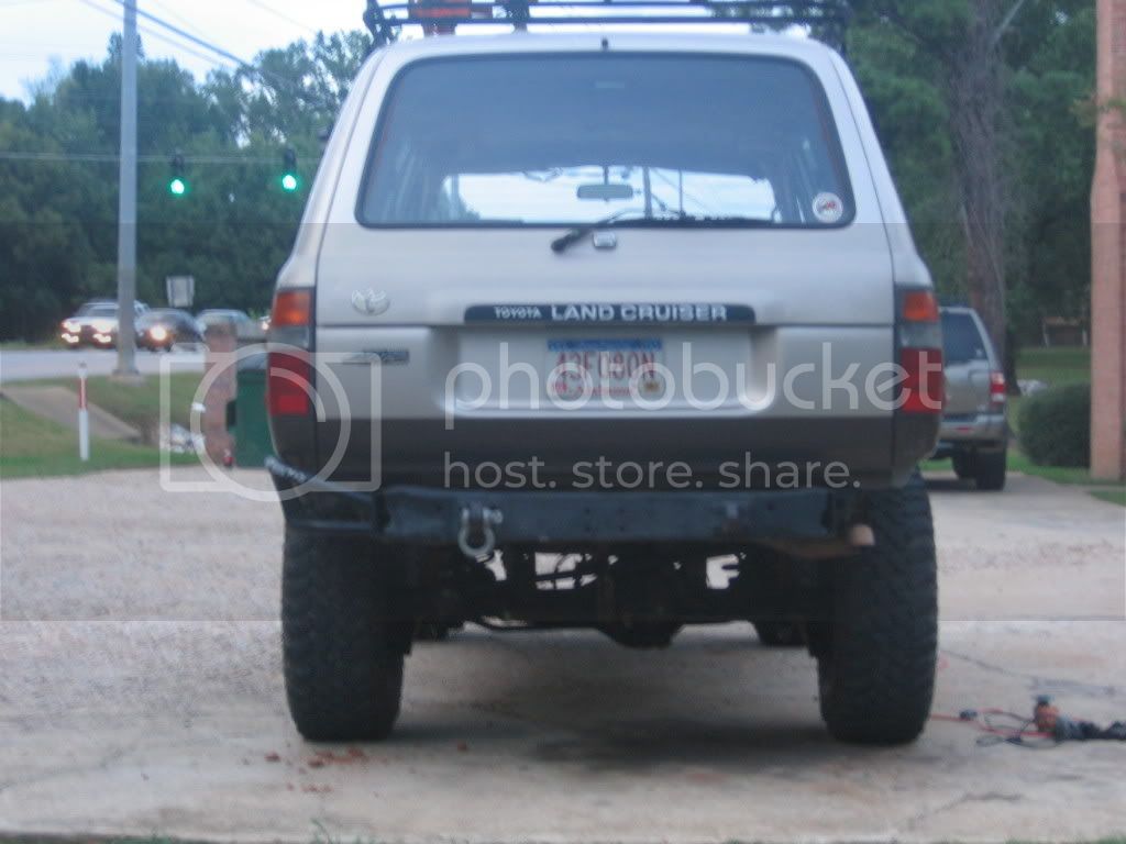

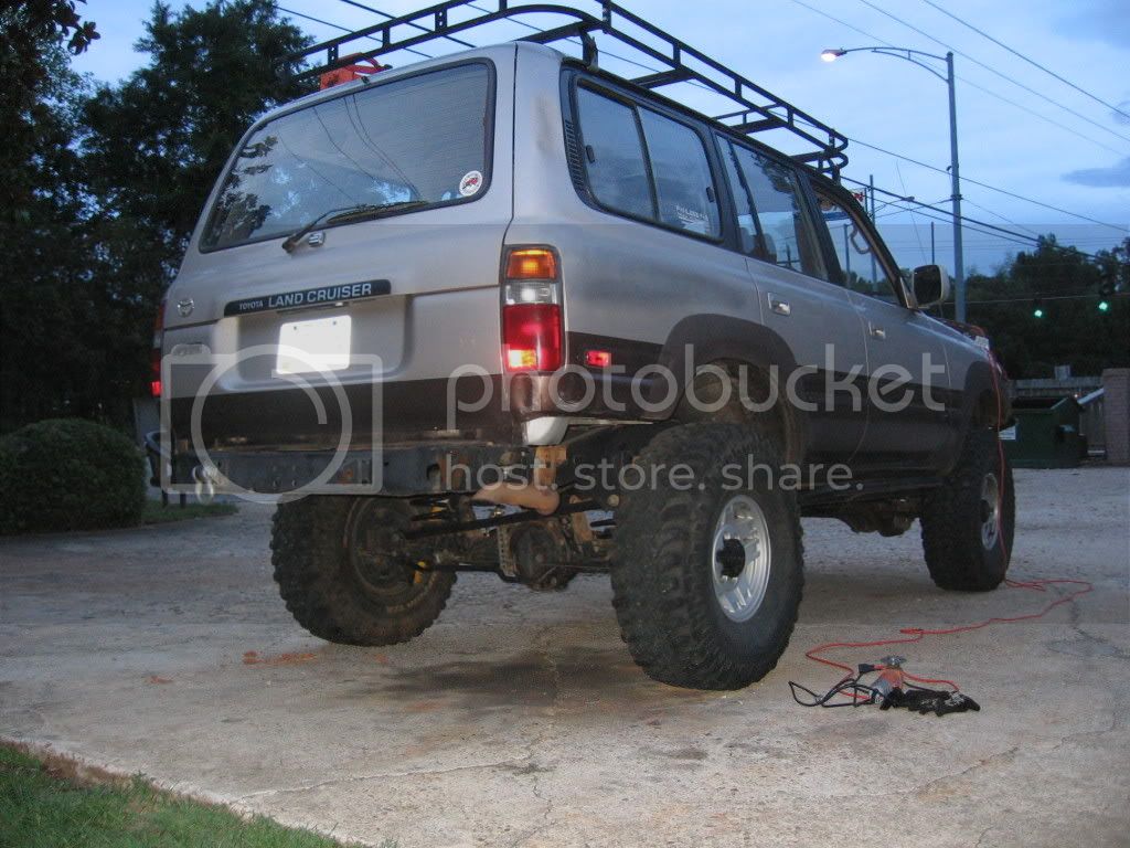

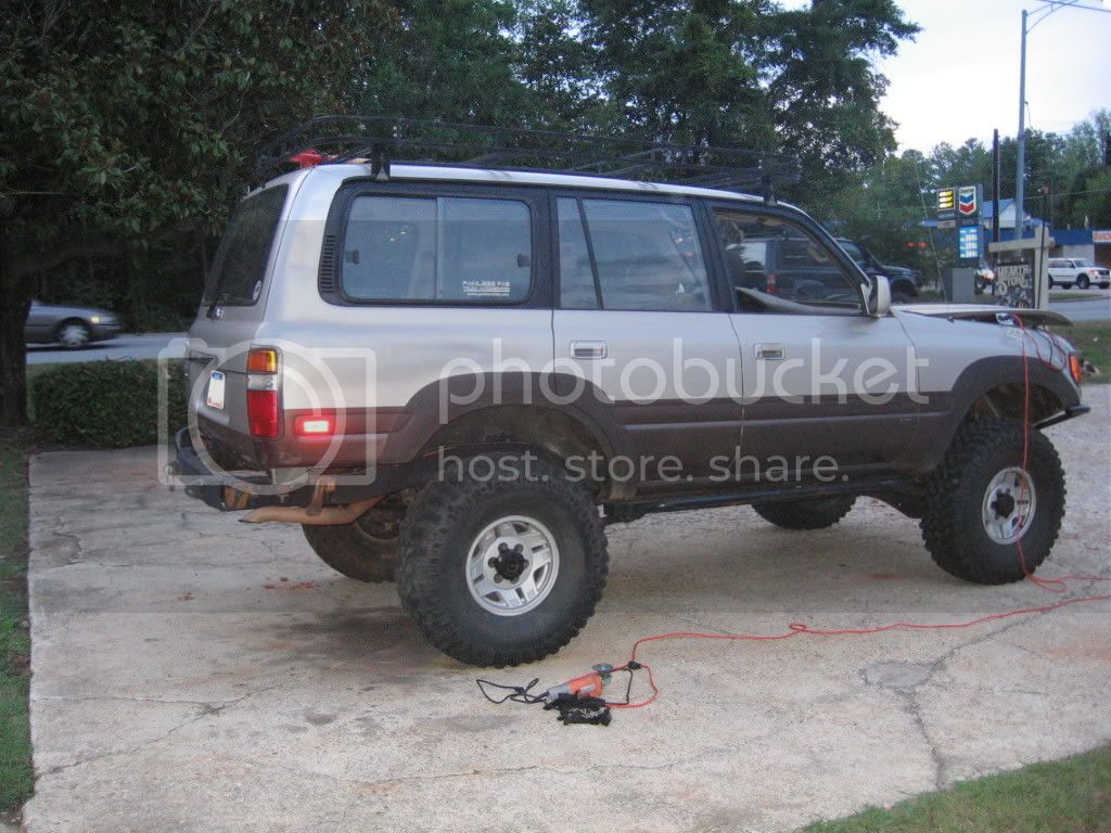

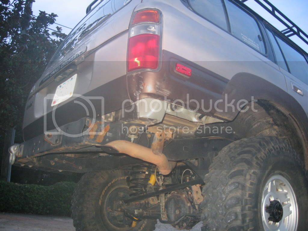

Been planning this for a while now.... so I started this evening. I'm REALLY liking it! I plan to make mini-sliders that look like my actual sliders I made a few years back. But this time the slider legs will only have to come straight out. I'm also gaining serious ground clearance as evidenced by the other side of the pics.

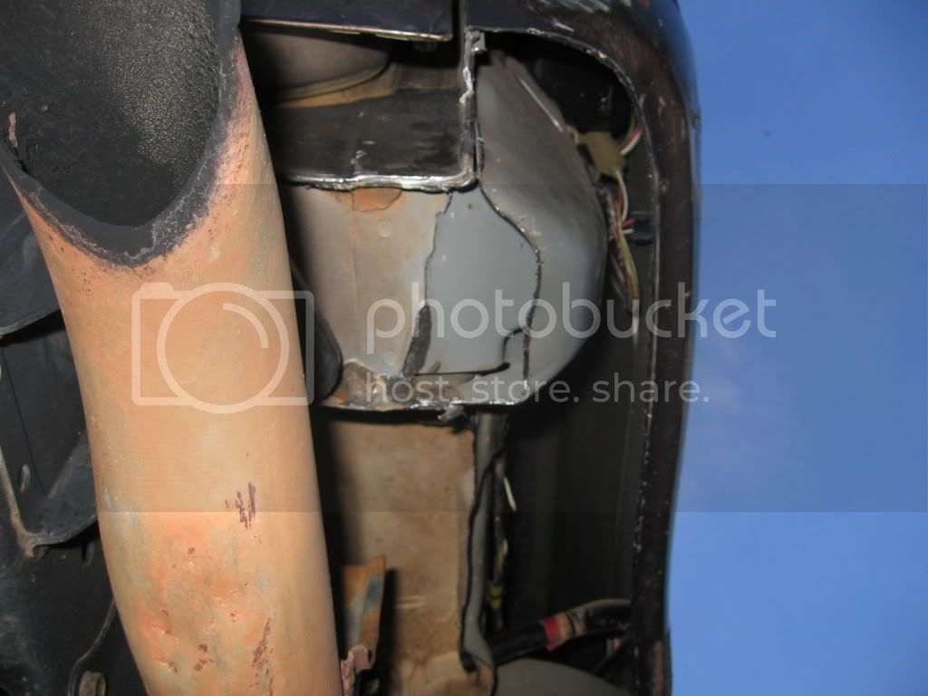

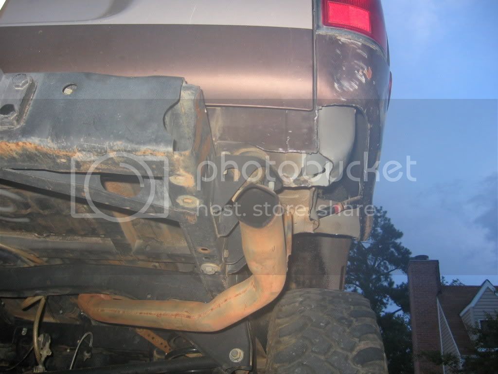

Anyway, my issue. How do I get around the pillar in the pics? From the looks of it (hopefully the pics will show) the outter part of the pillar can be cut since the inner part is what is tying to the lateral brace.
Where is the threads of others cutting... I've seen them... gimme links!
PS: the tail pipe will be cut at about the frame rail too!
more....

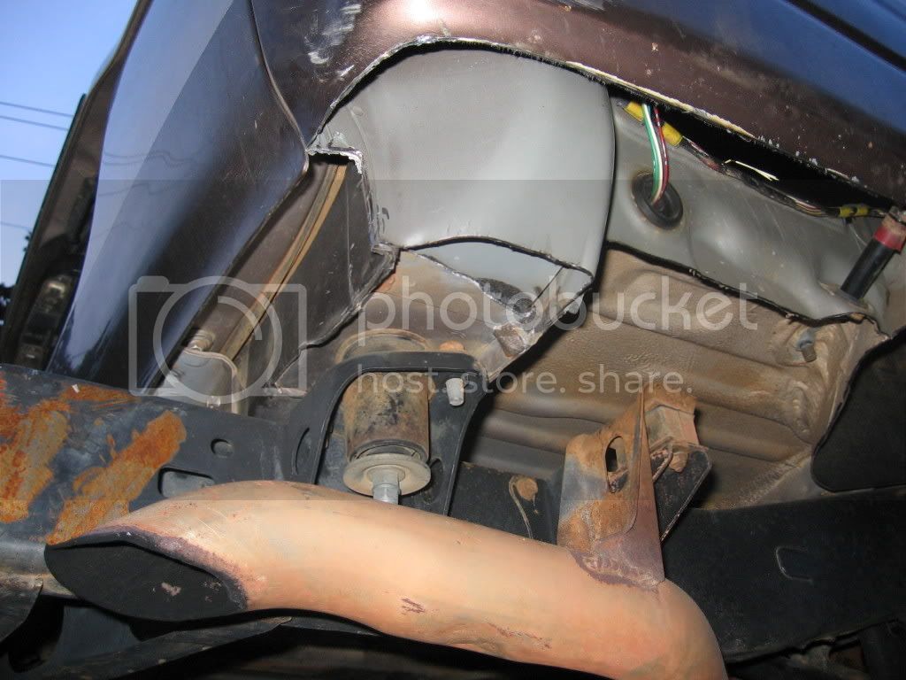

here is where you can really see where the inner panel is tied into the lateral support, but not the outer vetical brace.... if I could trim the outer brace about 2" higher I would be free and clear to do what I need to.
So now since I've heard from Kirk, I think I'll leave the pillar as-is and close up everything like he did and then just use 2x2 tube instead of 2x4 tube for my mini sliders... won't match my current sliders exactly, but close enough I guess.

Not a good idea to connect the body and frame directly with metal. VERY loud noises, vibrations, etc. I've got some sheet metal to weld into the hole. Then just going to rattle can it or something. Thinking of getting really stupid and OD greening all the brown part.... but that's another thread.
