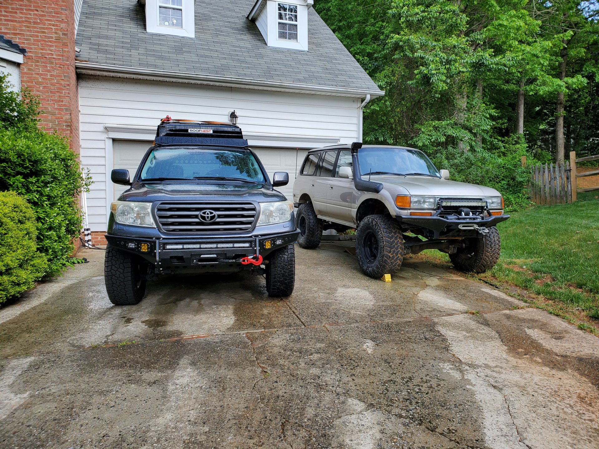

Had to replace the LX470 after a highway rollover -- Rolled the LX - https://forum.ih8mud.com/threads/rolled-the-lx.1264710/
Purchased this 2008 LC200 3 days later (9/28/21) and ordered Dissent front and rear bumpers a week later
I was able to keep my swingouts and just order a new center section - Ben has a VERY well thought out design.
Bumpers finally came in last Tuesday and even with a foot that I couldn't walk on, I was still able to paint and install by myself within a week - If they were powder coated I could have done it all in one day - these bumpers go together like an erector set.
Here's the tally so far:

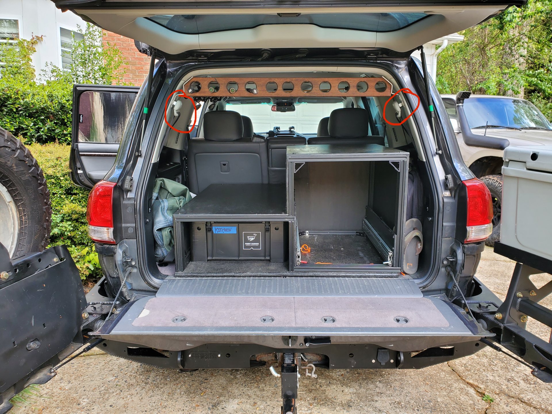

Is that the Dissent aux shelf or some other shelf that fit your RTIC cooler?
I like your idea, here's mine:
I had to make my shelf to fit my Roam box.
Can you tell me more on how you’ve used the 3rd row upper seat belt bolts as supports? Particularly the standoff solution?
TIA
I made the cooler mount... just welded up 2" angle and some flat bar.
I can remove it and fit the 3 jerry can mount and have room for 1 more jerry can.
Probably a super stupid question, but I can't seem to google a simple answer this morning. What is that rail you're using for the RAM mounts?
@saucebox I went with a ram mount RAM-TRACK-EXA-9BU. It's a little longer than the mounting solution you pictured, but it works for me.
