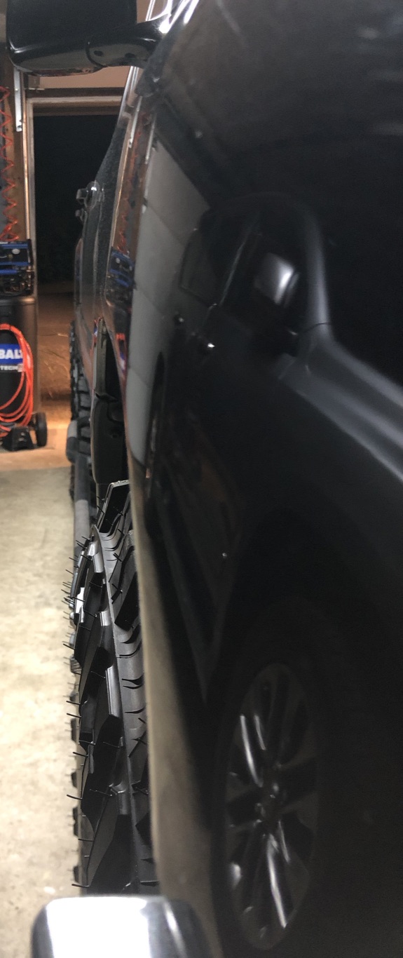

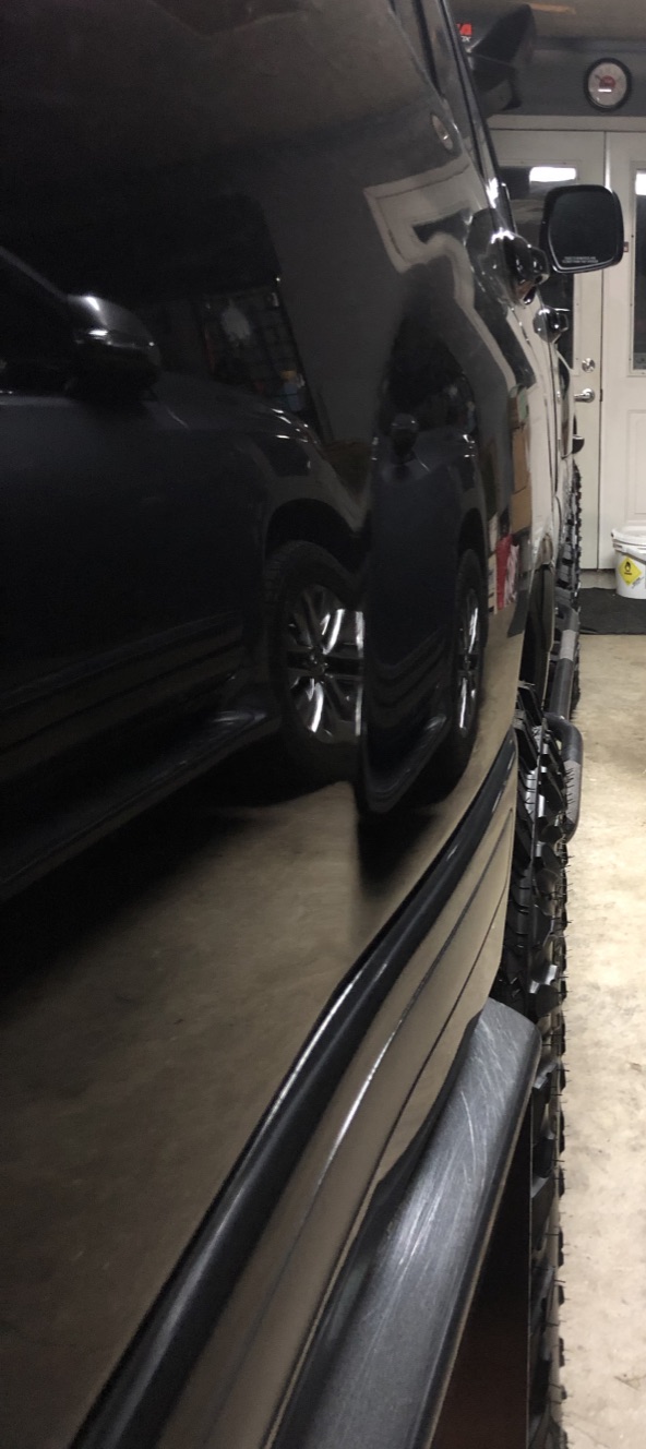

Here are pics of 9" wheel with +25 offset with 295/70-18 MT's- the poke isn't excessive- I don't get a lot of slop on the side of the truck with daily driving
View attachment 2956820View attachment 2956821
oh hell yes .. this was the response I was looking for.
Thank you so much for taking the time to put that together.
Cheers - I owe you
