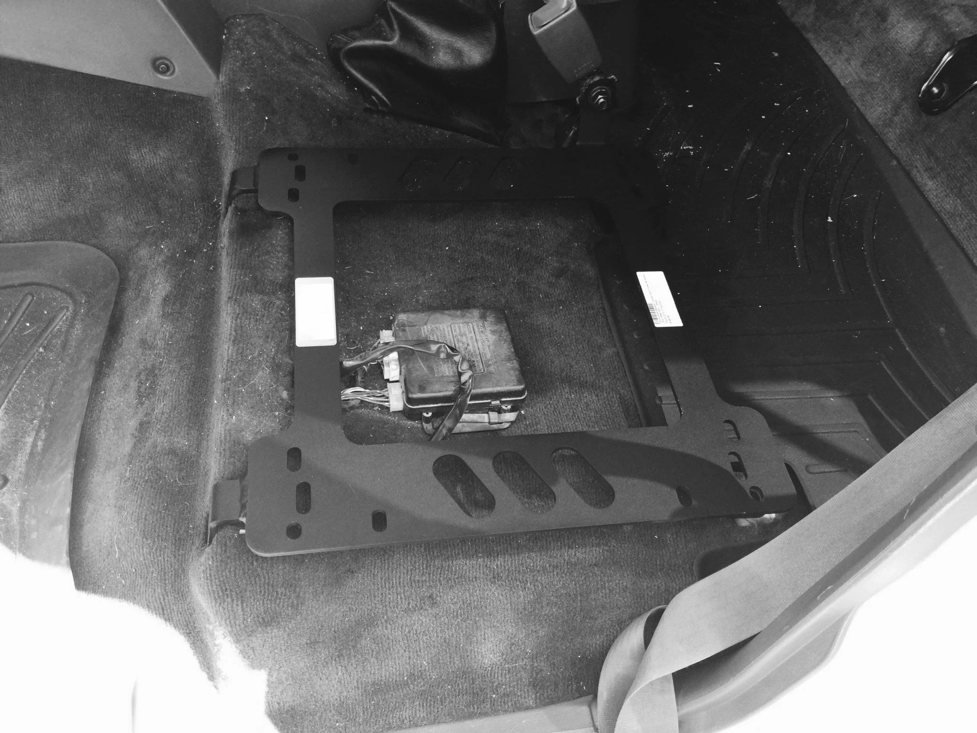

Here is a picture of the bracket we developed for the 80-series. 60-series will be similar looking but obviously with different mounts.
