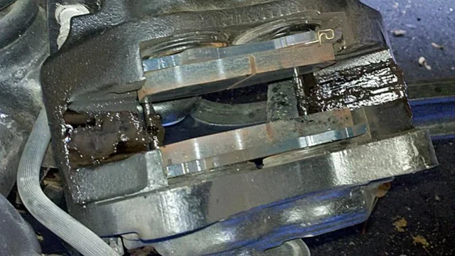

The day the truck arrived the batteries were dead. It took me about an hour to jump it and get it started so I could drive it home. I noticed for a few days that the brake lights would stay on sometimes after I shut it down. I also noticed when I first opened the hood that the battery terminals had gouges in them, so the truck had been jumped before.
It turns out that they forgot to install a brake pedal return spring. The batteries were dead because the brakes, and therefore the brake lights, were on all the time.
Three days later (about the time I figured out the spring was missing) I noticed smoke coming from the driver side wheel well when I got home. The knuckle was puking grease and the brake caliper was covered with it.
I'm pretty sure what happened was the entire hub and knuckle got overheated from the brakes dragging. When I opened it all up to install the manual hubs the grease in there was badly discolored. There was a tiny bit of grease in the differential oil too, so the overheating also pushed grease past the inner axle oil seal as well as where it was coming out through the spindle.
The shop did send me a brake pedal return spring to install.
