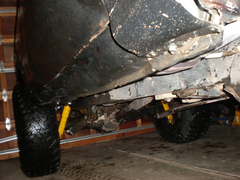

Here is the new Y-pipe they made. You can see how much higher they tucked it in there.

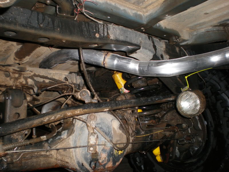

A couple shots of the cat and where it goes over the frame.

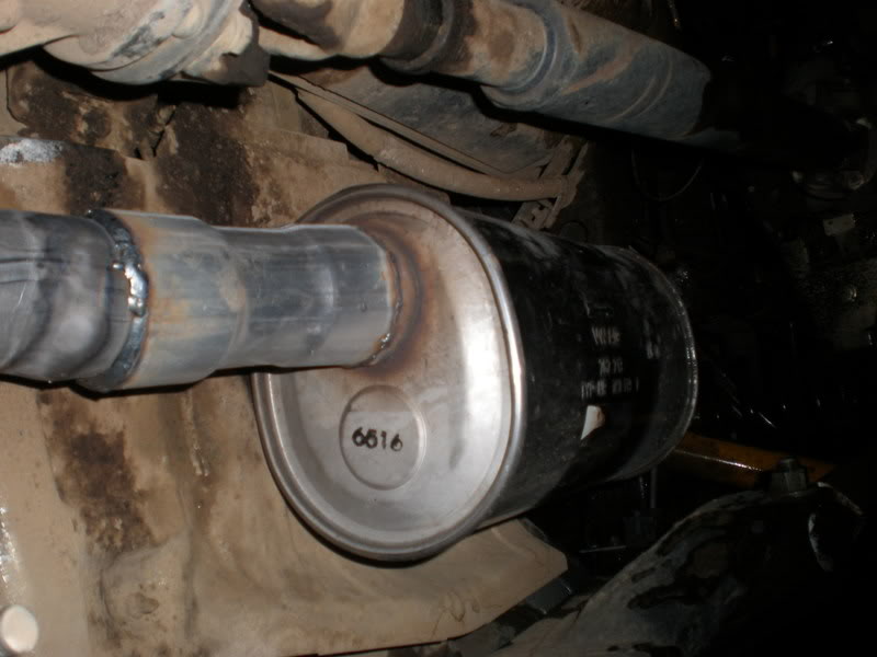

Here is the GTI resonator.
The pipe over the axle.
