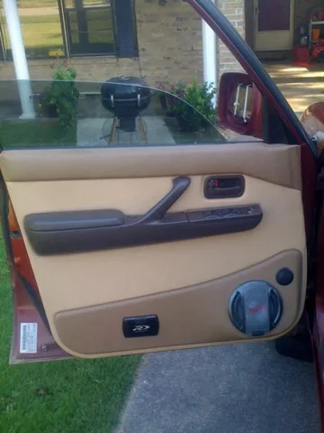

Im very pleased with the finished product. Material is leather feel vinyl and molded fiberglass and mdf for the speaker pod. My seats will be covered with the same material and I will post pics of those soon.
Nice job! How did you attach them to the original door panels?

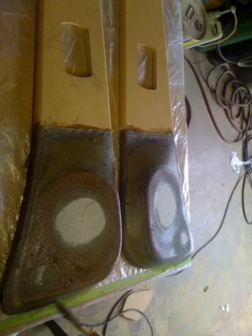

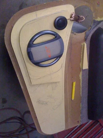

The pods were connected using screws from the back of the original panel. I used new 1/4 inch foam on everything but the speaker pod. The pod was smoothed with body filler, sanded, and then stretched with new vinyl. The door was lined, both inside and out, with fat cat sound deadening. Its truly amazing the difference a bit of sound mat will make.
