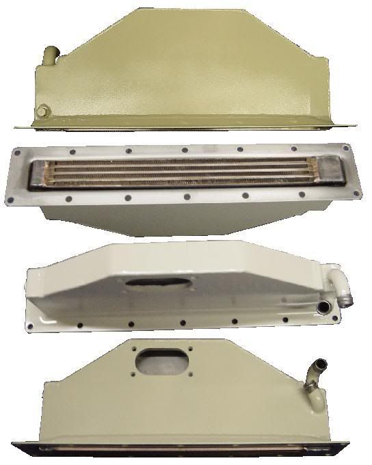

Yeah, it came stock on the 4BTA. I think Cummins sells two different versions of the 4BTA. One with the JWAC and one using an air-air intercooler. Scroll up and you can see how a 6BT one looks like.
ya I was just looking for aftermarket or NOS products.
My 6BT is out of a 91, so apparently its got slightly bigger injectors then the next couple years, but no intercooler.
I see there is a few at the alibaba site: http://www.alibaba.com/product-gs/339777984/Cummins_parts_water_after_cooler_jacket.html
Water after cooler jacket 6BT Cummins parts - Detailed info for Water after cooler jacket 6BT Cummins parts,Water after cooler jacket,Water after cooler jacket 6BT Cummins parts,6BT on Alibaba.com
It would be a nice upgrade for the 6BT.

Also, the downside to you retrofitting a Cummins style JWAC is that you'd have to get new fuel lines to route around the Cummins JWAC assembly. With an aftermarket air-water IC, you can use the same intake horn with out any interference with the fuel lines coming from the injection pump.
Check out this site. I bought most of my intercooler parts from them. They sell air/water intercoolers that will be the same (or better) than the Cummins one.
Air to Water Intercooler
Ah crap I didnt even think about the fuel lines, I thought it would be plug and play.
I guess one of the hose places in town should be able to build them but I dont think it would be cheap.
