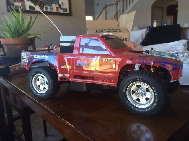

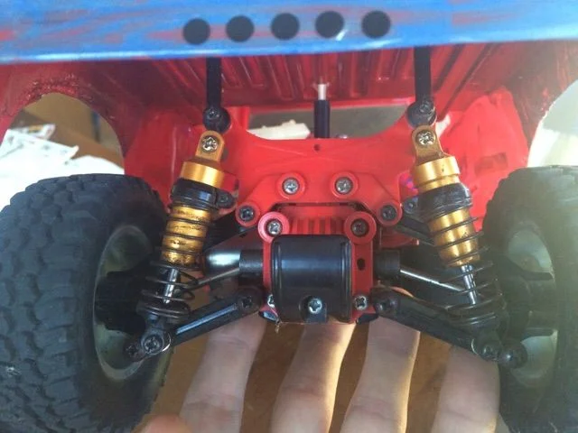

Just got home from 4 days in North Carolina for work and found this on the kitchen table. My dad brought this over today after cleaning out his garage. It was the first "Toyota" I ever bought back in the late 90's. 4WD with oil filled shocks.
This thing was a blast to play around with. However my dad is not find the battery charger for it and I really doubt the battery would even hold a charge anymore.

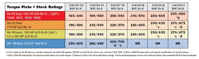

Look at what the difference would be if you put in the same #10 fuel plate I used in your pump. Scary power!
If I put a #10 plate on I am going to first have to change out the turbo to let it breath through all that fuel. I am already planning on replacing the input shaft on the NV4500 with a southbend 1 3/8 shaft. Haven't decided on the clutch yet, but it will be a southbound. My only concern with creating too much power is the torque...I don't want to start snapping axles.

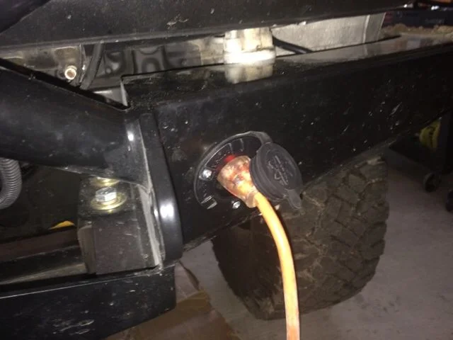

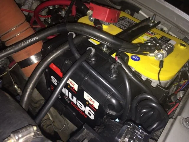

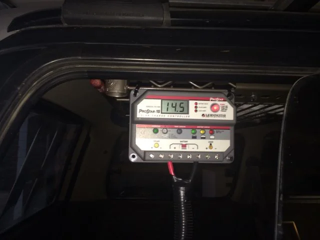

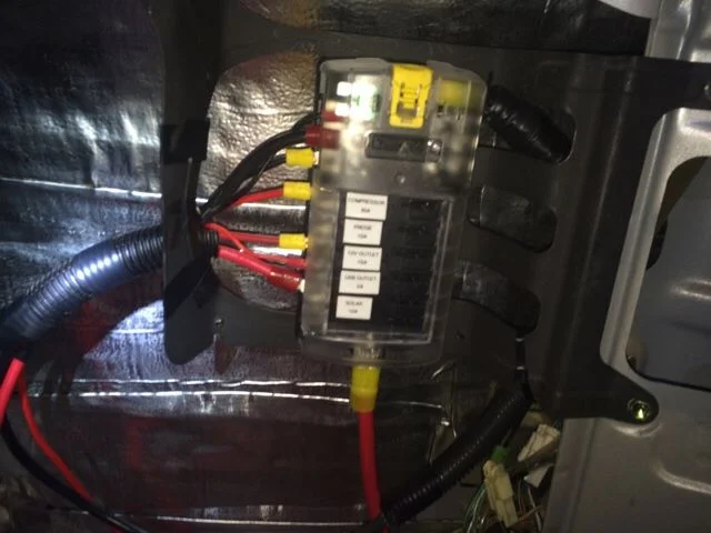

Rear fuse panel, on board battery charger, solar controller all finished up this afternoon. The fridge now can be left running full time if I needed. Also added plug outlets in the front bumper for the battery charger and block heater. The Slee bumper was fun to drill 2" holes in.

It was my last full day to prep the truck due to work for Big Bend. I still need to check fluid levels and rotate tires so hopefully I can get those done before i fly out to California for work on Wednesday.
I like that charger, I've had one sitting on the shelf for a while now just waiting for me to install it. Same for the plug, I'm putting two up front; one for the charger, and one for the engine and transmission pad heaters.
What brand of solar panels did you go with?
Still haven't deceded on a panel. I probably will go with a regular 100w and put on the roof rack but I have also thought of getting the slim flexible kind to mount flush on the hood.
