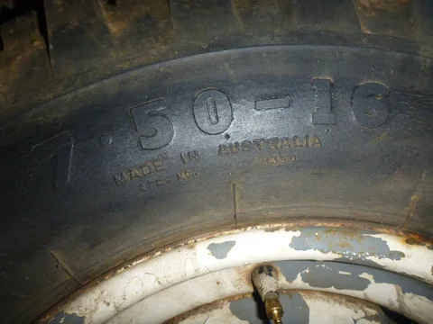

cult are your roadtrak majors made in Australia or japan, a couple of observations of mine the Japanese rtm seen to have had better rubber and aussie made rtms have a bit bigger lugs. I like the more classic looking Australian logo
Japanese
Australian
Jeez you've got me there mate. I'll take a look-see when I swing by the truck today. Previously Aussie25 and a few others had warned me against running old tyres. When you say 'old tyres' do you mean like the ones in catskinner's pics? Cause my RTM's are about 30 years newer than those. No cracks.
