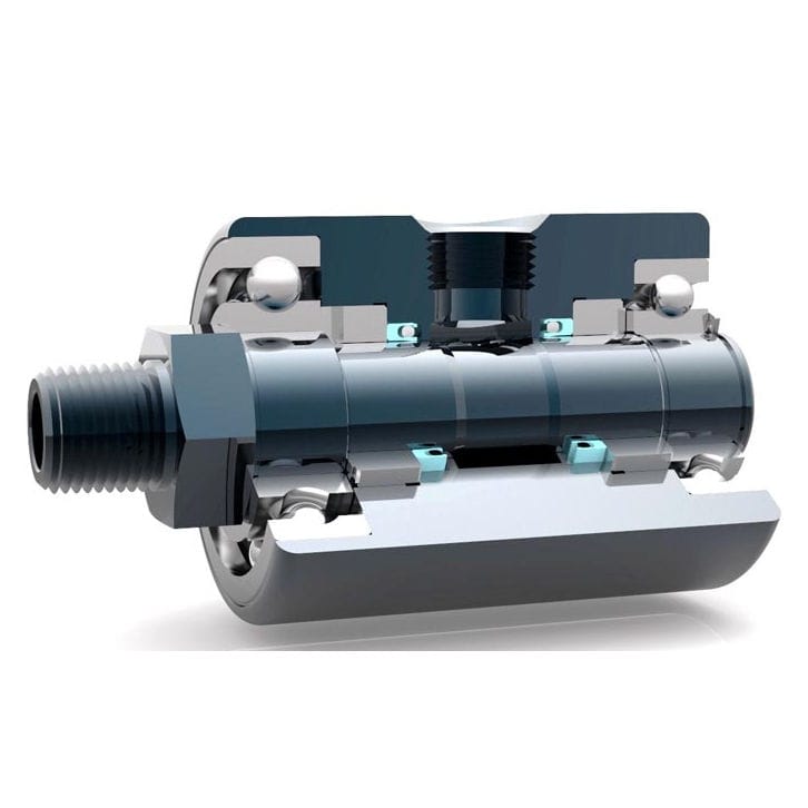

As far as I know, the only doable solution is to mount portal axles to our Toyotas to be able to go full time internal CTIS (without lines running outside of the truck).
Seems rather sad.
So looking at this and the axle cross section got me thinking. It should be somewhat possible to drill an air hole through the axle's knuckle body right ,,into'' the axle seal, remove the seal altogether and machine a new double seal with an air hole, drill a hole right through the axle direct perpendicular to it and then another one in it's length from that point, so we'd create a rotary union and thus got air into the birfield joint; drill the birfield sub axle in its full length and have some high quality air line going through it right out into the wheel center, through an L coupling and into the wheel.
There should be plenty of material to keep the strength as the axle shaft is thicker at the axle seal (where the perpendicular air hole would go) and a small (3-4mm) hole in the very center shouldn't affect rotational strength very much. Question is if the birfield sub axle wouldn't get too weak with a bit thicker hole through it (3-4mm plus 1-2mm for the tube) but then again it's the center, most of the force is at the surface.
Another question is if any air tube would be durable enough to sustain being bent in the birfield joint while being in a fast rotation (on a highway).
Sort of possible or totally out of question?

Oh well, .. there's also the truckers who use it I guess quite without trouble, former soviet mil vehicles had it figured sort of trouble free as well as tatra. All in all it's not about ,,why to do it'' but ,,if it'd work'' :)
And as you said, there are plenty of times it just doesn't pay off to air down/up just for the small part of what-the-heck, but it damn would if there's nothing else than a button push from achieving that.
If the system was fairly doable, not overcomplicated and not extremely expensive and street use prohibitive (= portal axles), it would be useful to some. OBA itself is a good thing all in all (I guess all agree to that) and to have this bonus with it.. heck, why not.
I'm sure it's possible and could be done similar to the ARB diff setup. However, you just listed all of the things it would be. Doable, but overly complicated, and terribly expensive.
