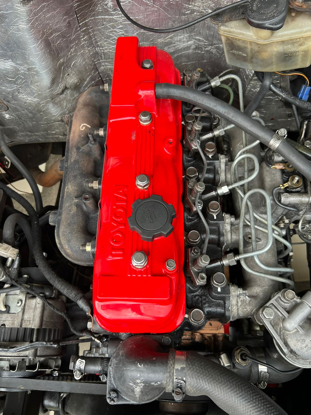

Hi guys, I've been thinking on adding a turbo onto my NA 13B.
I got an OEM turbo from my 1HDT (CT26). The idea is to fabricate the turbo manifold from zero but I am uncertain if this turbo is a good fit.
What do you guys think?
Another option is a turbo out of a ZD30 (which I have to purchase) that I think will spool faster???
The 13B-T came with a CT26, as did the 14B-T and 15B-T (but not 15B-FT). So yes, they are matched.
Alright. I think there are several versions of the CT26 so I was uncertain if using one out of a 1HDT would work.

The ct26 will work, but it’s too big and will be laggy for a 3b. Toyota used the same ct26 on the 12ht as the 13bt…it’s too big for the 13bt…and 3b. There are better options but I suppose it’s all about budget.
Note that CT26s are different for various OEM applications. Like different turbine housings with different A/R. 1HDT one is probably NOT what you want for a smaller displacement engine. Find one from a 13BT if that is what you're putting it on.
But as said, you'll be much happier with a modern and proper sized turbo anyhow. I hear TD04L-13T is nice on 3B/13B. You can get them off Subaru WRX engines (those guys upgrade).
The 13bt ct26 is the same as the 12ht one, too big and slow/laggy.

Ah, okay. So maybe the turbine housing is the same for 12ht/13bt. I'm pretty certain 1hdt turbine housing is larger though....
The turbine housing on a 1HD-T, (and I think 1HD-FT), 14B-T and 15B-T have '58020' cast in (interestingly, 58xxx denotes a B Engine component) which makes sense as the 14B-T was launched a year before the 1HD. The 13B-T would be -58010 and was the same, it seems as the 12H-T. I was not aware that there was a difference in the performance of the two turbochargers, but it makes sense.
There are about 3 different CT26 (single entry) turbine housing sizes. But they're still housing a paddle wheel so it's only a minor difference.
