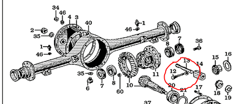

Also getting to experience the 'fun' that it seems others have also enjoyed... All summed up in one photo. Anyone know what this is?

Bolt that failed the QA test
Broken bolt:doh:
Its a broken Differential Shaft Pin.
fj-diff-pic-png.689070
AKA the pin that holds together the rear differential and prevents you from accessing the c-clips to remove the rear axles.
Time to get creative. Thank goodness for the forum and the pioneers that have been there, done that, bought the t-shirt.

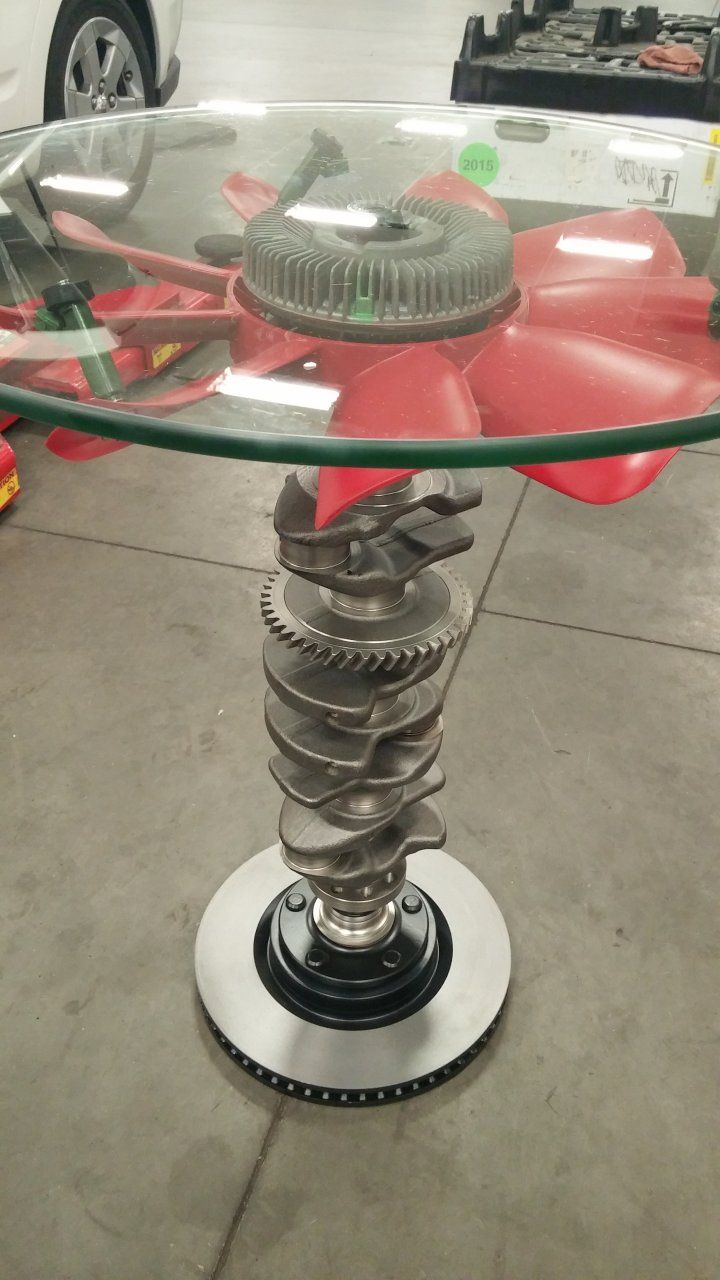

One of my techs made this for his man cave. The parts are all clear coated and the glass top spins ~ I like it!
Could use a brass Pole on that table .... lol
