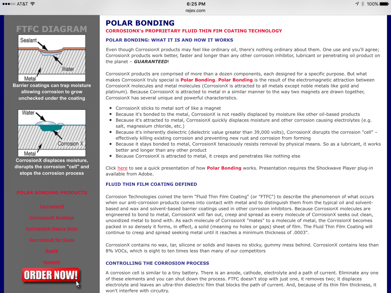

It's supposed to bond with metal, bare or rusted and displaces any moisture as creeps, even vertically, and that's its claim to fame. I won't say it's better than X Y or Z, but this stuff works and I'm sold on it. After 5 years in the rust belt my undercarriage looks the same as it did when started this thread. I'll take some pictures in the morning, I re-applied a few weeks ago for the first time in over a year. I use their Rejex product on my truck and boat as well, that stuff is amazing too. It's like rainx for any non porous surface, wipe on wipe off. It's all about the polar bonding I guess. Like I said, it works for me and I'm sticking with it.
CorrosionX Polar Bonding technnology
