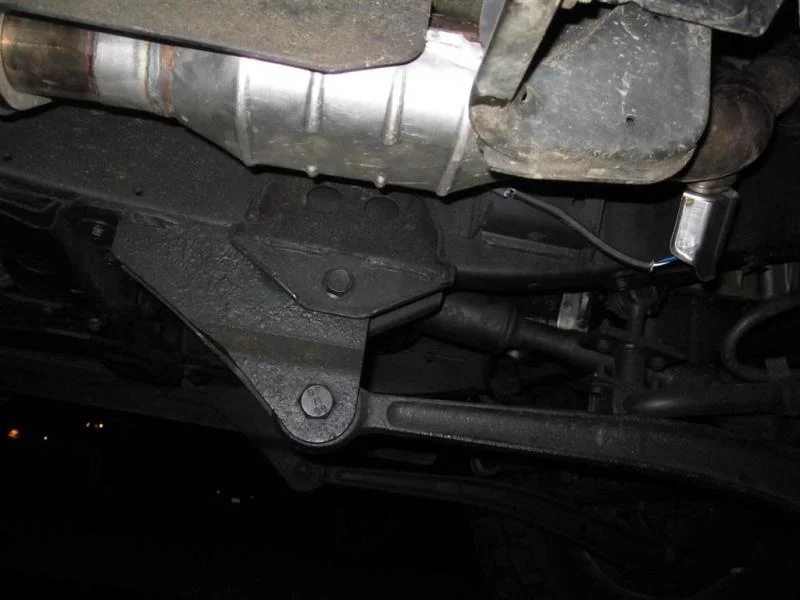

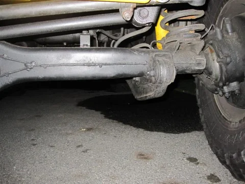

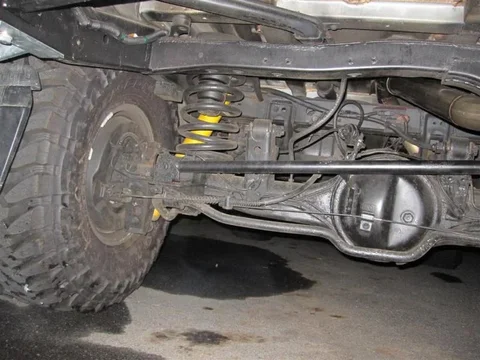

I fogged it again in November and March as well. Out of a gallon I have about half left after four applications. Well worth the effort I think, the whole gallon was only $80. It was the 15 hours of grinding and painting that was the real work, fogging only takes about an hour each time. My only regret is that i didn't cover the truck when i did it and had to clay bar and polish off all the overspray:bang:

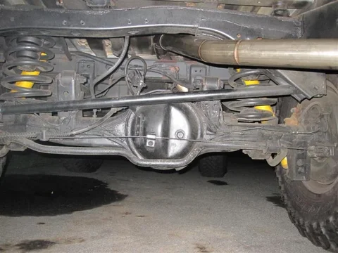

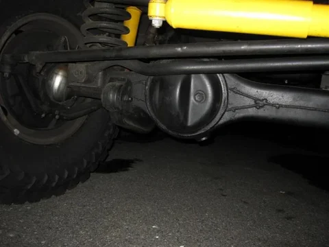

A few more

Nice...that looks great still! Thanks for the pics!
And sorry if you talked about this earlier in the thread, but what is "fogging" other than what sounds like reapplication of the treatment?
What exhaust is that you've got on there?

By using the engine cleaning gun with compressed air, it picks up the corrosion-x and creates a fine mist or "fog". The nice thing is it carries the product into the frame rails and hard to reach spots.
The exhaust is the new EMS exhaust (many threads on it) and has only been on for a week or so. I'm waiting until i have some more time to post a thread on the install and my thoughts on it. So far its pretty nice, a bit louder as advertised but i really like it. What i like the most is that its the last exhaust i will need to buy due to the fact its stainless;)
