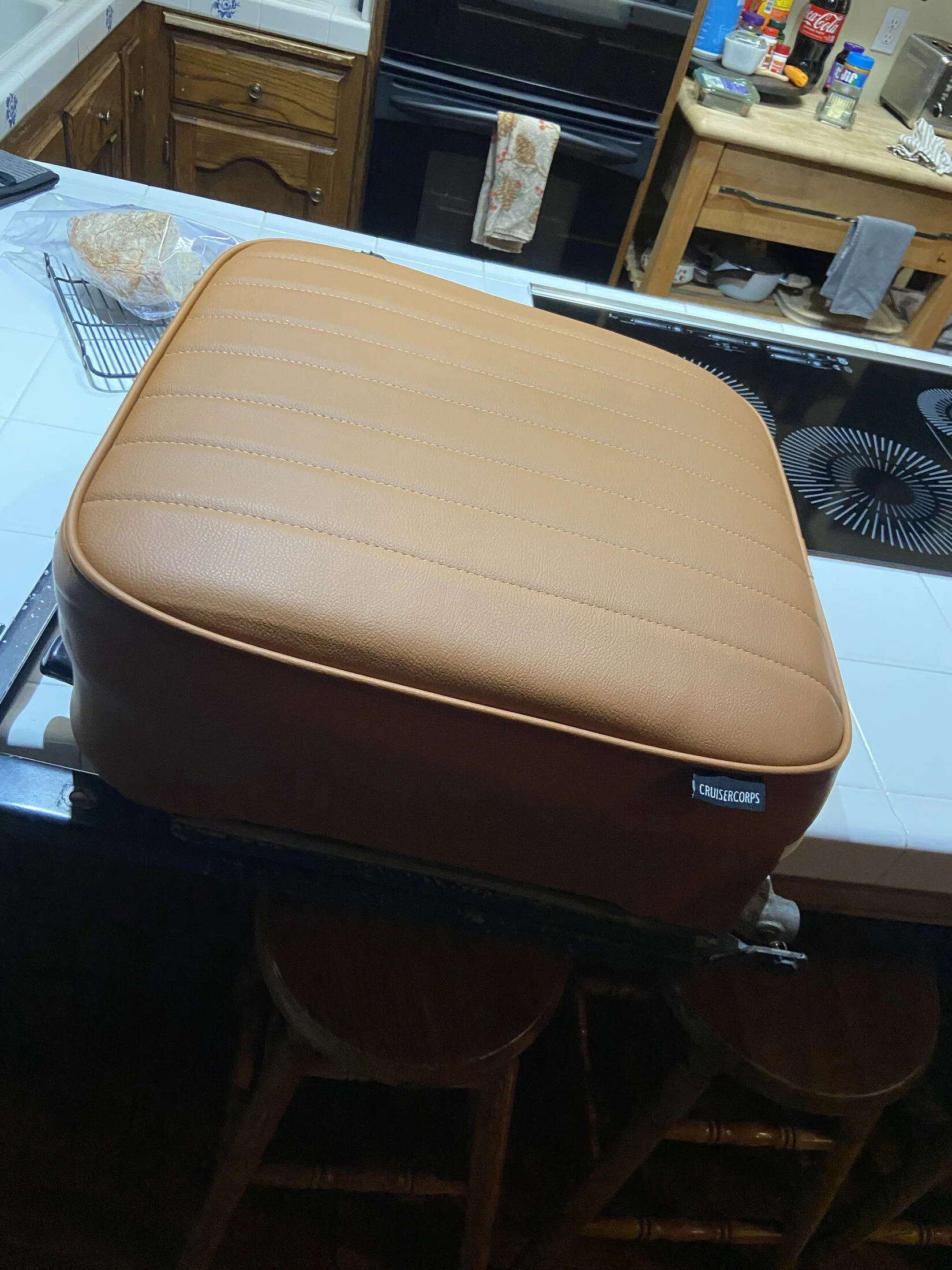

I used their rear seat covers last year. I tried using what I thought was the original horsehair padding and they didn’t fit at all. So much so the I thought they somehow sent wrong ones.
I bought foam kits from Spector and then they fit fine. Literally no skill involved (I have none) and just a JIS tip screwdriver is all you need.
I would get the straps to hold the seat bottoms up while you’re doing them though.

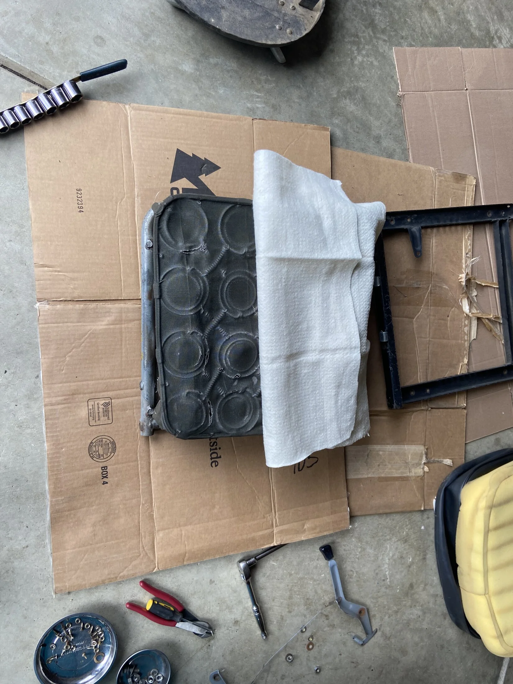

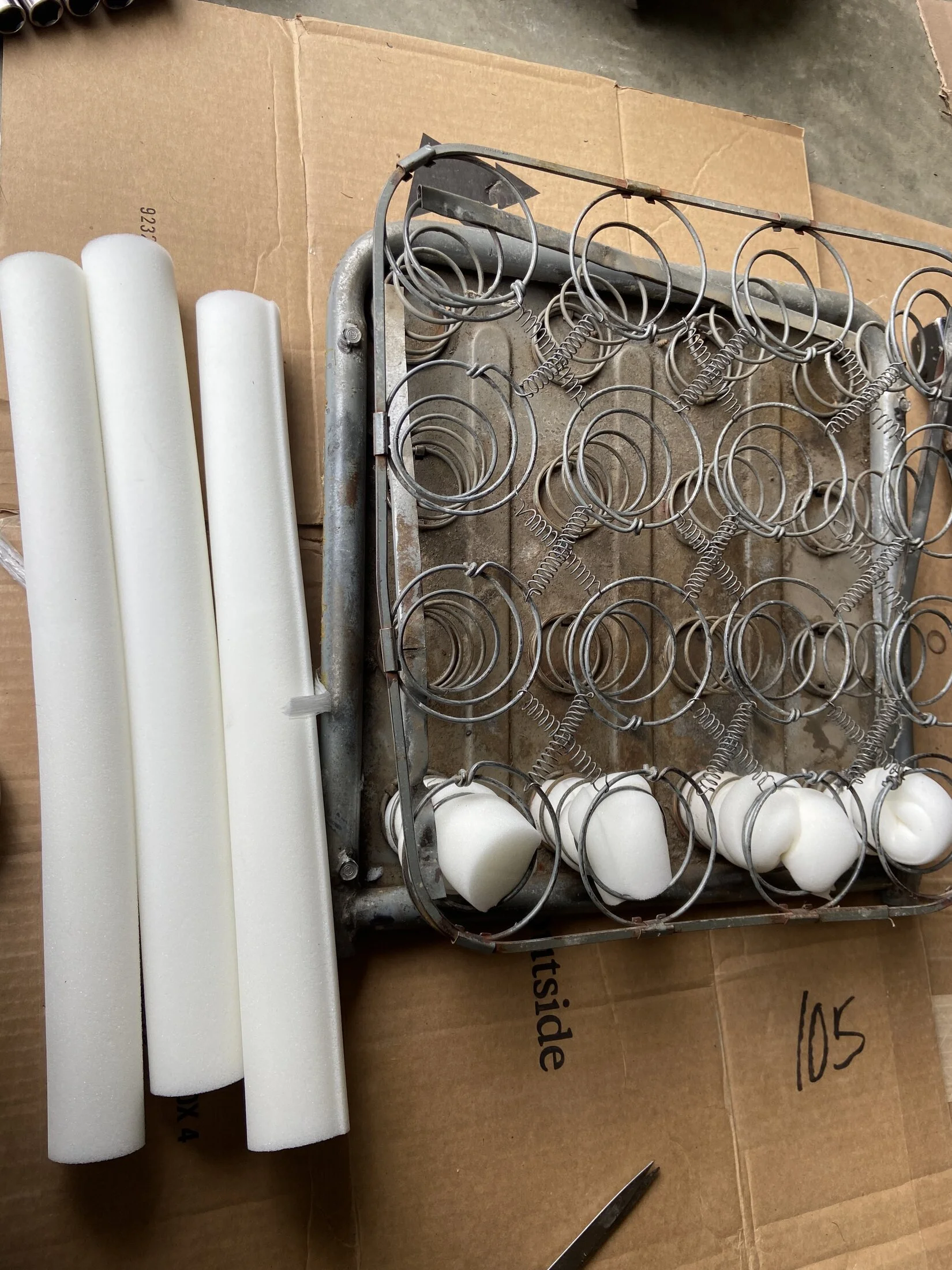

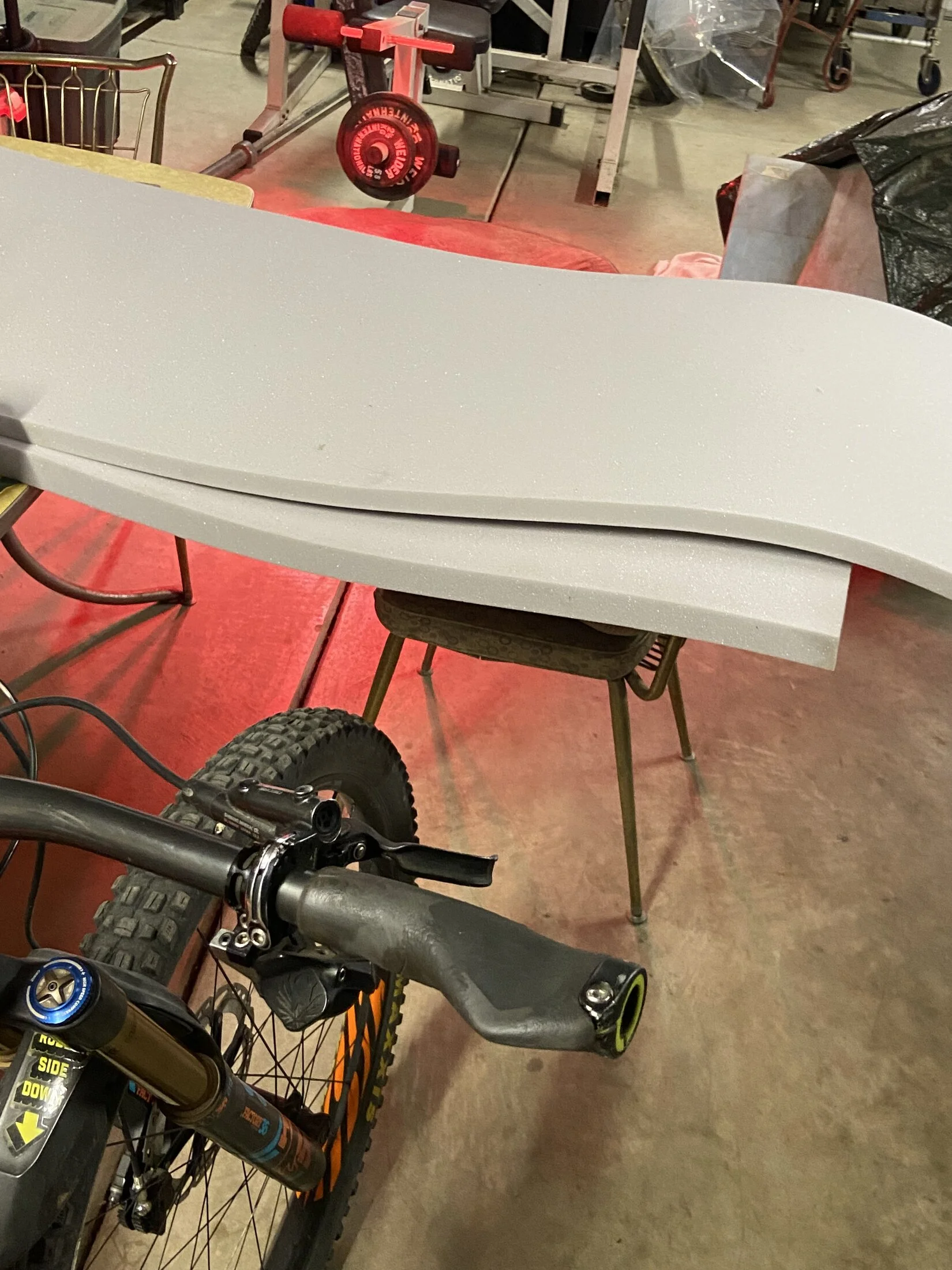

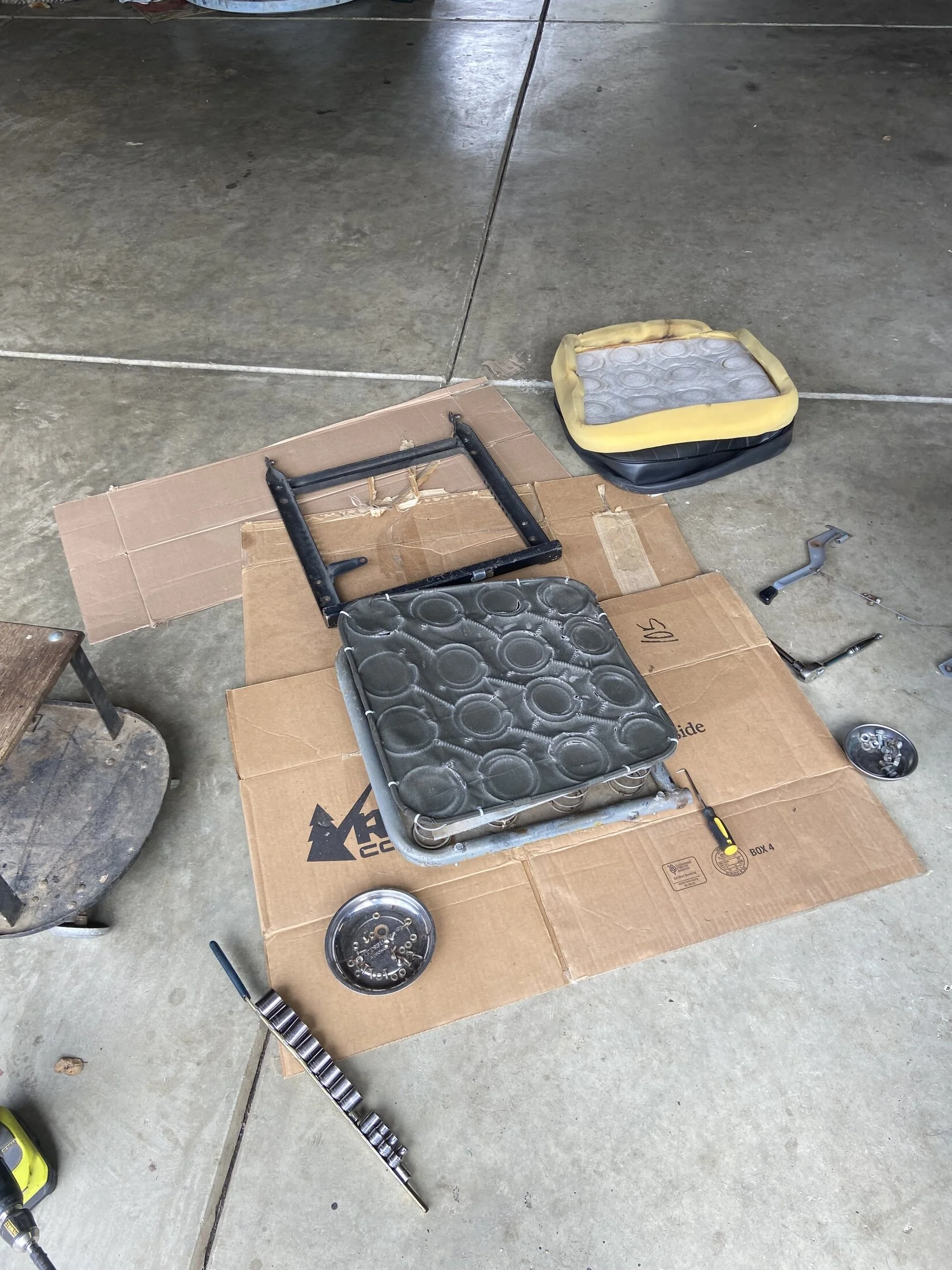

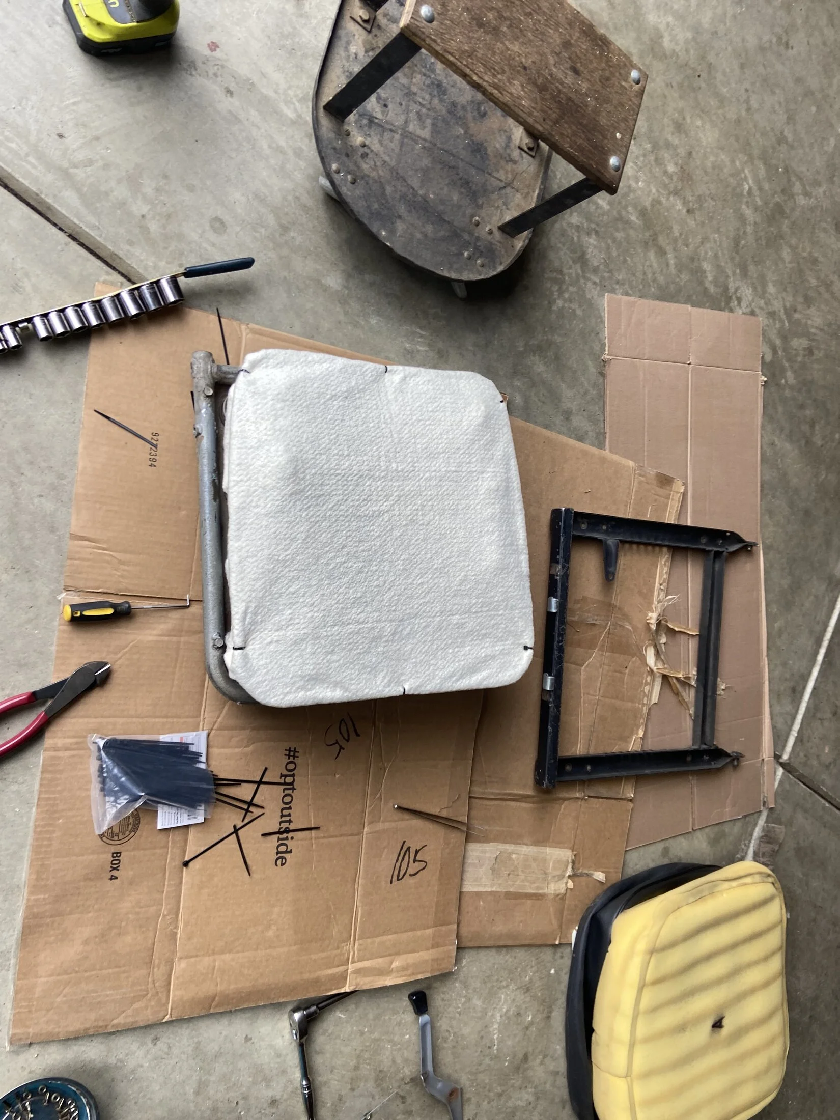

I just started my seats today. Bought some 1”, 2” and cylindrical foam from the Foam factory. The springs in my driver’s seat are pretty shot so I put the cylindrical foam in the springs and also ran a piece of the 2” foam between the springs for support. I used a 17”x16” piece of foam on top of the 15 year old SOR seat foam. It’s now nice and firm and doesn’t collapse.
Will reinstall the driver’s seat tomorrow and work on the passenger bench seat. The Cruiser Corps seat covers are much thicker than the SOR ones, and those lasted 15 years. Fit seems to be good. The upper seat back was pretty shot too. I used some safety wire to fix two of the springs then put a couple layers of the 2” foam in the void between the springs and the metal rear plate.

My springs are super weak. At 200lbs I easily bottom out on the seat pan.

I’m about the same weight and was bouncing off the bottom plate. This foam is fairly dense and I cut two pieces of the 2” foam, 3.5” high and about 17” long. I threaded them between the springs from front to back on the 2 outer rows (under my arse). Will let you know tomorrow how it drives.
