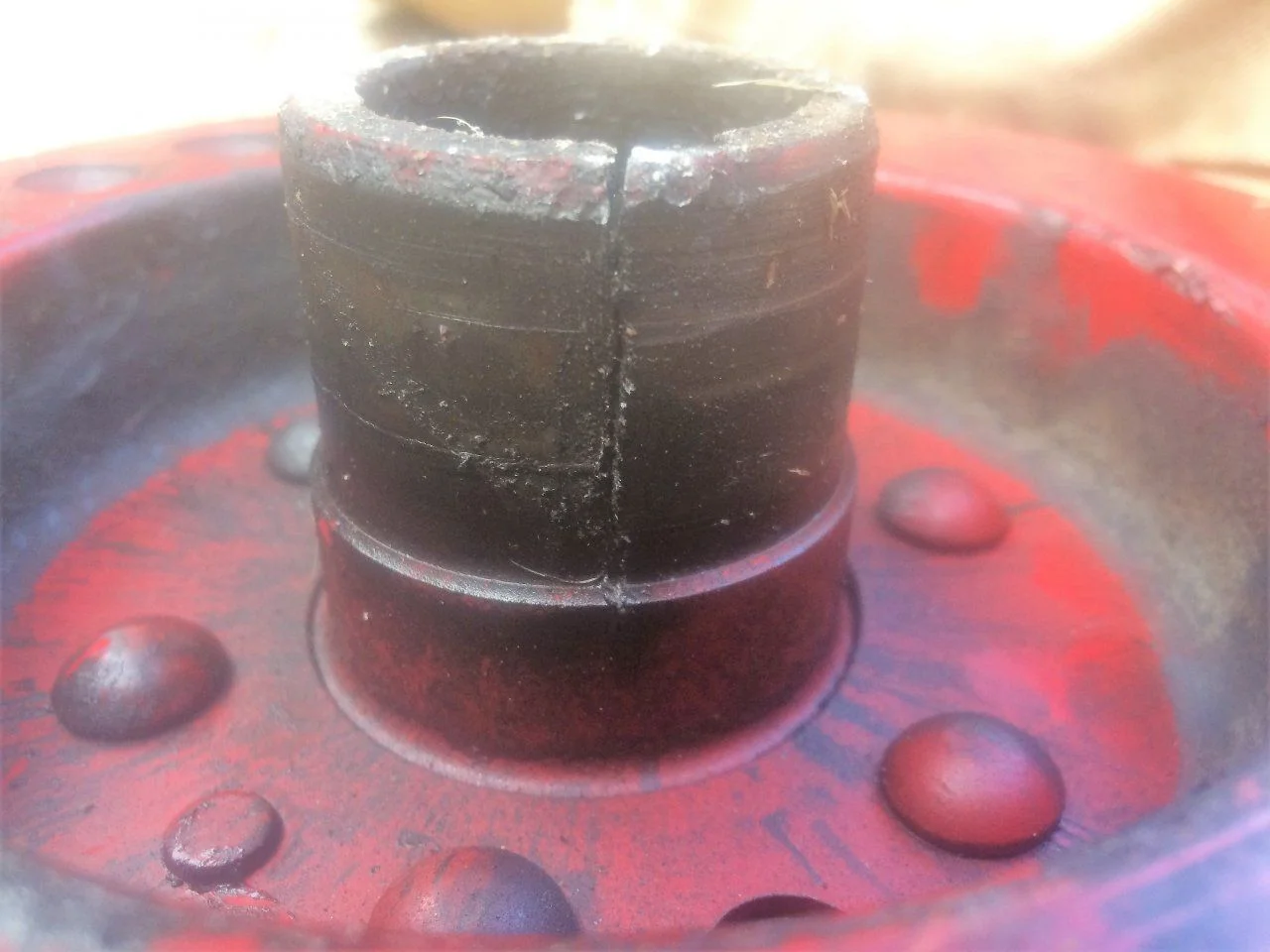

I took a photo of the old HB. I didn't notice the split the first time I inspected it. The key way slot on the inside wasn't that messed up but that's a nasty split. I'm glad I got a replacement.

Holy canoli! that is crazy! How long was it wobbling before you turned the key off? And is that split lined up along the backside of one edge of the slot? So if thats the case, there is quite a lot of force on that end of the crank shaft...
The split is lined up along the backside of key way slot. Well, that's a challenging question. (How long was it wobbling before I turned the key off?) The nut was off of the shaft for about 3 years. I don't know if during that time the HB slowly worked it way off the shaft or if the HB got to a certain point on the shaft that caused the thing to crack. I was pulling into a parts store, to get a part for my daily driver when I lost my power steering. I popped the hood and noticed the belt was very loose. I went in, bought the part I needed, got in my 60 and cranked it. I heard this awful noise as it cranked and immediately cut it off. Got out again for a closer look and noticed the HB was barely hanging on. I didn't notice the split until I cleaned most of the grease off of the HB. I now have an expensive paper weight. (I might use it to weigh down one of my ham radio dipole antennas.)
Wha?! How did I miss that? Holy sheet. Okay so this proves my theory that IF my repair goes south, my HB will NOT simply walk off the crank and fly across the street and hit an opposing vehicle (as a welder of 46 years stated to me regarding his liability of taking on my request; he chose to never respond to me after also stating what I wanted him to do was what got his "nut" since most would simply refuse)! Ack! James, wow, amazing, seriously simply amazing. Thank you so much for that info. Seems my intuition is darn good in mechanics, regardless how amateur I am....
How was it that you had no nut for 3 years anyway? Did it just go missing and it appeared all okay dokey the times you eyed it?
Hits from the bong.
I found the nut in my backyard about 3 years ago. I thought it was off of my 60. I had a parts 60 at the time and I thought it may have come off of that one. But the nut was powder coated black. That meant it didn't come from the parts truck. I looked all over my 60. But with the "skid" plate in place under the radiator I couldn't see the crank shaft and, honestly, I never thought I needed to. But since I knew that nut came from my 60 I placed it on a shelf thinking, "One day I'll find out where this goes." That day came about 2 months ago.

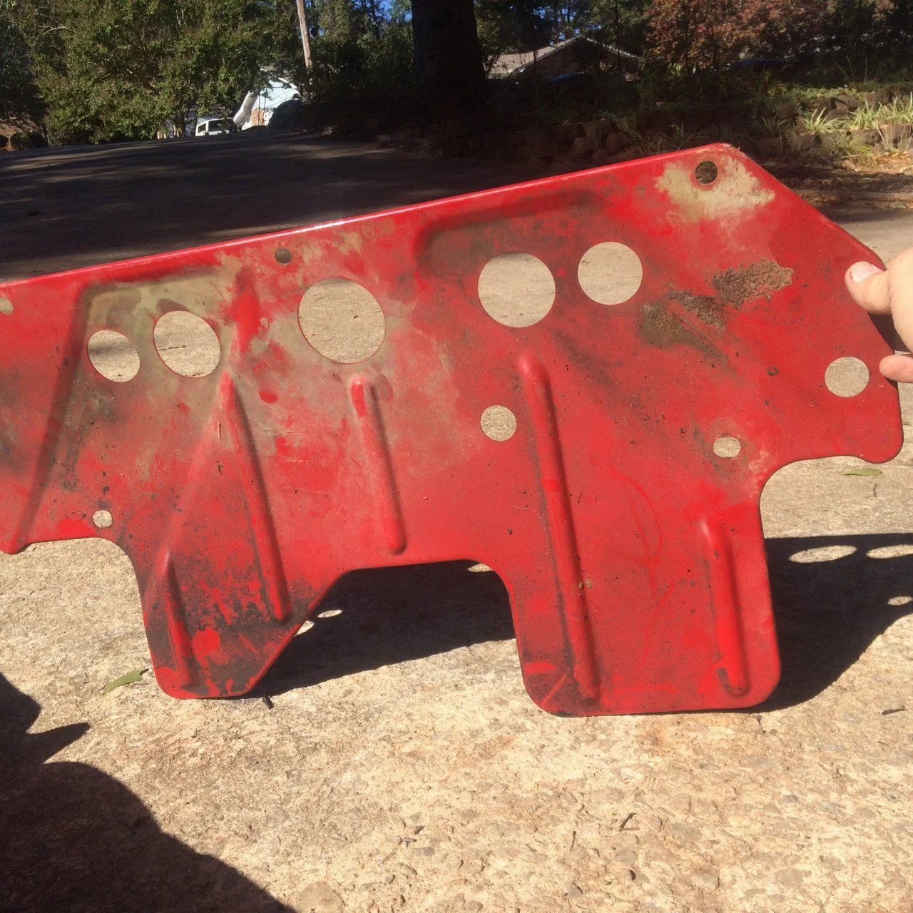

I use the term loosely. It's more like a rock shield. I'll take a photo tomorrow.

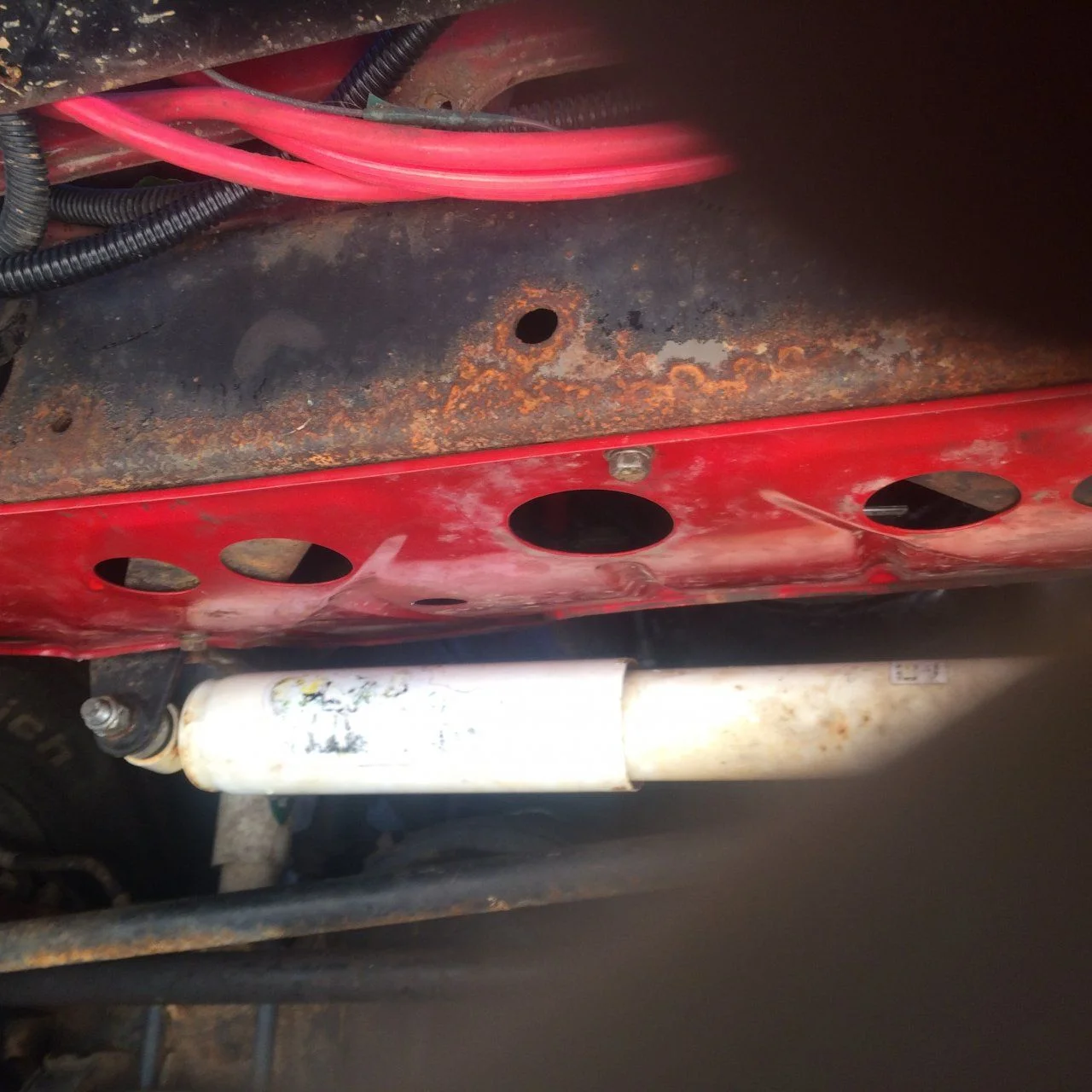

On a different note... I took a couple of pics of the skid plate/rock guard prior to and after installation. NeverGiveUpYota wanted to see what it looked like. Based on her comment, she may not have one.
I knew it wasn't a true skid plate but I wasn't sure of the proper name. Thanks.
