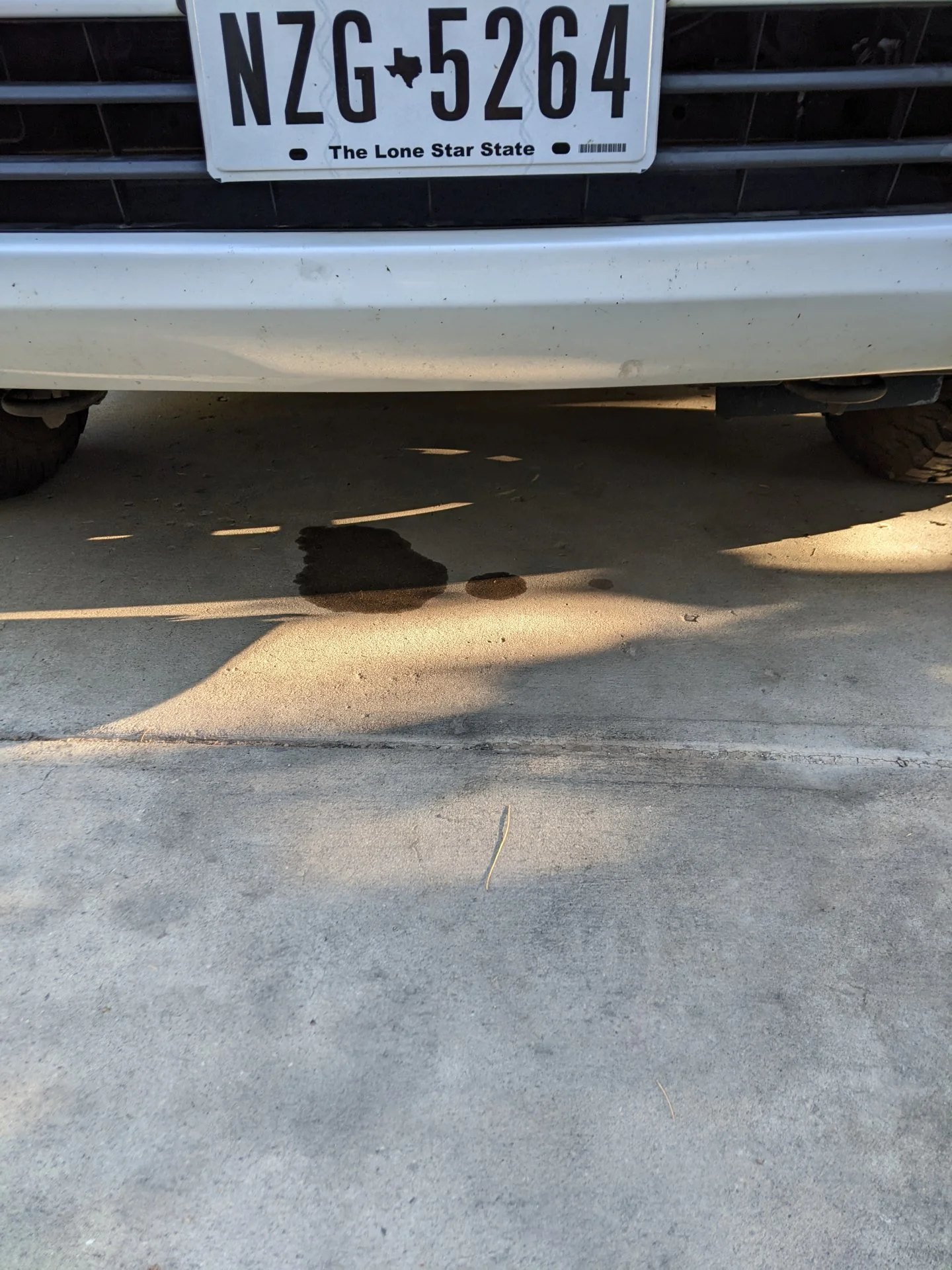

Cracked radiator

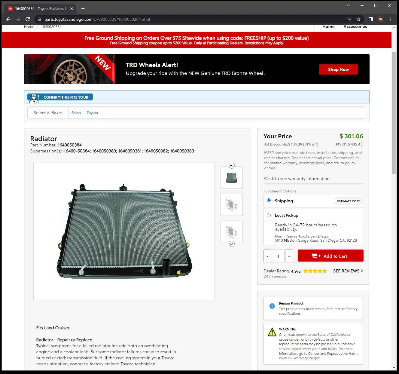

I'm in the same boat 210k lx570 2010 pink explosion and today all the dealer pages show the radiator is remanufactured.
I called a couple Toyota dealers who confirmed this is the part and they don't know why it says reman either. Best price I saw is $301 free shipping from San Diego.

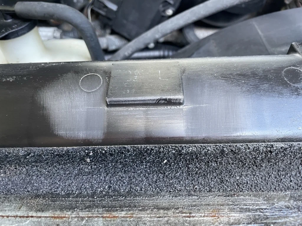

Wouldn't you know it the new 'remanufactured?' radiator is leaking from the lower part of the rear seam of the top tank.
My mechanic noticed the leak when he was looking for a "grinding" metal hitting metal noise, which may be timing chain slap. I did a short term fix, and have since received a replacement radiator. I am in the process of ordering new water pump, hoses, thermostat housing, serpentine belt and tensioner in order to get it all done while in there.
I marked one of the photos with a red smudge on the left of the patch to show where a small seep had started again after patching. Mental note, if need to do again, allow larger overlap of patch material.
