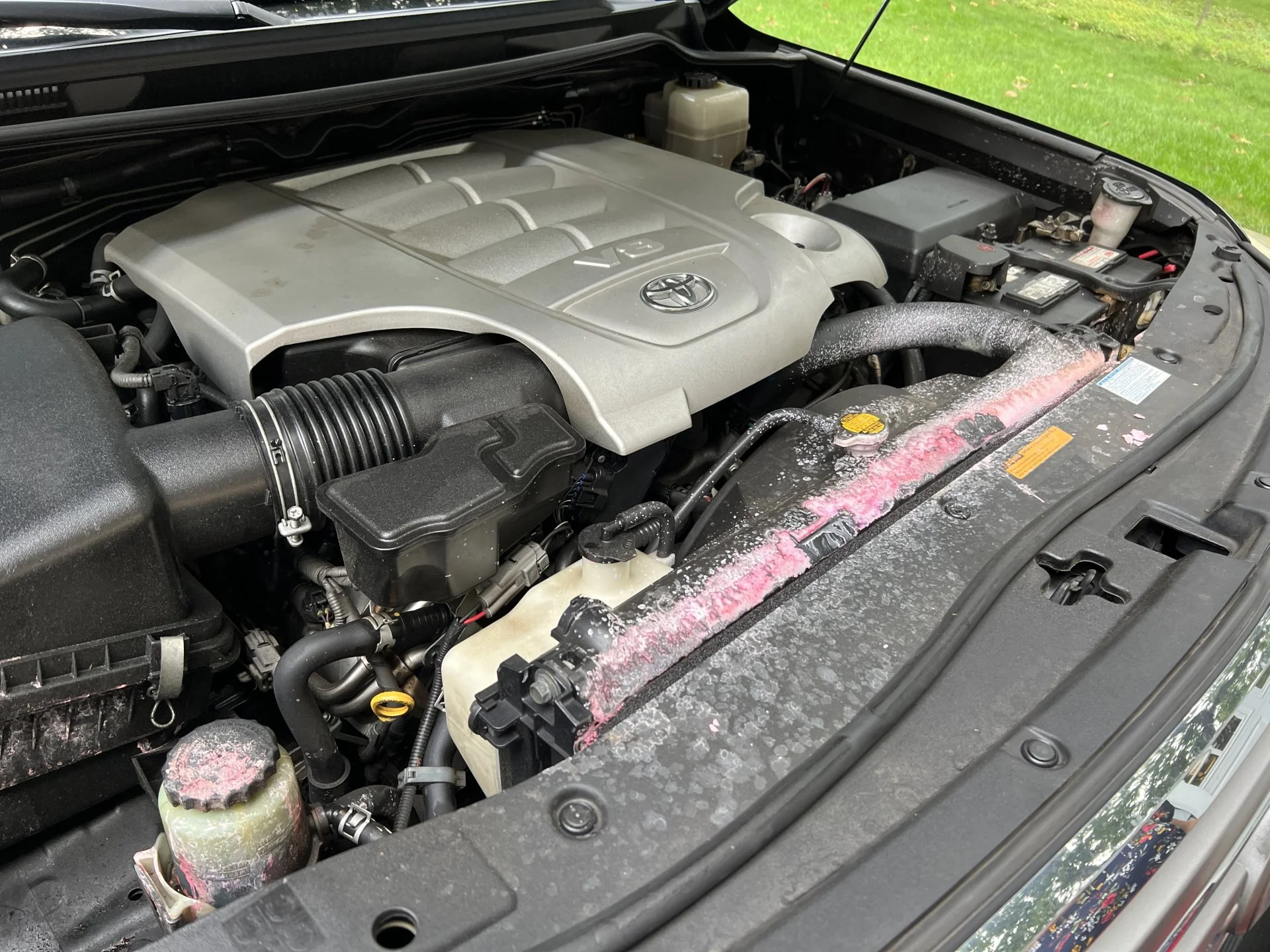

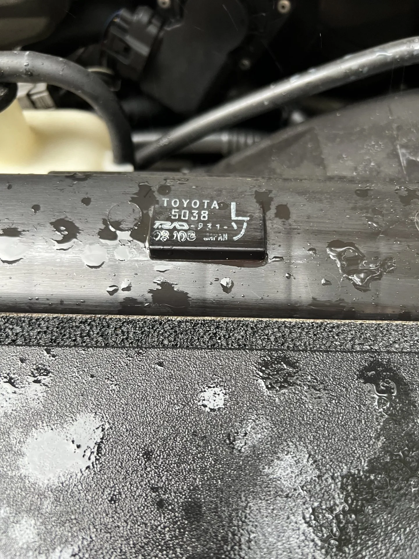

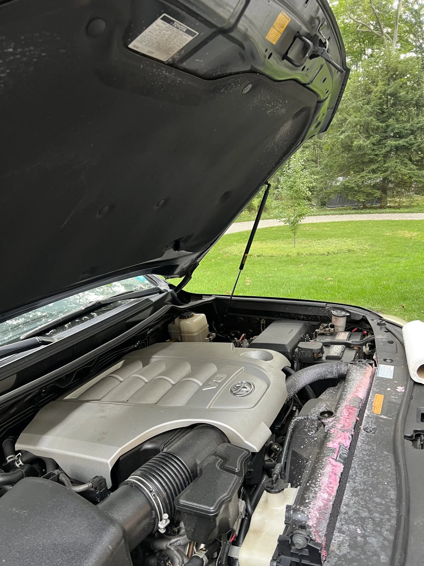

I have a 2013 with about 150k and just noticed a puddle in the driveway. Popped the hood and found coolant everywhere! Cleaned that up and started the truck to find a crack in the top of the radiator near the raised label plate…just had this truck at the dealership for new tires and an oil change too. So bummed, searched mud immediately and looks like I’m not the first to have a crack in the same spot either. Hard to see in the pic but it’s just where the label plate starts to rise up…anyone get a quote for a new radiator recently?
right here there’s a hairline crack, it leaks when running.
Unfortunately your right on schedule for this failure. Online price for new OEM radiator is about $400. It isn’t too hard to replace yourself if you are inclined. There are also a lot of “while your in there” opportunities too. t least replace your hoses too now.

I’ve never seen on for a 200 but that doesn’t mean it doesn’t exist. Personally I don’t see a need for that. The new OEM radiator fixes the stress riser that caused your failure.

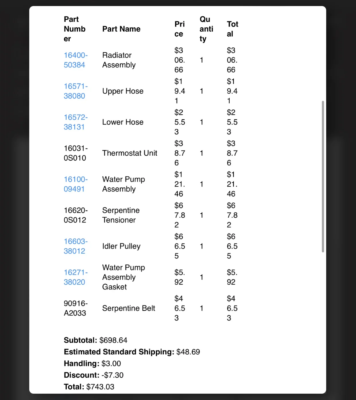

I feel like I have seen it before, but couldnt find it right now. Maybe someone can link me. What's the part list for the OEM hoses and radiator? Anything else you should swap while in there? I'm at 75k miles.
Post 905 is what I replaced when I did the radiator
