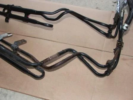

rockclmbr said:Jester,
How did you get that so clean?? Did you sandblast the entire pan?? Looks nice, and excellent repair!
Well, when the 80 went down and I knew I had some major repairs to do, I invested in a 40 gallon parts washer. A 3:1 mixture of water and concentrated Simple Green went into the tank. The oil pan spent about 4 days in there with a hot water rinse and scrub each night. I did glass bead the area where the weld was made, but the pan mostly came clean in the degreaser. I've spent a lot of time rinsing the pan with air and water to be sure I got all the abrasive out. A very thin coat of "Alumiblast" (a quick drying paint with aluminum in it) was applied to keep it looking good. Ironically, it was not until the Alumiblast went on that I noticed the crack as the paint was sucked into it - kind of like a poor mans magnaflux for non ferrus parts.
