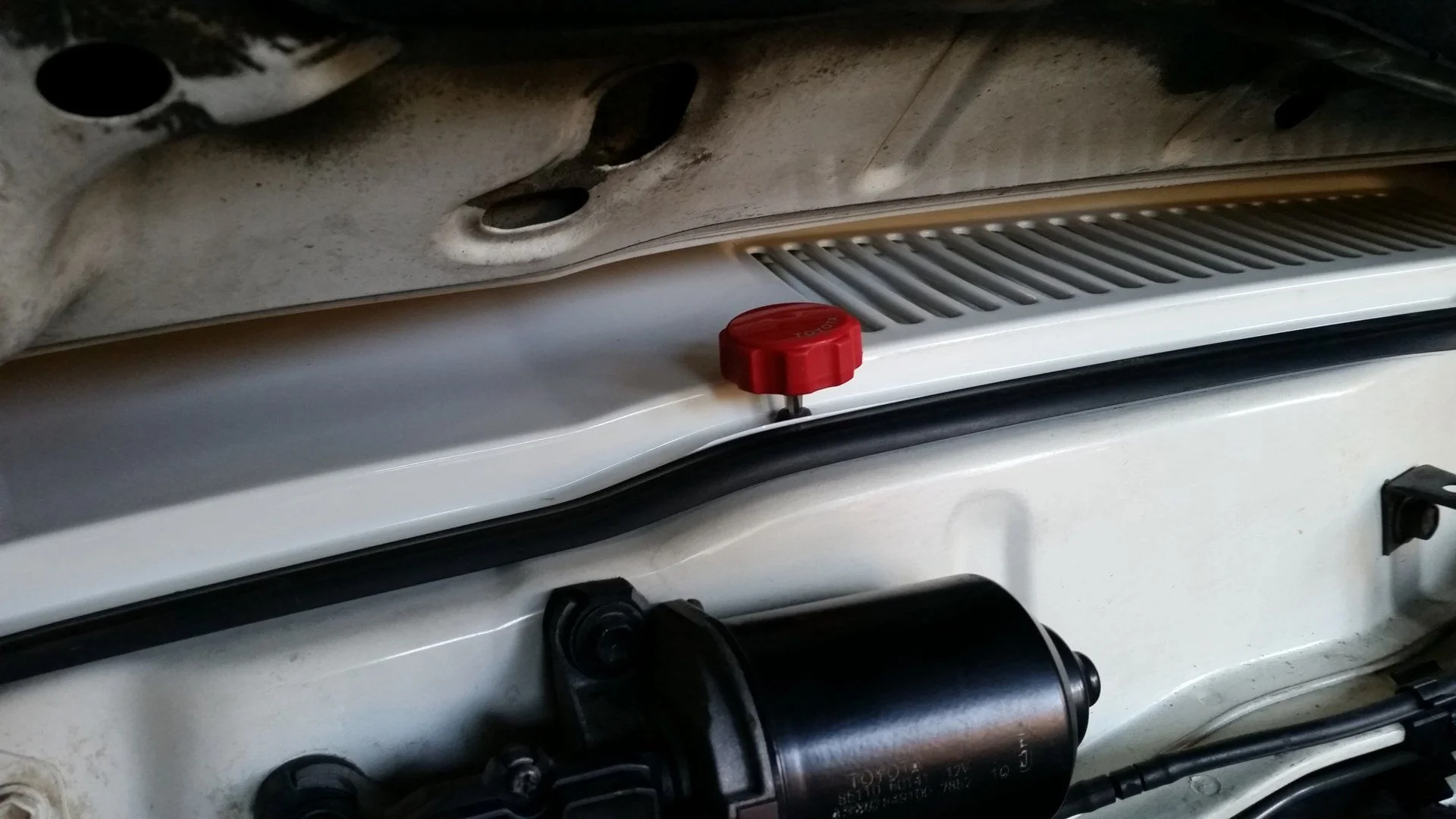

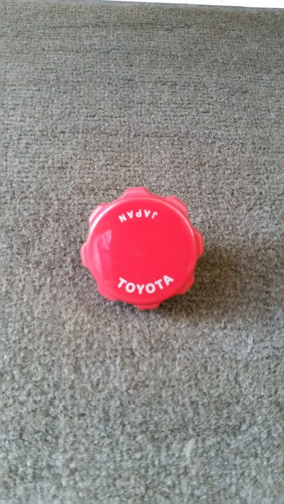

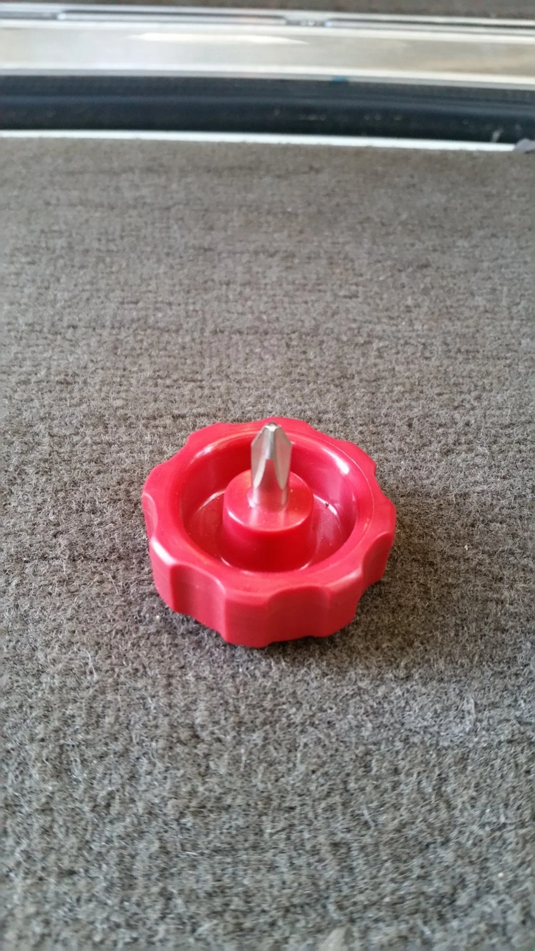

This is the ticket:

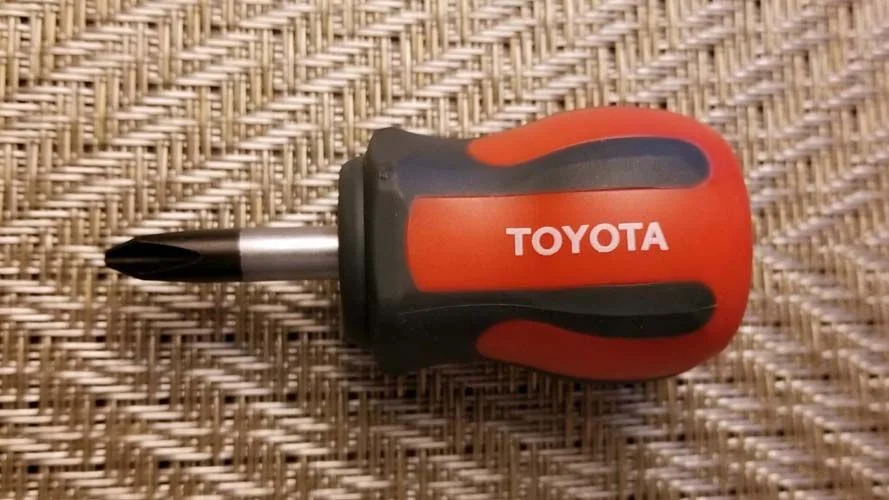

These JIS screwdrivers fit so well, they almost turn the screws by themselves!
Seriously, when I opened the box and saw this screwdriver, I knew exactly what it was designed for. I really hate single use tools, but this one is worth its weight. It takes five minutes to remove the panel, and no skinned knuckles or scratched paint.

Malleus, thanks for the info on that JIS small screwdriver.
Do you have a part number for it?

Yes, part number for the little driver.
Unfortnately, I have no idea. It was a gift.
I think I can fix this obvious oversight :hmm:
So your gunna buy a couple of gross of those stubby Phillips screwdrivers at Harbor Freight, ingrave them with the W E logo, and powder coat them PINK? :worms:
Oooor I’m gonna finally do something with the couple hundred JIS Vessel #1,2&3 bits I’ve had sitting on my shelf and then press them into an aluminum knob handle that was anodized and THEN laser etch the Wits’ End logo onto :flipoff2:
