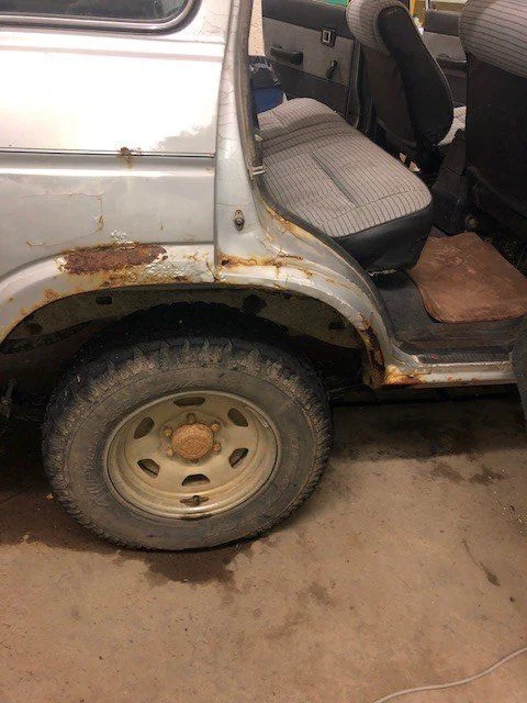

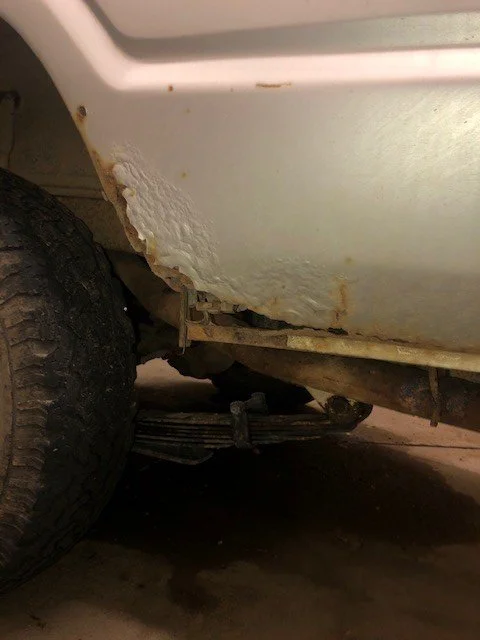

As you wish..... It's got some good rust and damage on the right side wheel well and rockers, plus some on the driver rear quarter panel. It needs work but I got the time, Covid -19 is helping with that. The frame and cab mounts are all good. I'm practicing sheet metal welding as of right now. I don't have the right size Mig wire at the moment and not to happy with flux core .030. I ordered some .025 solid with the right gas combo. I bet I improve to a better standard soon.

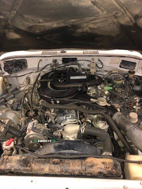

Looks like everything is intact, on the engine. HAC is there, (High Altitude Compensator), but you may want to rebuild and re-jet the carb for that altitude, particularly with modern gas, and more so if you're planning on desmogging the engine.... At that altitude, carb will tend to run rich.
