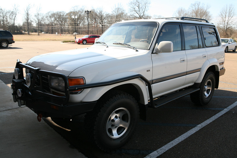

key measurements;
-how far up the ARB brush guard does fender bar start.
-measurement of each bend from the ARB brush guard
-how far is bar from fender and does the distance change throughout length of bar. if it does what is the difference in measurement and where does this take place along the bar.
-length of entire piece. ( from ARB brush guard to slider)
just a few measurements
Too late for tonight and I have to get to a party after work tomorrow so here are the measurements.
Up ARB...it is 1/2 way up the side bar. Split turn lens in 1/2. 7 3/4"
The closest the bar is to the fender is 1/4" at one spot.
The first bend is 2 dimensional, it goes out contouring the body and then turns parallel the body then follows the fender and down.
It is 70" total.
18" on the fist section, 21" on the second section, 10" on next and 19" on the down part.

That sure is a Purdy 80, is that your DD
Can you believe that my truck once looked like that...well, even more bone stock...
Nolen's gonna sell me that one when the time comes... Eventually, I'm going to keep an 80 or 40 to scoot around town in...

Marks 80 Fender bars being prepped & JRob & mark
Wild west arms for marks 80
Mark's 80 is the cat's meow.
the water bladder and hot water shower is the shizzle. Hot Dam!
supercharger, dual battery, drawer system, ARB fridge, ARB lockers and he is going to add an auxilliary tank and wild west LCA. damn
