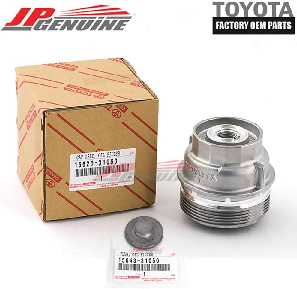

Seen this on another forum....anyone replace the plastic housing with this metal one ?
Yes......Lexus/Toyota 4.6L.......Amazon $21
Yes - but you already know that 'cause you saw it on another forum.
The oil filter PN changes as Toyota obsoletes one PN and replaces with another. I think A5 is the latest in the progression.
The metal one has a tendency to seep/leak at the drain plug.
Why would you want to swap them out? The plastic one actually transfers heat better and if you buy the socket service is easy.
ive seen the metal ones leak at the drain cap, but its usually after about 120k with out changing the o-ring or never even removing the cap. metal would be my first choice as ive broken more plastic ones because some idiot decided that the filter housing was the best thing to try that new 4 ft breaker bar on because we all know that its not the o-ring that seals it its how tight you can crank it on
I do my own services/ oil changes so no worries about over tightening and with the proper socket it doesn't get chewed up either.

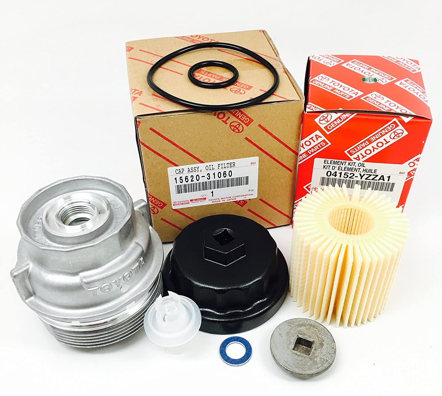

Amazon also offers a Toyota kit....includes wrench...
new metal housing....filter....gaskets etc....$58
I also do my own oil changes...just need correct P/N to ensure fit
even to have for a spare......this one ?

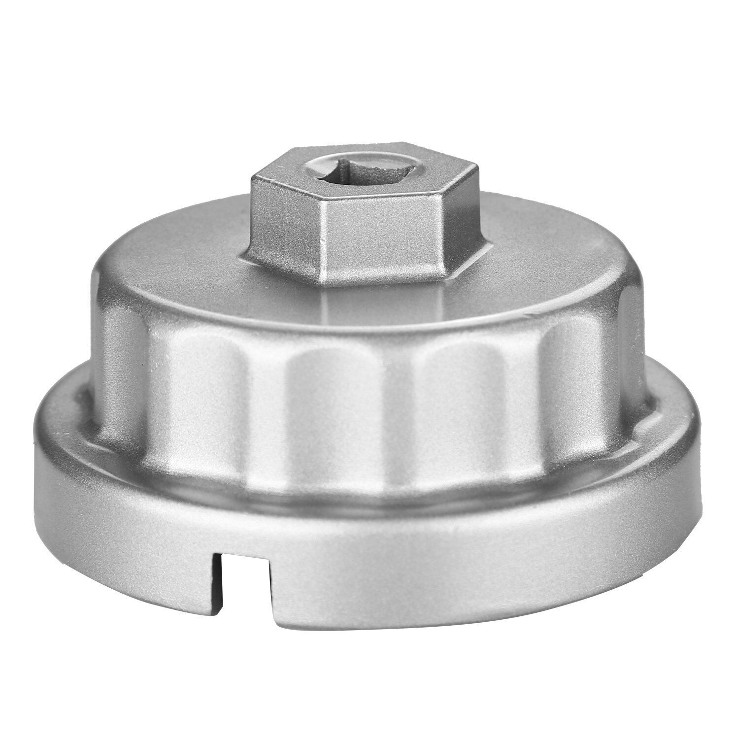

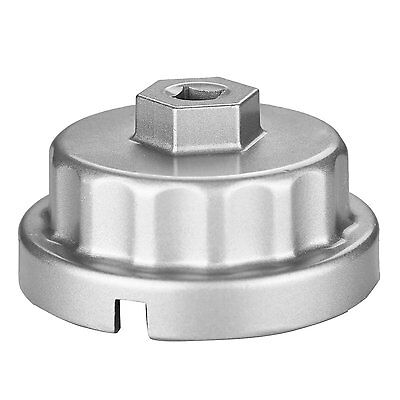

I've used this same metal oil filter removal tool with my metal cap for years.
Heck! Now that I know the dimensions I can print one on my 3D printer! :hmm:
Just have to make it robust enough to not break when torquing.
I can even do custom colors like Princess Pink, Hop-Scotch Yellow or even Martha Stewart green! :p (not...)

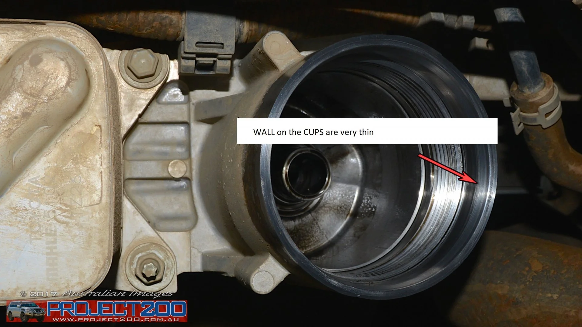

the reason why we use hard plastic inserts instead of aluminum is that the aluminum cup wall is very thin, so plastic under heat will not expend as much as aluminum, that aluminum insert is not for 5.7 motors you need plastic or you can crack the actual cup when its expended and that be a problem.
These metal cap retrofits have been going on for over a decade. i can‘t remember coming across any incidents on other forums about these cracking.

On a 460 if one wants to go with model not using the end-cap this one used on a large number of Lexus passenger sedans up through 2015 reportedly works.
PN: 15620-31040
This info wasn't easily found when I swapped mine in 2017 so I have the model with the removable end-cap which doesn't help on a horizontally mounted filter.
I've seen more than a few videos on Youtube of 460 oil changes and watch owner put o-ring on the wrong spot on oil filter cap. I never repost those anywhere as to not spread bad info.
PSA from the CCN, make sure you use the correct oil filter housing! Also, another reason to do your own oil changes.......
I first put on the OEM retrofit version nearly a decade back but then cutover to the OEM one that doesn't require a retrofit nor has the unneeded end plug.
PN: 15620-31040
PN: 15620-31040
@Acrad are you sure PN: 15620-31040 is correct? When you look up compatible vehicles on lexus part stores, it doesn't list the GX and states that this housing is for V6 engine variants. The only GX filter housing I could find was the OEM plastic version, i.e. PN#1565038050. I'm still running the retrofit version, i.e. 15620-31040 plus plug 15643-31050, although the CCN video has me concerned about whether the toyota dealer that originally changed my filter housing (disaster story and why I only change the oil myself from then on) installed the correct length of inner perforated tube, or whether the housing is the correct geometry for the GX (e.g. correct valve spring size and length)
I know it won't show compatible but it works.. I've been running it for 3 years now and added it to most of the forum parts lists here and on CL.
I think the biggest con is it is more expensive that one you would retrofit.
IIRC... learned from a Lexus mechanic on GXOR who had told me it works.
