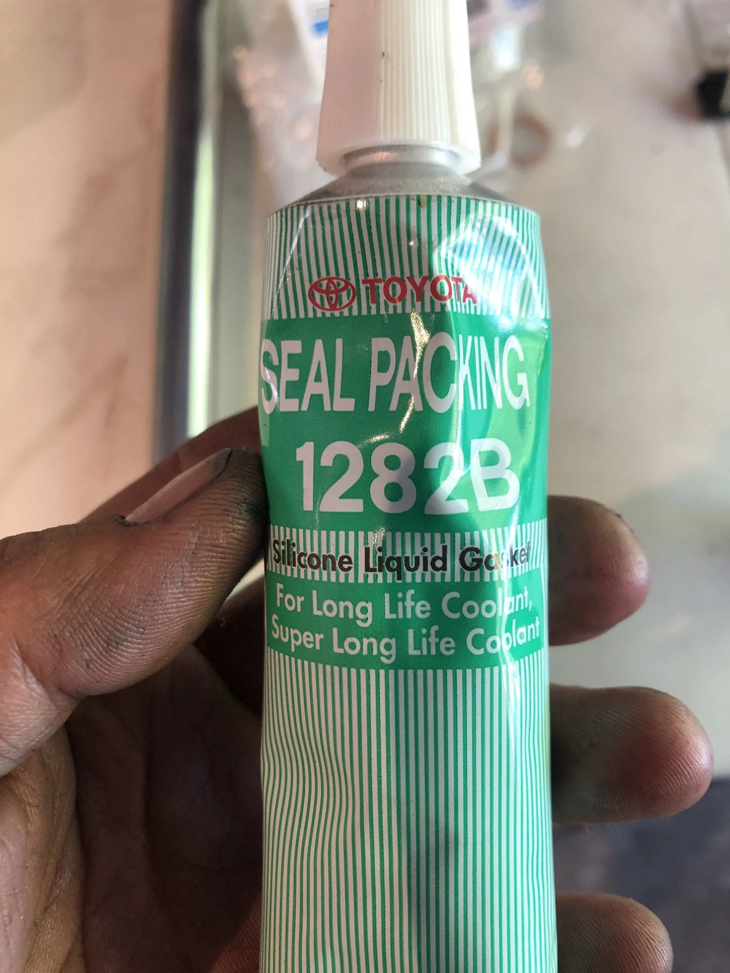

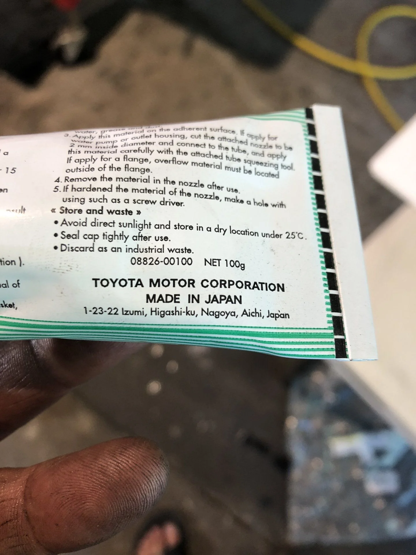

Getting the parts together for water pump/timing belt replacement - I still need the 'Toyota OEM Seal Packing 1282b 08826-00100' for the water pump, correct?
1282B is correct type for engines that use the SLLC2 (pink) coolant.
Gray silicone also works very well.

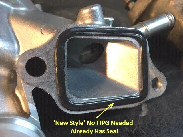

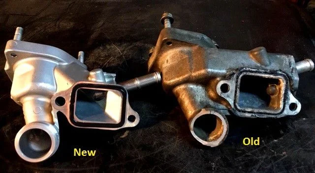

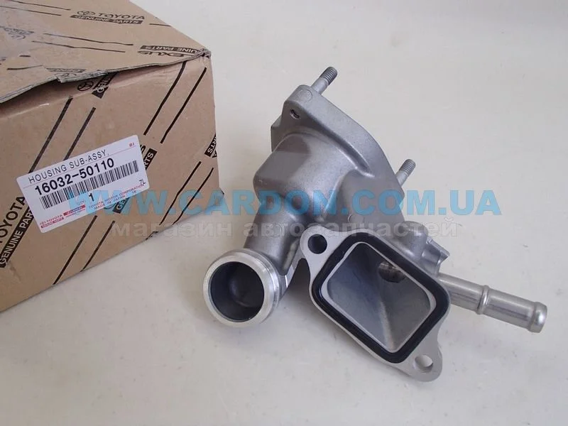

I bought the correct sealant for mine BUT since my water inlet snapped off :( .....I didn't have to use the sealant because the new style inlet comes with the seal already in place.
