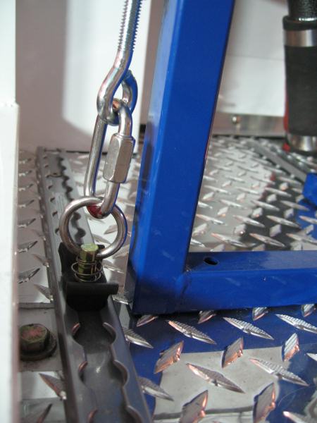

The problem with the Core-Trax system is that they currently only offer loop tie down points on their movable clips for their track system. Perfect for tie downs, not so perfect for anything else.

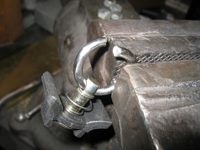

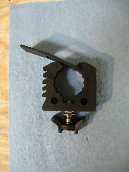

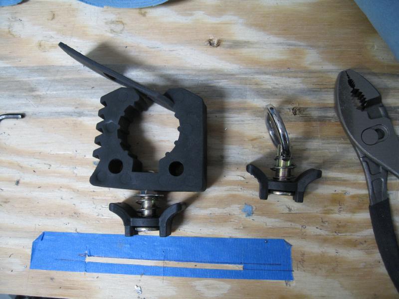

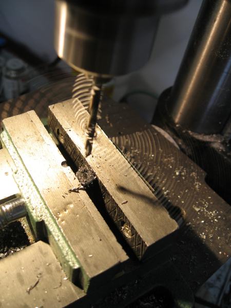

1. Cut the Core-Trax clip ring

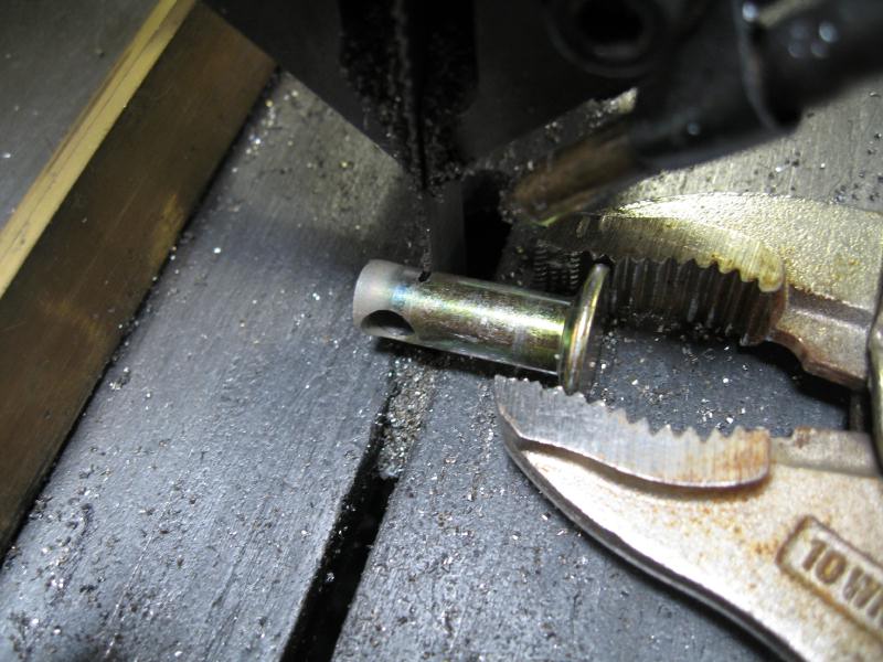

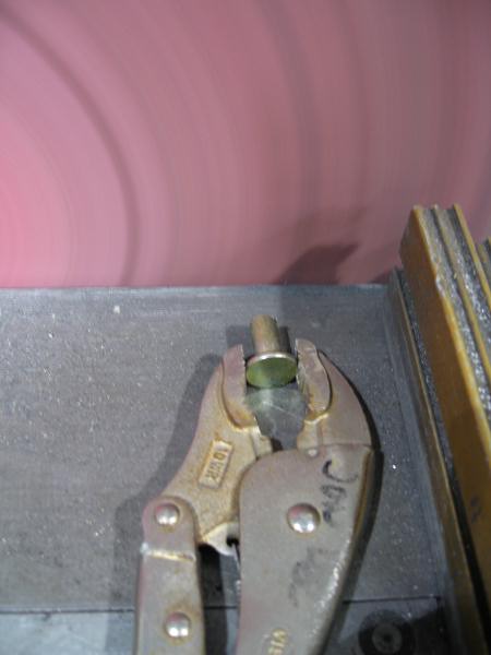

2. Saw off the end of the clip ring post. Band saw is used here, hacksaw & vise work fine.
3. Deburr the cut. Disc sander is used here, hand file & vise work fine.

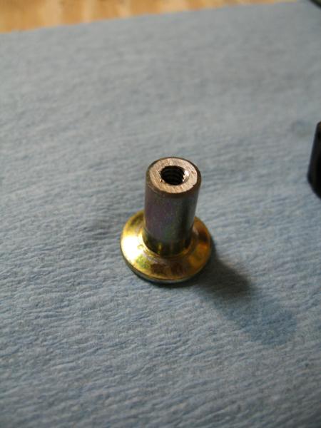

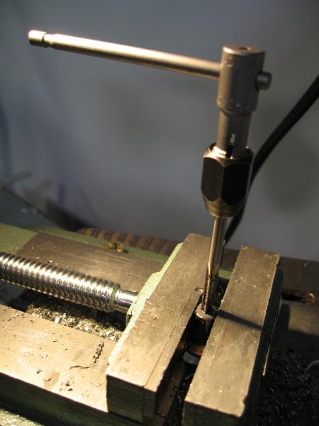

4. Drill out the end of the clip ring post. You will want a drill press for this step.
5. Tap the hole, in this case for a 10-24 bolt.

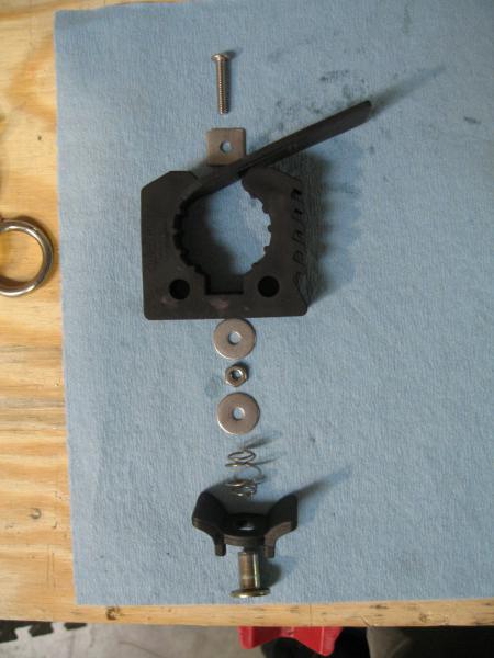

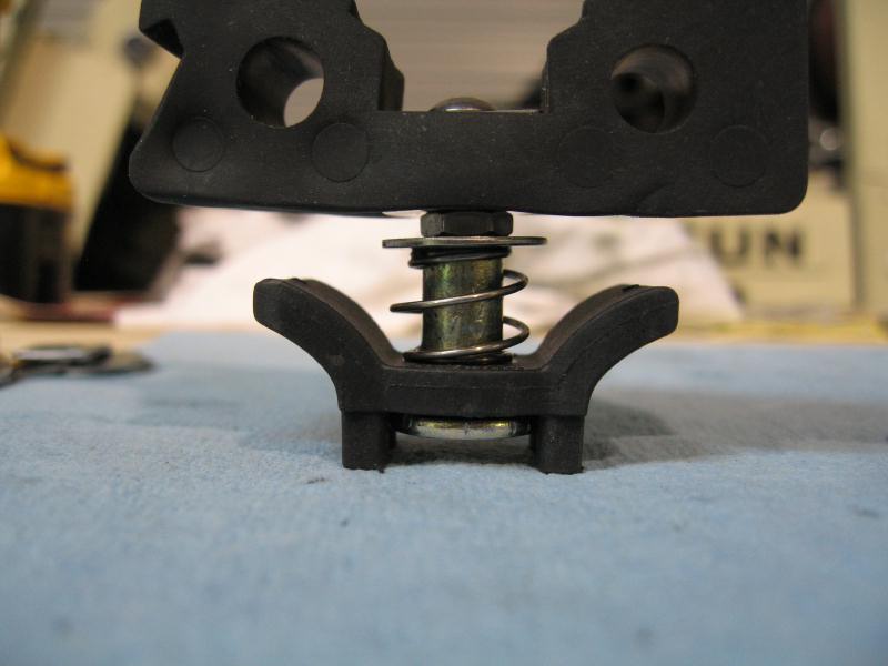

6. Layout and assemble the parts. Use stainless steel hardware.
Top to bottom:
  • Stainless steel (SS) 10-24 button head cap screw
  • #10 SS washer
  • Quick Fist Clamp
  • #10 SS fender washer
  • #10 SS nut
  • Core-Trax clip spring
  • Core-Trax clip
  • Core-Trax locking pin

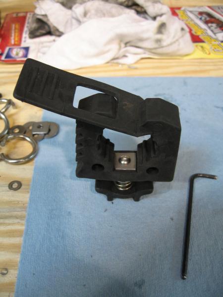

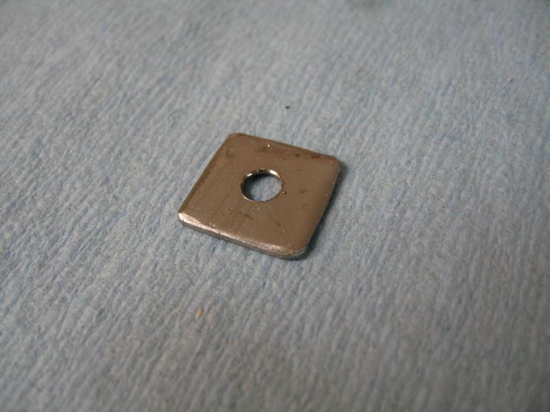

If you have access to some stainless steel and a punch/die, then punch out and drill some #16 SS squares for the top of the clamp. Otherwise, the SS washers work OK. 2nd best to the square washer is to file the edges off of a fender washer to fit.

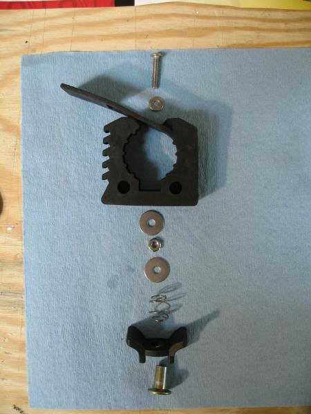

Components using #16 SS square washer for clamp.
Top to bottom:
  • #16 SS square washer
  • Quick Fist Clamp
  • #10 SS nut
  • Core-Trax clip

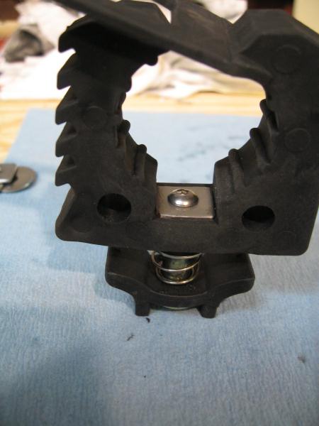

Assembled clamp using a SS washer:
Assembled clamp using a square washer:

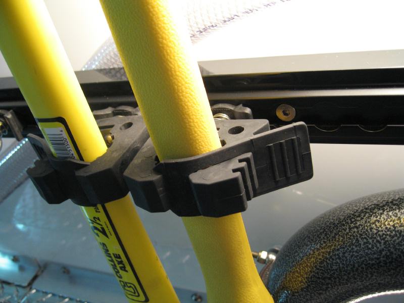

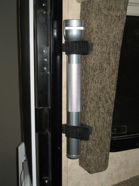

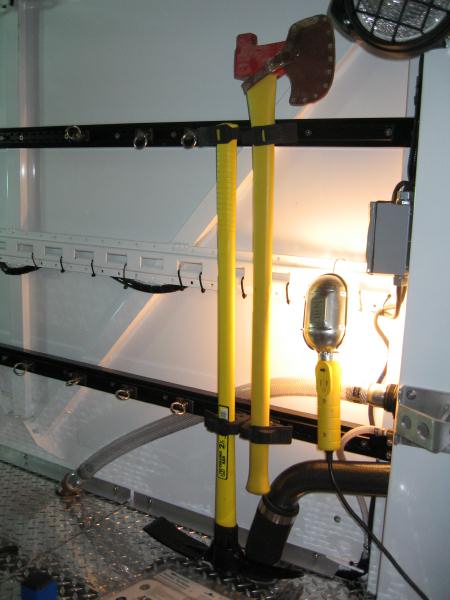

7. Attach the clip to the mounted Core-Trax and insert your desired item.
