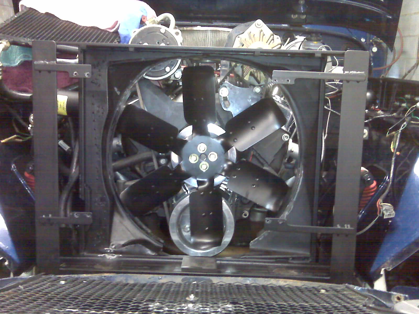

Ok, guys, I got the flowcooler water pump and 17" rigid fan installed this weekend. While I had it torn apart I extended the fan shroud so the fan is completely inside the shroud. Previously I had set it up with about 1/2 to 3/4 of the fan in the shroud and it did not work properly. With the new fan, shroud extended, and the new water pump, I now have the cooling under control. It will still climb after sitting in traffic on a very hot day ( mid 90s) for 20 minutes or so, but all I have to do is kick it up in neutral and rev it to 2200 rpm and the temp will fall. Its not perfect but at least I have control over it now. I really don't the the water pump did much and attribute the increase in cooling to a better fan and better shroud. After I was happy with that I decided to work on the rear end roar and found out the rear end needs another rebuild....... Grrrrrrrrrr.

Nice work. How did you quantify the increased airflow by the longer shroud? I have always heard, read and done 1/2 in 1/2 out as being optimal. Jim Sickles will quote SAE study this and lawsuit that to say the fan should be completely outside the shroud.

I haven't thought about over driving the water pump but that may be an option. I hoped that flowing more water with the flowcooler would be sufficient. I will be adding a idle speed solenoid very soon which may help some. The information you cited is why I cut the shroud down last weekend thinking it would improve the airflow. After cutting it down so that is was 1/2 and 1/2 I noticed immediately that the airflow was greatly reduced even though the shroud was sealed better. I added what I removed back and then a little more and the suction of air in front is dramatically better. I mean probably 100% better. I don't have any scientific way to measure this but by holding a piece of paper in front of the bib the difference was astounding. I am in no way disputing what others have said as optimal, but in my situation the fan inside the shroud worked better. :confused:
