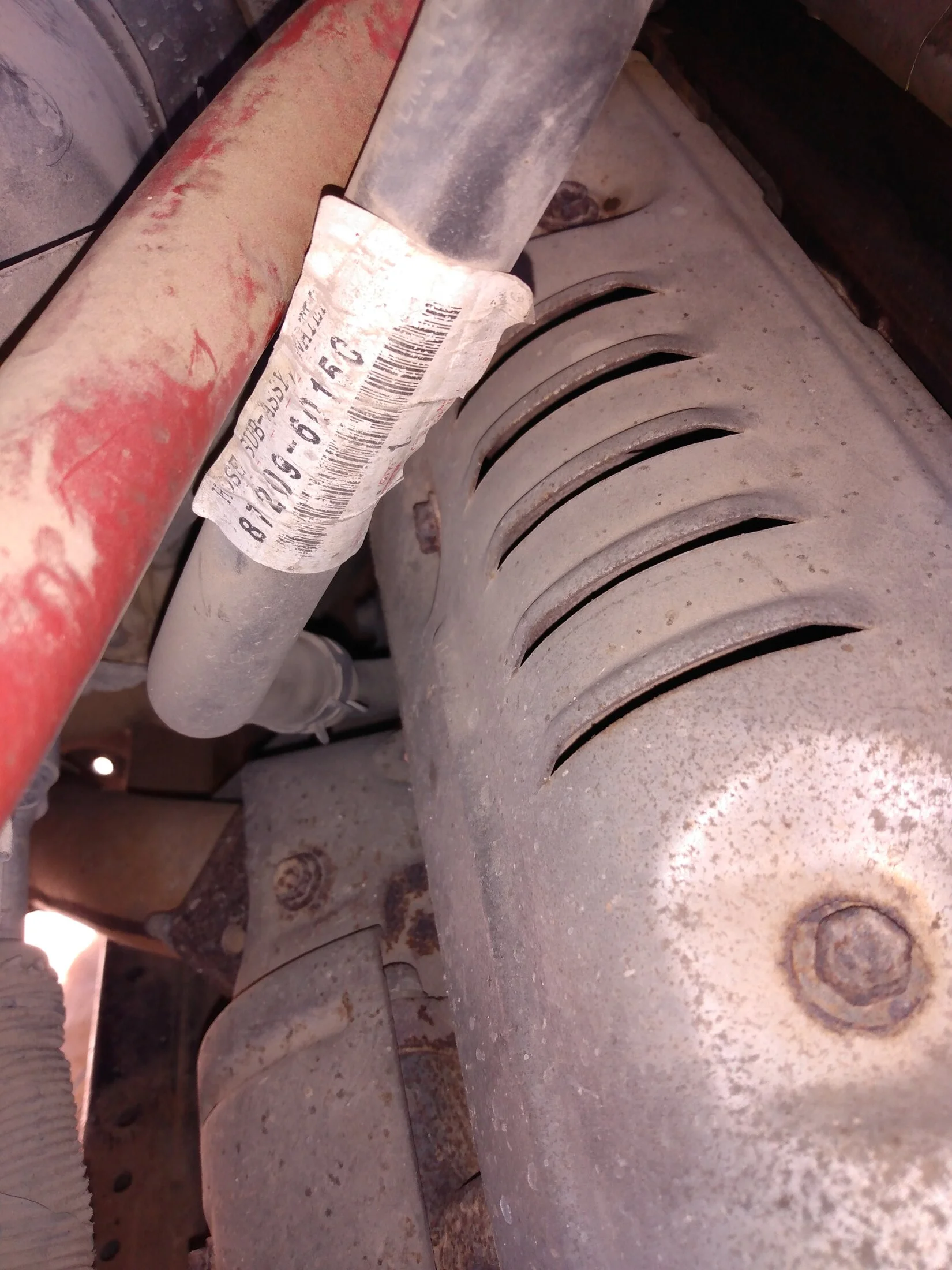

Hi @duece71 I never did update this thread. First pic in this post shows the part numbers - I found them both through Japan4x4:

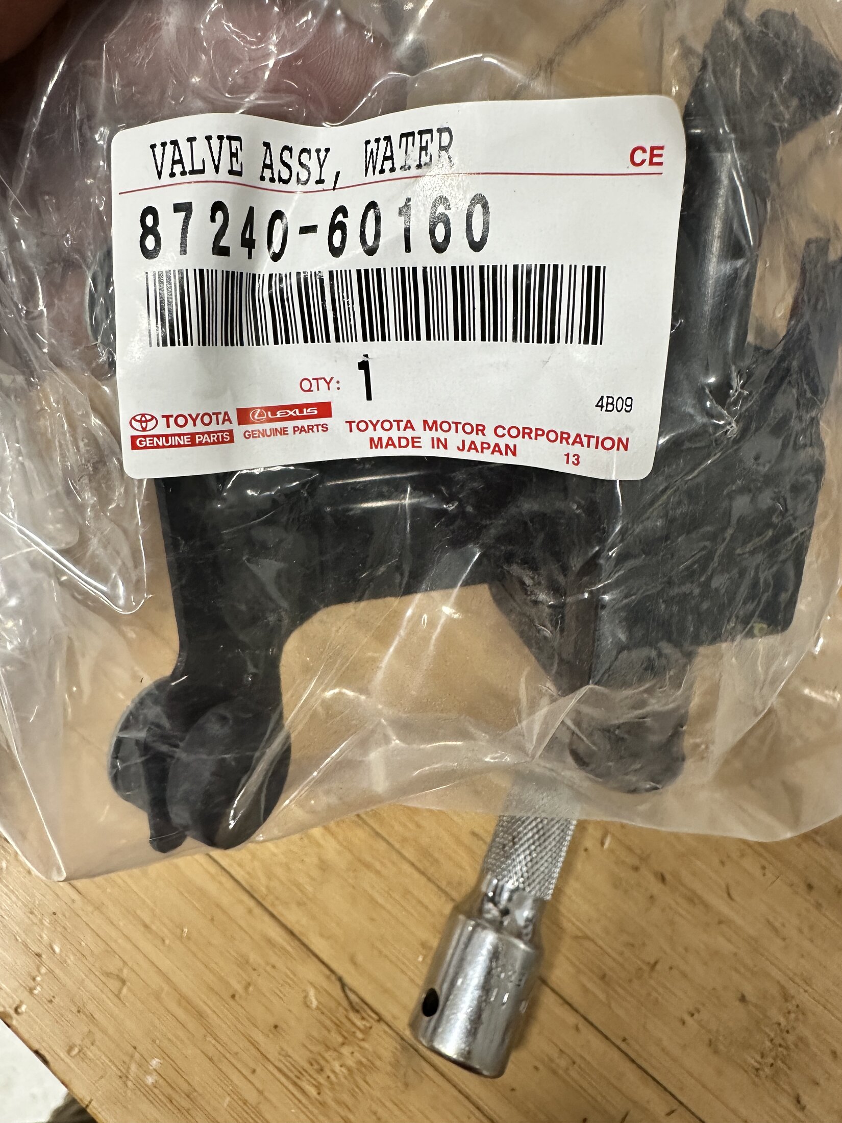

I recommend replacing the heater valve as well, if you can find one new:
Not the correct part for the early HDJ81 that @duece71 has - the valve for early trucks is NLA and out of stock everywhere and has been for some time.
There are aftermarket options and some other part numbers that work - HDJ81 Heater Control Valve - https://forum.ih8mud.com/threads/hdj81-heater-control-valve.827718/
I used part no 8724060140 on my 1990 Hdj81. I really wanted an Aisin/toyota made valve as the aftermarket quality kind of irks me a little bit when it comes to stuff like this. I just moved the control arm from my old valve to the new one, and screwed the new valve down on the original valve bracket and it’s worked like a charm ever since

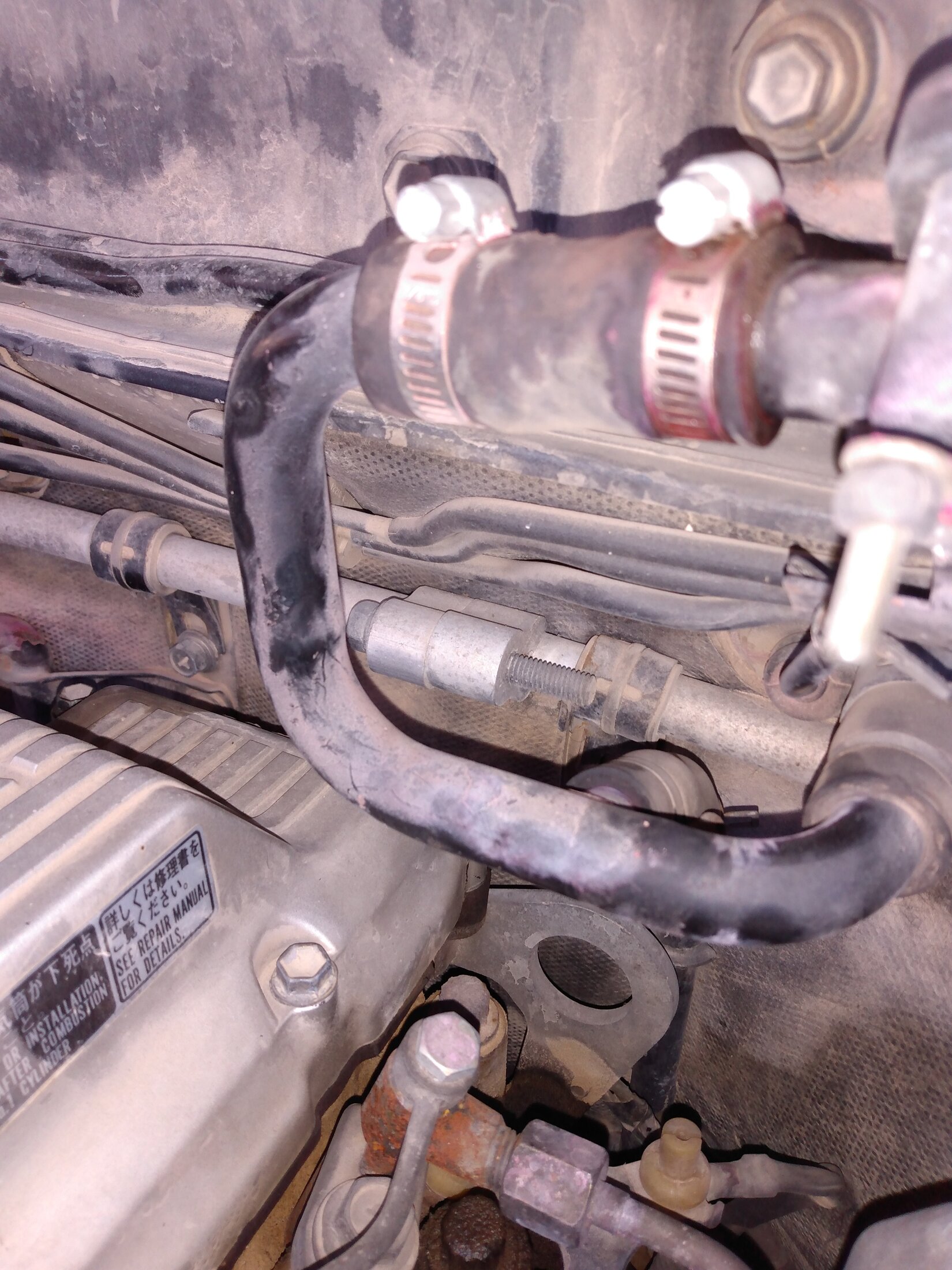

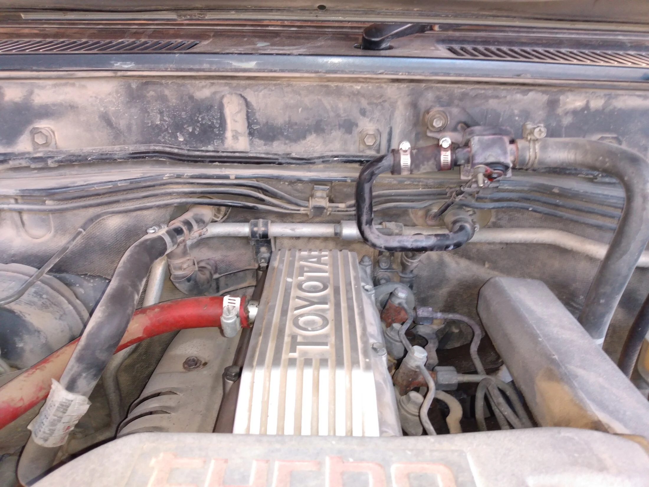

Hi @ikarus, I noticed that you have a 97 HDJ81 w/1HDFT and you were kind enough to share how you bypassed the rear heater. Thank you! To that end, I have a 1991 HDJ81 with the 1HDT (I'm guessing they have very similar coolant hose routing when it comes to the rear heater/firewall interface and coolant hose routing). Anyway, my rear heater hardlines are leaking and I am wanting to bypass the rear heater entirely by using Toyota OEM coolant hoses and clamps. Below are several photos of my HDJ81's 1HDT engine bay where the rear heater connects with the rest of the coolant piping. In your post you provided the OEM coolant hose part #'s (see the following):
1) 87245-60420
2) 87245-60620
I am having trouble determining if those hoses will allow me to remove the metal "Tee" sections both on the inlet and outlet side of things. In other words, that the hoses you listed in your original post will connect to the firewall connection, or whether they will simply connect to the existing metal "tees" I have. I would like to get rid of unnecessary connections if possible (aka get rid of the metal "tees"), but only if it makes sense.
1991 HDJ81 1HDT showing engine bay where rear heater inlet/outlet come through the firewall.
Inlet for rear heater.
Outlet for rear heater.
Looking at the Partsouq parts diagram makes it appear as if the 87245-60620 will just connect right back up to the metal "tee" and will not change anything. However, 87245-60420 will get rid of the long, bent metal "Tee" for the inlet side of things (aka just after the outlet from the heater valve). Can you, or anyone else, provide any guidance on this? I also know I will need to get some sort of cap to cap the inlet/outlet of the rear heater where it comes up by the firewall.

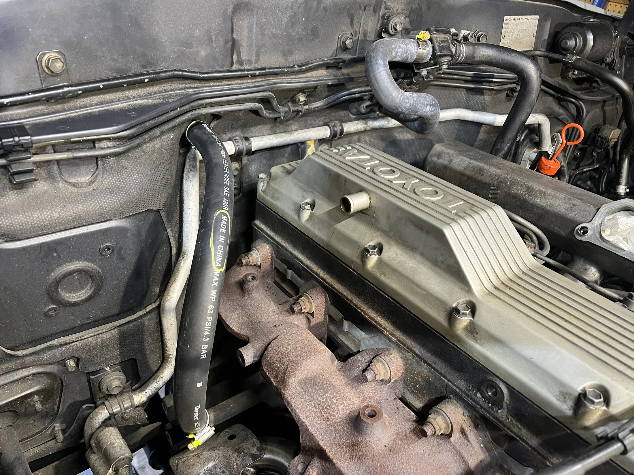

Do these pics help? this is after I got it all buttoned up. No tees
I ended up using
which is an assembly and I just removed the T section, and it reached the firewall fine.
Got both from Dave @ Japan 4x4

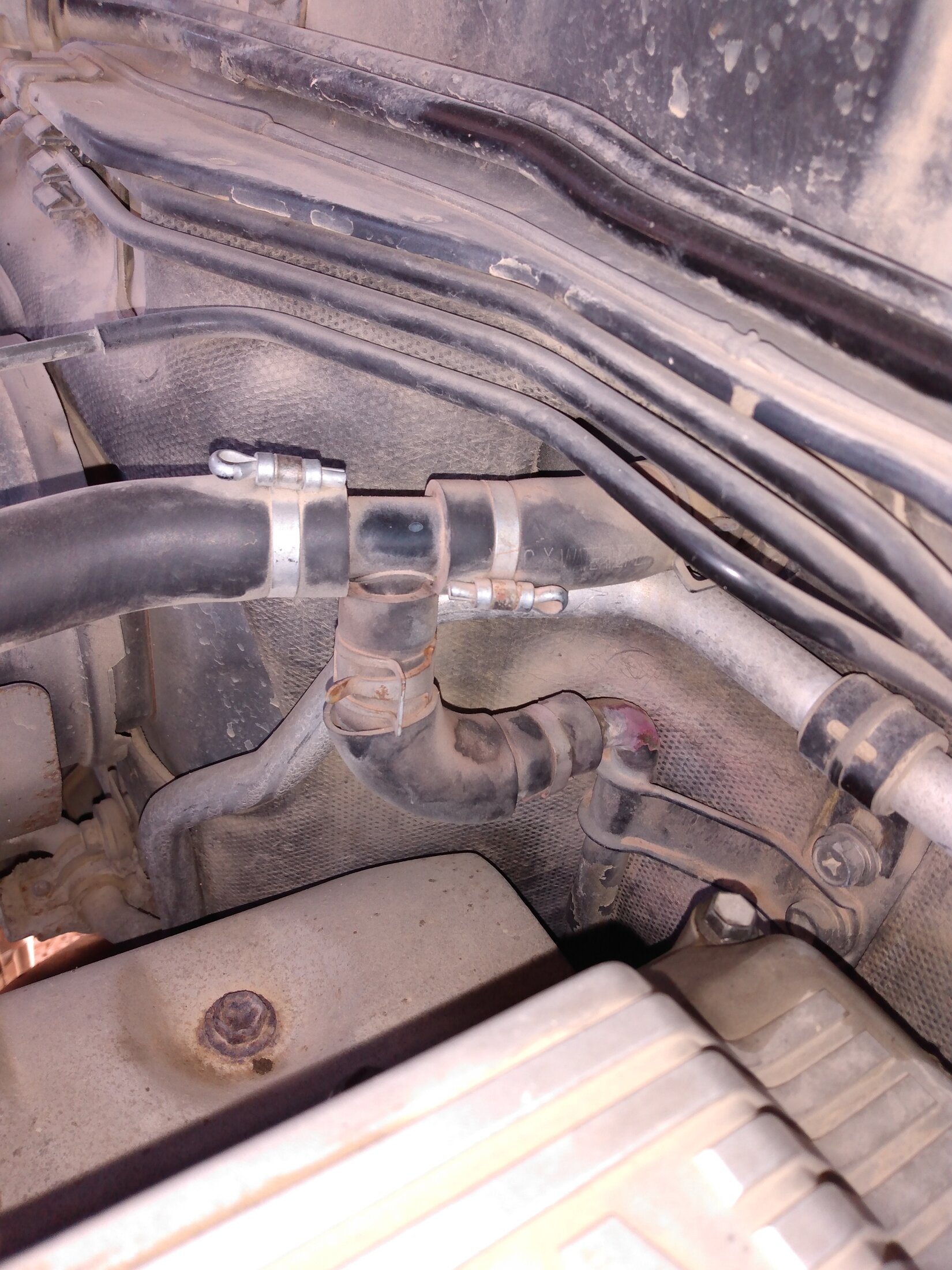

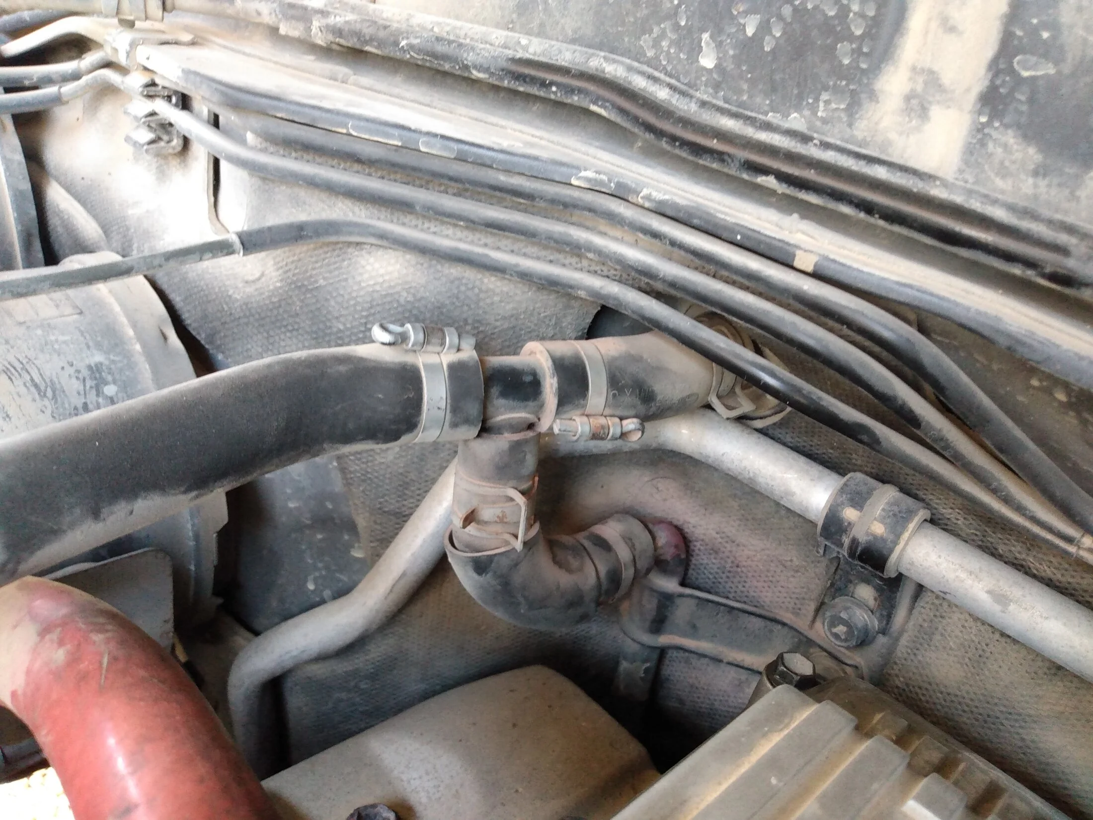

Thank you @ikarus and @duece71, I really appreciate it. I have ordered the 87245-60420 (same as the LCP delete kit, just not Gates) that goes from the outlet of the heater valve down into the inlet of the main cab heater, as well as some clamps to go with it. The part I am not sure about is outlet side of things where @ikarus has the 87209-60360 specified (but has removed the "tee" and associated stubby portion). It feels like my hose comes from a different location on the engine and that the 87209-60360 wouldn't necessarily work. I have attached a couple photos of this as it is currently set up from the factory.
Also, what did you all use to cap off the rear heater connections near the firewall (inlet and outlet for the rear heater that is found on the firewall)? I would like to cap them off so that they are protected from debris/damage should I ever want to reconnect the system (if I can fix it). Thanks!!
