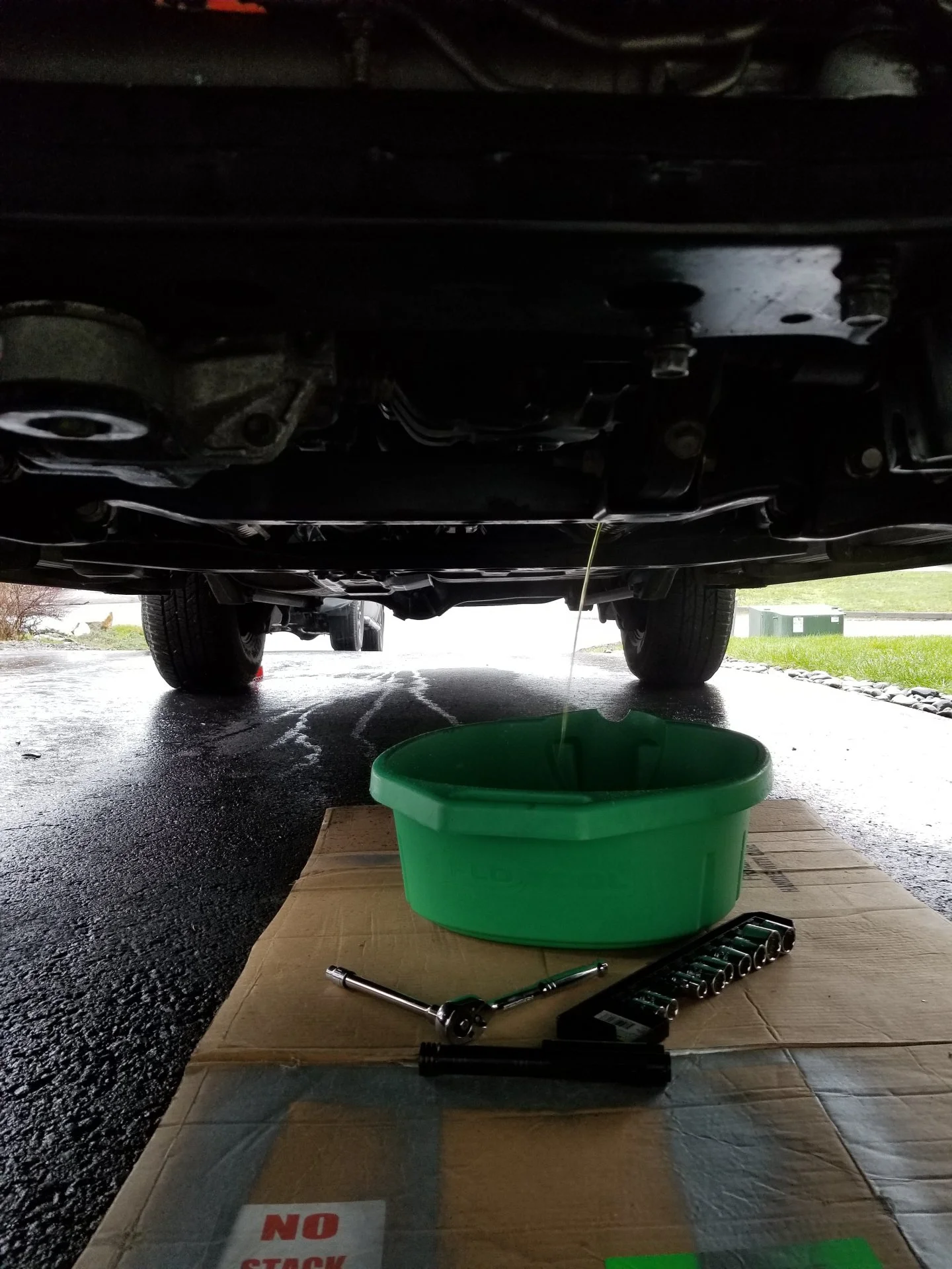

Well, there was about 2 gallons of coolant in that radiator! Read several threads here and drained almost 2 gallons out of my radiator petcock. Uview folks told me that I should be able to vacuum draw coolant/antifreeze from the engine block without directly draining from the two engine block drains. That did not work.
Pretty certain I also have to crack open and drain from those two engine block drains. Right?

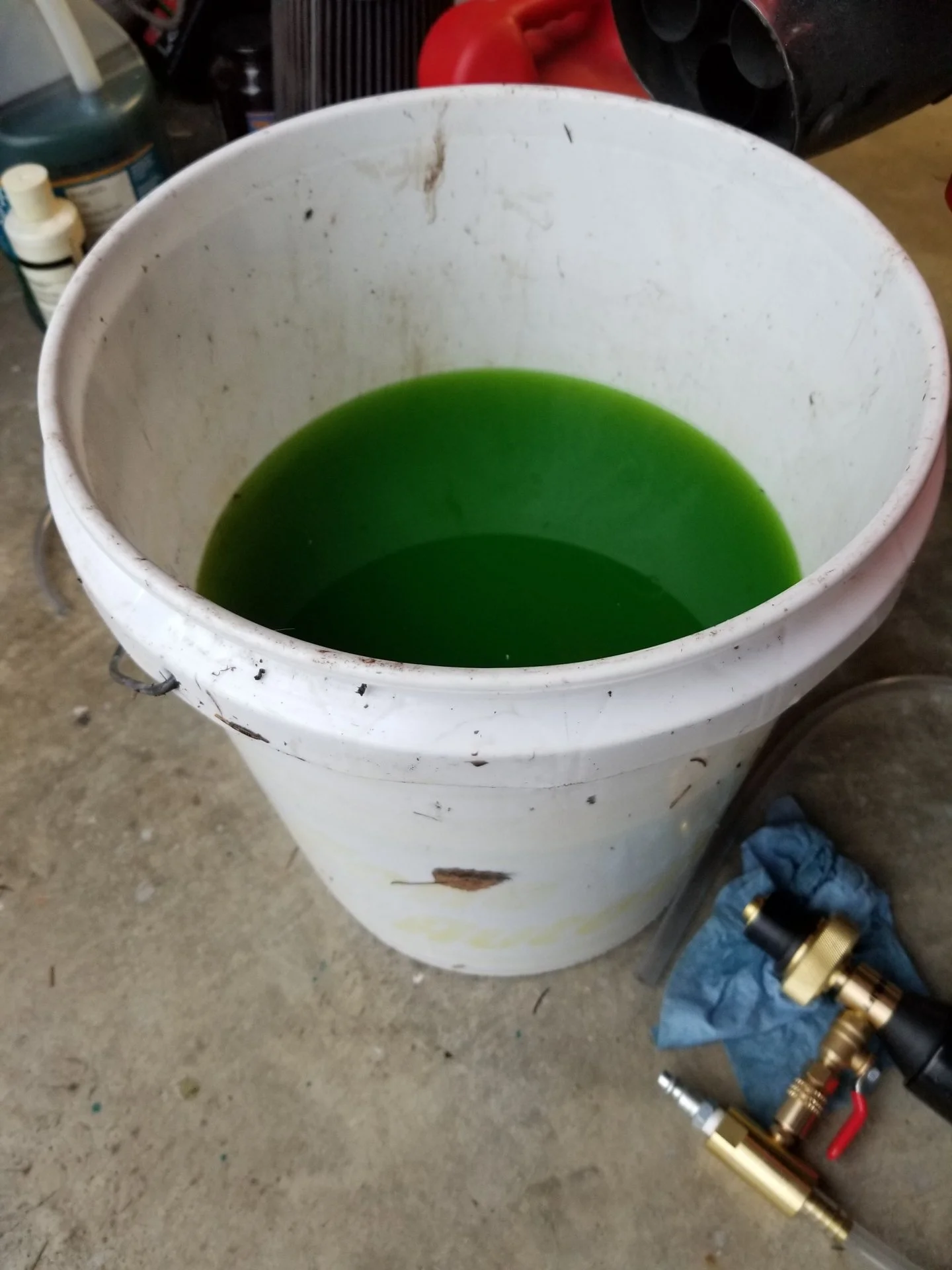

I opened up those two engine drain blocks and drained another 1.5 gallons from those plugs
  • Now, I have 3.7+ gallons of green antifreeze from this engine

Yes, i use the same system on my 2002. First of all the coolant is not able to be sucked out by the vacuum. It drains out by gravity. And yes, you MUST drain from the block petcocks as well as from the radiator.
