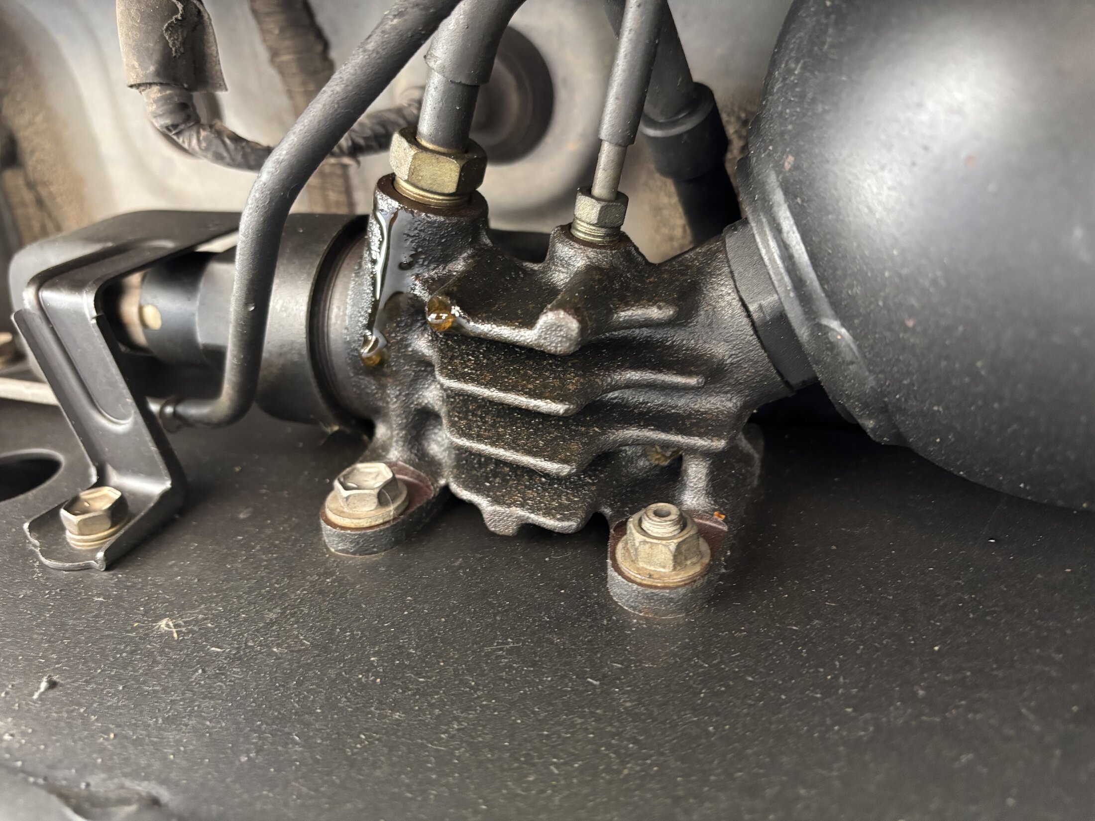

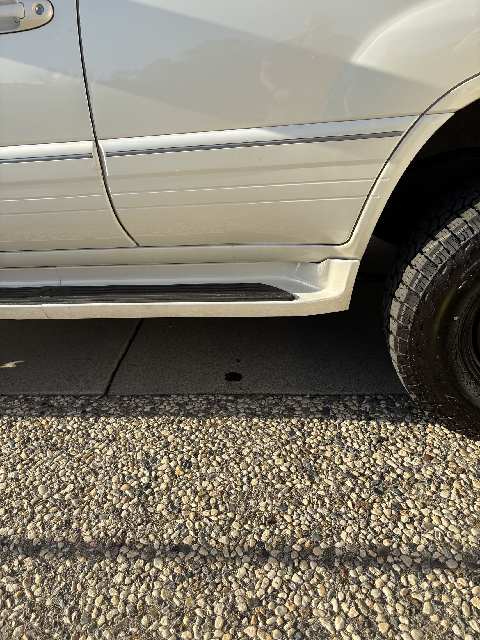

I have a similar leak on the driver side. The PHH seems intact and can’t find any dried coolant. It was dripping behind the step by rear driver side door. Any recommendations appreciated.
What year and model truck to you have, that doesn't look like anything I have see on my 80 series, is that part of the AHC on a 100?
That’s hydronic fluid. Looks like the line might be loose. Tighten that nut and wipe off area. Then recheck after you drive for a bit and see if that fixed it
Sorry 100 series. Didn’t realize was in the 80 series threads
