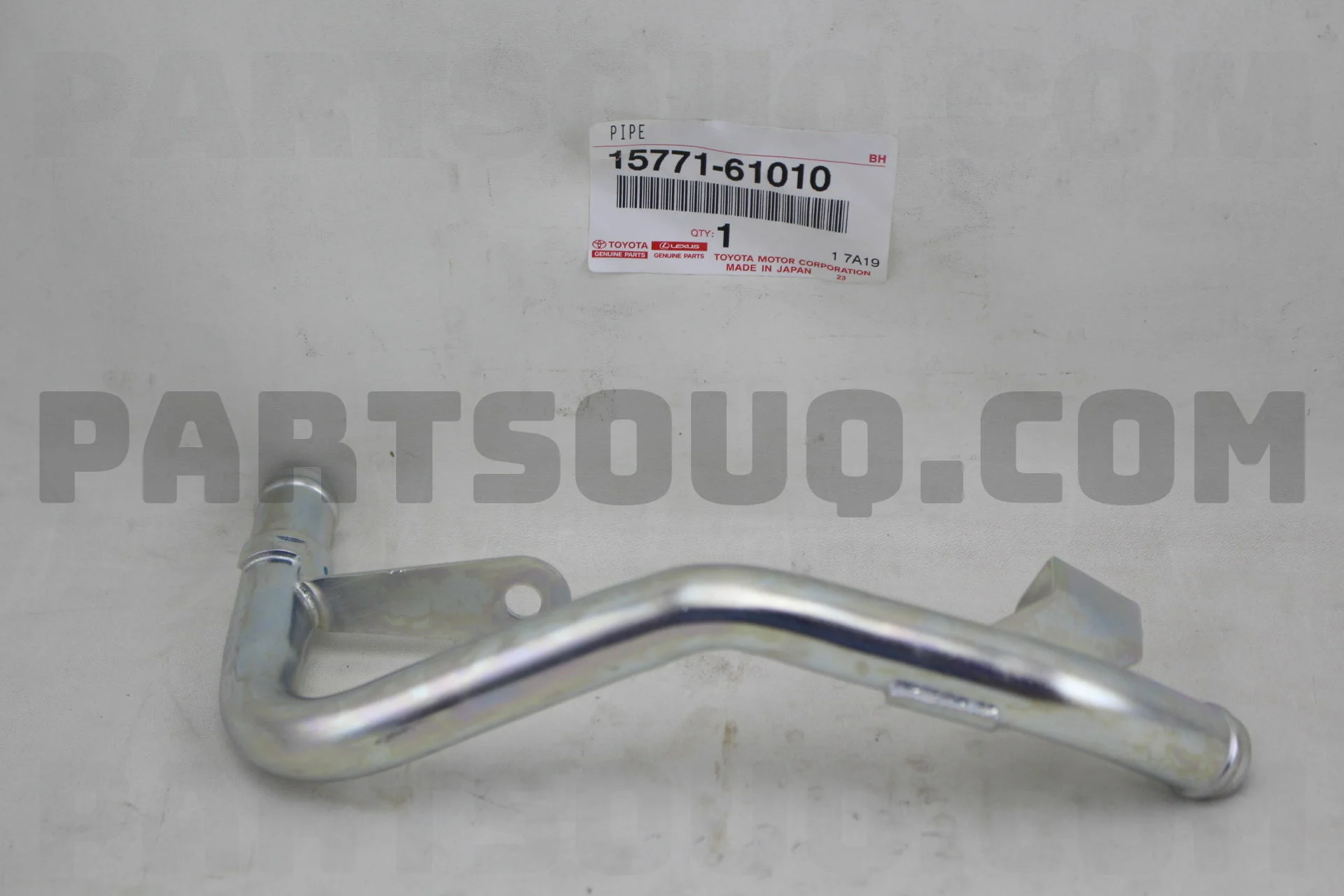

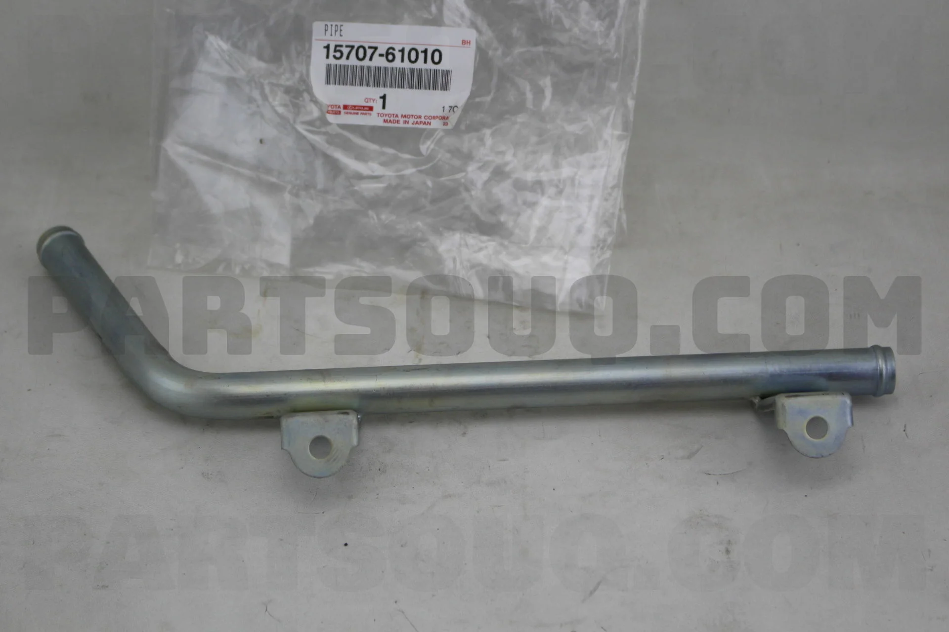

Some hard lines are still available. 15777B upper and lower oil cooler pipes are available from Toyota

@g-man I saw those, but of course those are in the best shape of my current pipes. Go figure.

@Spike Strip - thanks! I should have been more clear in my original post. The oil cooler lines are still in serviceable shape, it's the rest that are toast. Tho I'll still probably replace those for good measure.
