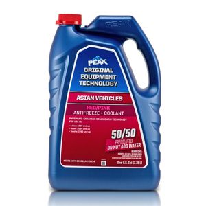

I used this when I replaced the radiator in my GX, I expect to use the same whenever I face the inevitable on the LC. $20/gal pre-diluted from Autozone. ¯\_(ツ)_/¯
